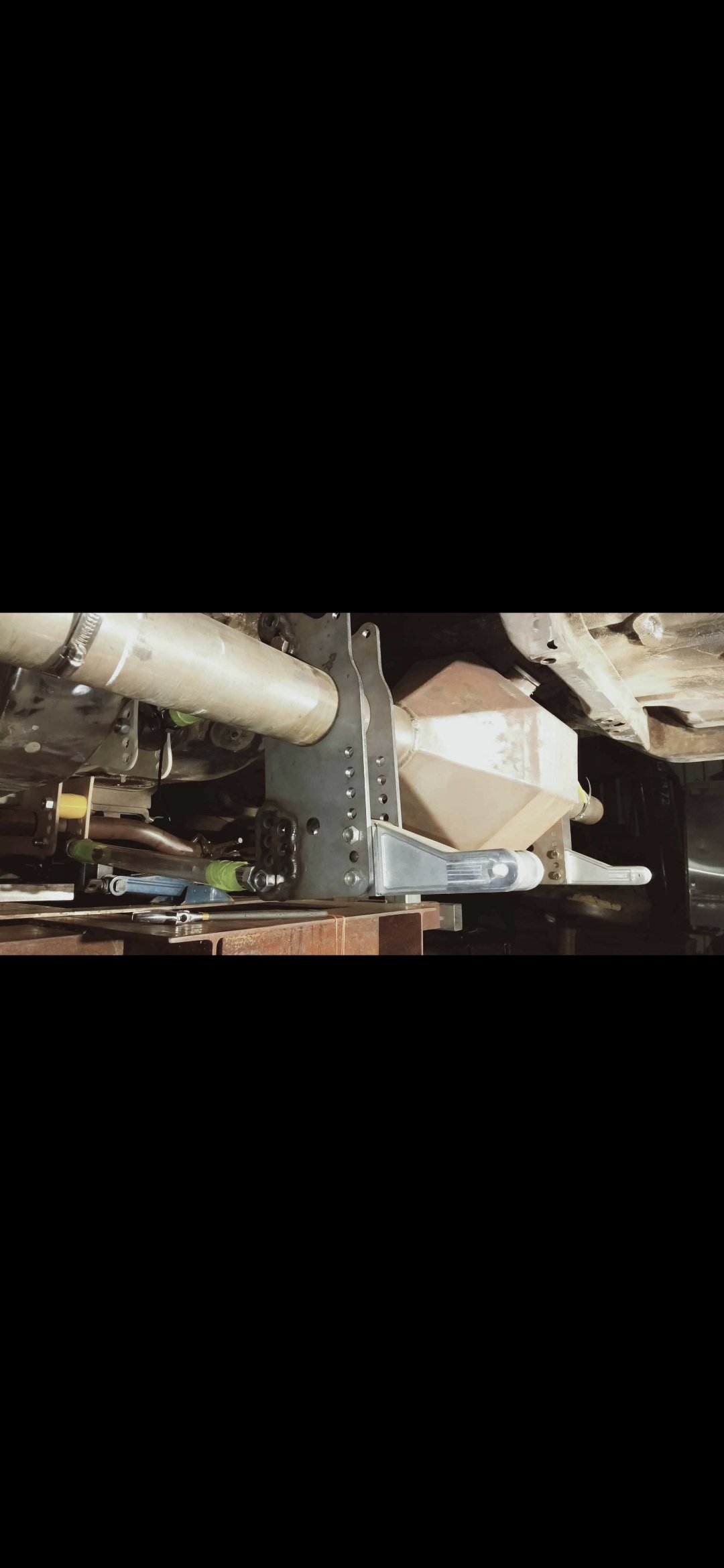

Currently building the ass end full 4 link floater rear end with a 2 speed

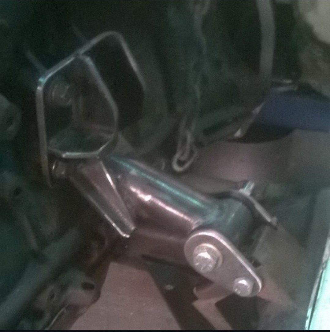

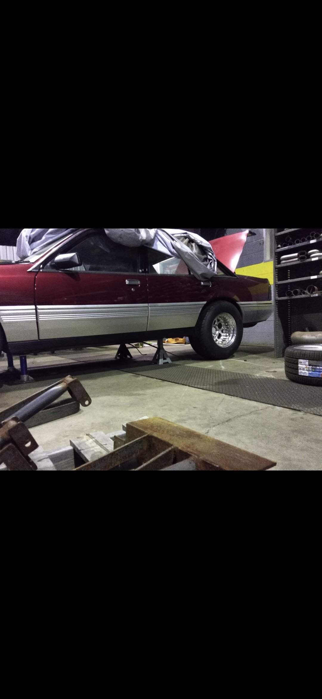

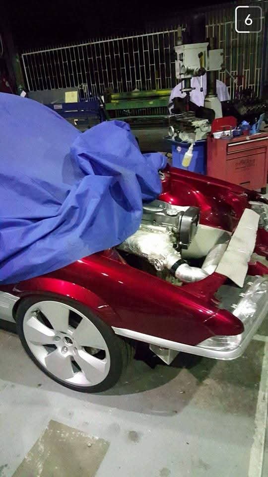

Here's some photos. Blew the oil pump in the gtr and decided to rip the motor out at the time and do a full build only to find it had been a repairable write off so went down this path.
