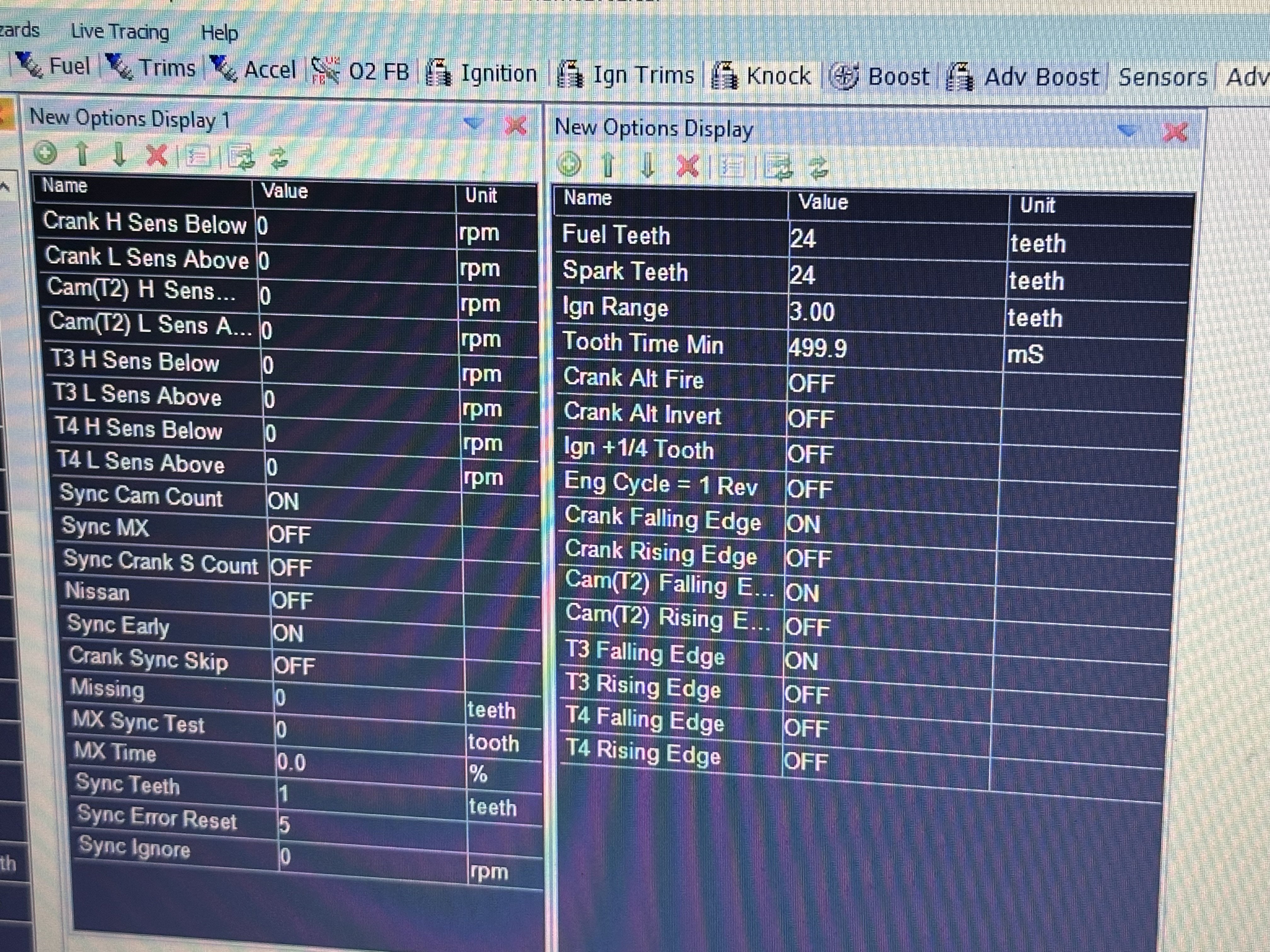

Hello , im new here and i have A31 home build
RB25det neo stock eng / turbo
aem ems 2 blue connector
aem 3.5 map
aem cas disk
aem wideband connected to ecu
355 lph pump
550 nismo yellow injectors side feed
aftermarket regulator
and won’t start with base aem tuner basic tune
eventually flipped cas 180 degree so it triggers on correct stroke not in exhaust cycle
Now it won’t start
Wideband reads 10 and 11 at lowest fuel setting
and will share calibrations soon for aem tuner i think something is wrong in aem tuner
please if you have any information, am very grateful

Your best and only option is to verify your CAS is reading properly with an oscilloscope (I'm presuming the V2's had a built in one) and then properly sync your ignition and mechanical timing using your offset angle within the ecu. I don't understand why you flipped your CAS.
I'm going to assume they flipped it, as the timing setup in the AEM is catastrophically wrong.
Once it is fixed, they'll likely need to swap it back to normal.
