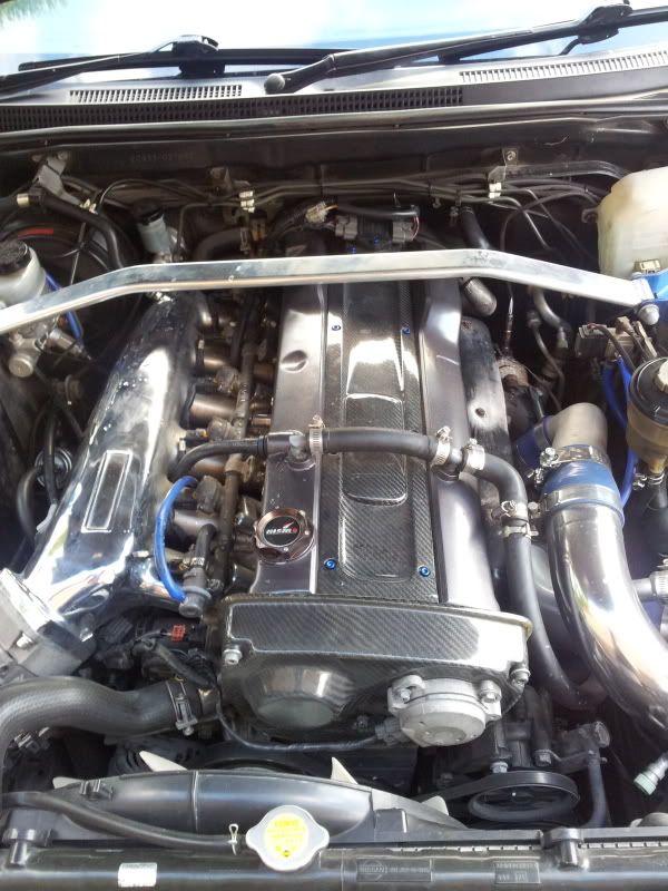

Thought id post some pics of my plenum.
Used a genuine Greddy plenum and Q45 throttle body had zero problem fitting after looking through this thread. I didnt flip the injectors or fpr (i think it looks neater), also ran the coolent lines through the throttle body.
3rd pic shows where i mounted the stock bov and 4th shows how i plumbed it back
Performance wise bit of a drop in the mid range, but made an extra 4kw more :cheers:
Great job man very neat!
How did you go about changing both the cam cover breather barbs to the single outlet 90 degree ? do they just push out?
I changed mine around so it looked a bit neater using the stock fittings and the stock position plumbed into the intake pipe. I pulled the T fitting that points straight up and out as well out and used a bench grinder to shave it down enough so that it would fit into the cam cover, neatened it up before I put it in but thats basically what I did
heres what it looks like:
so where exactly does that line that comes out the side of the rocker cover go? Also, when I got my rocker covers ceramic coated I think the guys took out the o-ring or whatever it was that was in there... is there anything else I can use to connect that line with the one way valve?
The line that comes out of the intake side of the rocker cover is the PCV (Positive Crankcase Ventilation) valve. If you just have an empty hole there, then they have removed the whole thing and you will need to find another one. They are pretty small and basic but the setup wont work unless you have a working PCV valve in there
It goes to one of the nipples on the intake manifold (i got a bigger nipple with mine which is the right size for the hose needed to go PCV -> Manifold
yeah well I have still got the hose with the one way valve attached, but I think there was an o-ring or something in the hole before that held it in there. Maybe it broke when we were removing it? Anyone know where I can buy a new one?
