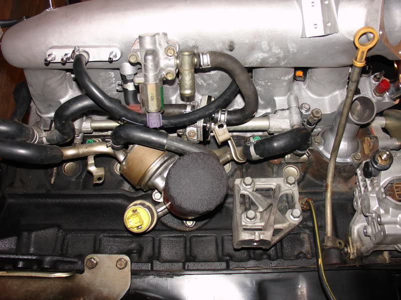

has anyone any other options/links for this or a similar thread? Started my install ages ago and only getting back to it now And haven't a clue how it all went together
the link above for rb26.net doesn't work now either ?
Any help appreciated,
thanks.
Noone at all save the pictures from it? Even bits and pieces from when you did your own install?
To be more exact, the bottom pipe of the is iacv? Where does it go? IMG_4821.JPG.17576f43860de7d4bed2b7af66bec562.JPG
Which nipple does he extend the turbo water lines to in the guide? I have mine running off the pipe he blocks off beside the thermostat?
what 2 wires need extended?
What is the welded piece of galvanised tube for the aac that's mentioned about?
If anyone could help it'd be massively appreciated.
Surely someone was smarter than me and saved the thread for offline use....

For everyone playing at home, its actually pretty simple to do. When you have all the parts and are trying to put it all back toether it makes sense and can only really go together one way. Utilising your brain and the desciption that ix9 provided you can do it.
Bumping this 10 year old thread and asking the OP (who hasn't been online for over a year) for pictures that he has said he ne longer has is proooooobably not going to yield any results. Have you actually searched through this thread as i know for a fat they have been rehosted somewhere else online at least once or twice.
