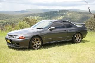

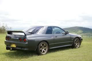

Fitted my Sil80 road rims/tyres to pass rego as the tyres on the Enkie's have bald inners due to shit alignment crap castor.
Here's a few pics
