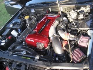

After a bit over 6 months it really is like driving the car for the first time. I only drove it maybe 6 times before the big end on number 1 had a sad. Yep, pulled the bottom end off the old girl this arvo for a look. in shorts, just number 1 big end had some meat taken out of it, well that sounds a bit dramtic, it had the indications of a little degredation of the bearing. The rest are fine. Crank is fine :) Old sump even has trap doors :thumbsup: - pity that's not on the new engine :(

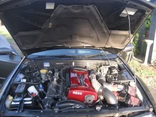

Anyway for all you doubters and others' that thought it's not possible to have the 3 litre in the engine bay without cutting stuff, here a few pics to show it can be done. :) I LOVE the fact it looks stock, other than the pods which will be enclosed soon enough.
Here's a long shot to show there's now photo trickery

hmm, the pics are a litte small, I'll make them larger as i know there'll be a few people wanting to figure out how it was done
Well for some reason it won't let me post larger pics?? I tried it on preview with the original &l larger but they all turn out the same?
oh well, you'll just have too look hard i guess :thumbsup:
Alright I'll start the ball rolling with the obvious question:
So! How did you get the motor to fit? I will gladly pay one carton of beer (of your choice) for this information in detail!

I will say that the cross member is intact, it was not cut and re-welded :D

u must have elongated the engine mount holes & dropped the engine?
I've previously said i'd modded the engine mounts to lower the car ~3mm clearance from the cross member Marko :cool:
That alone won't make the twin turbo pipe clear as you guys already know :cool:

Ahhh. So you cut and re-welded the sump to make more room?? And then drilled the engine mounts to lower it?
From the pics it also looks like you've lowered the twin-turbo pipe perhaps..

Now you're starting to think....but no.
Sump is standard depth, much bigger though, 8 litres :(

You didn't lower the motor at all! You raised the bonnet!! ....and the guards....! .......and er, the doors - which would then lead around the boot - so you must have raised that too I suspect... yesssssss.... that's it I think.....
