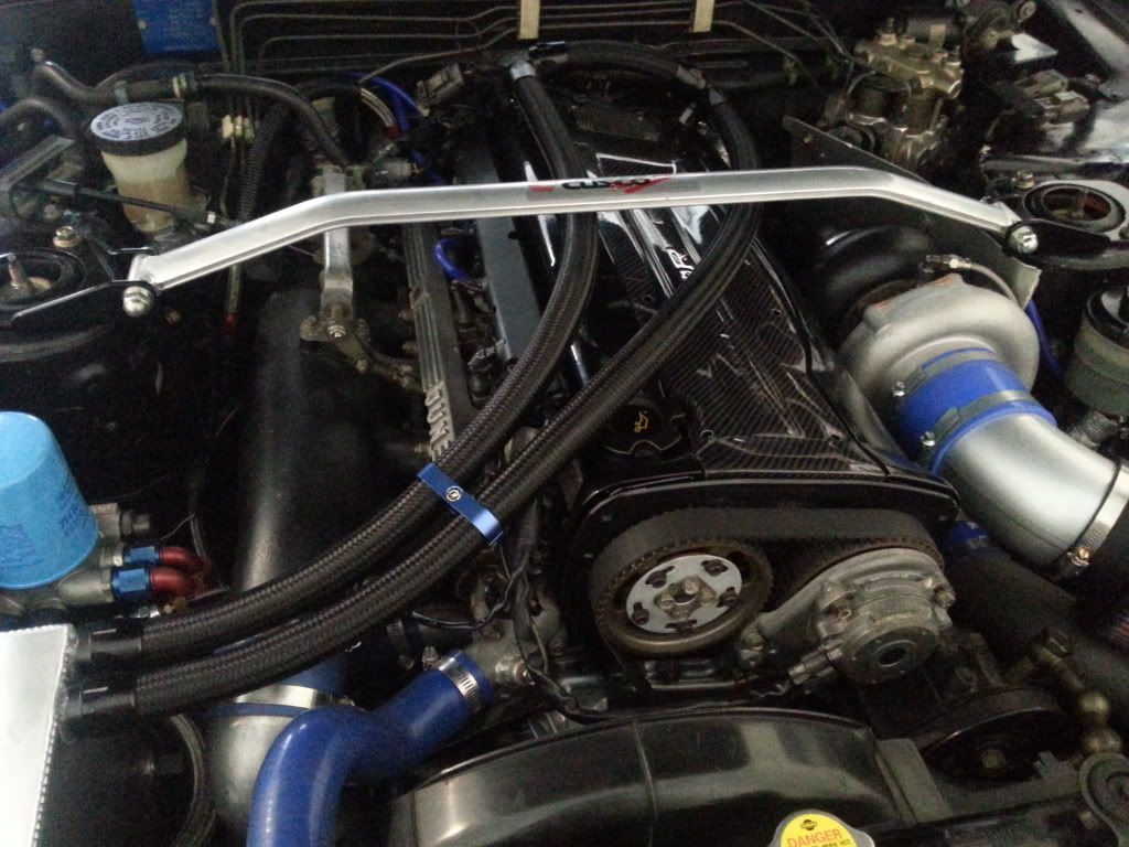

Ok Ladies and Gents, I went out to the track with my new catch can set up and it works mint... My standard RB26 managed to spit about 2L of oil (which all got caught in the catch can) over 5 sessions at Barbagallo. So the catch can worked great, but my oil level went from the hump of the dipstick to low during the night, it's not really optimal to have to try and remove the catch can, drain it and then put it back in the motor during events so I'm looking for a solution.
My catch can has a -10 drain on the bottom designed to be returned to the sump but foolishly we didn't weld on a fitting on the sump when the motor was out. At the moment it's just blanked off but considering how much oil was in the catch can and how "clean" it was I'm really keen to return to the sump. So my options as I see it are;
  1. Run a -10 line from the catch can around the back of the block above the bell housing and to the rear turbo oil drain with an inline one way valve. The advantage is the rear oil drain is currently blanked and not doing anything and technically it's on the "right" side of the motor so should drain under most conditions as the crank will be creating vacuum and pulling in the oil. The issue is it's going to be a very long line and gravity may take a while to drain over that distance.
  2. Run a -10 line to above the oil of the drivers side of the sump. The problem being I'm not keen in removing the motor (so would have to be very careful drilling and tapping the sump for the fitting while the motor was in the car)
Comments/suggestions etc are welcome? Most keen to go option 1 as it's going to be a fairly easy fix, just wondering if everyone thinks it should work ok.

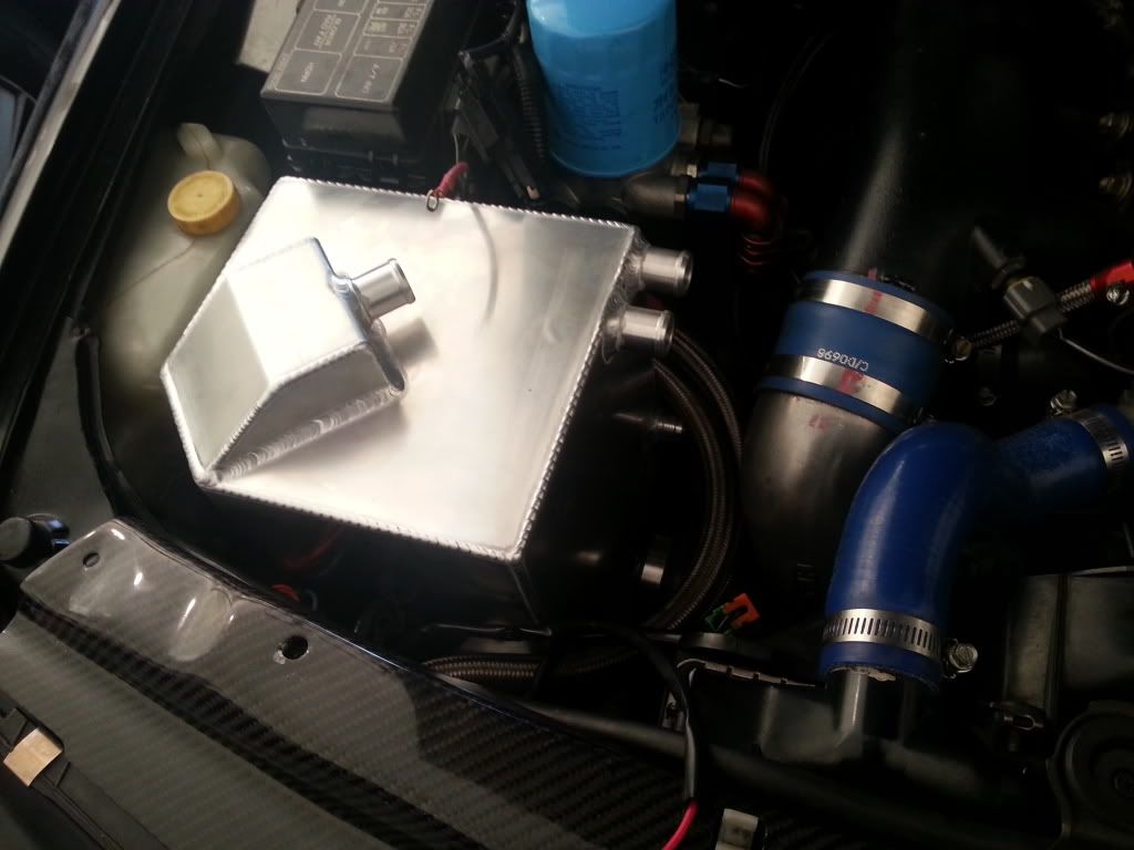

Ok a little more information, this is my set up at the moment.
with a K&N filter on top of the catch can.
The catch can has steel wool and baffles that almost 100% separates the oil from the air before venting, so much so that of the 2L of oil that went into the catch can about 3 drops came out the filter. It's the same set up that is used by the Western Australians that do plenty of track work at Barbs and Collie, the only difference being that they then drain back to the sump, which is why I asked the question I did.
I don't want to drain back to the head, because oil in the head is causing the issue. I just want to get the oil from the catch can back in the sump (if you look closely at the second picture you can see the -10 drain at the bottom of the catch can). I don't see myself as having a oiling issue, I know this set up works and it works well, I just have an issue with not having an easy way to get the oil back to the sump.
Edited by SimonR32
The question is then, how many spots in the sump have you got available? Obviously there is a drain plug and the return oil from the turbos. Nismo use the latter for their catch can. So maybe replicate that if you think your catch can will contain the oil from one run.
The only spot available currently is the rear oil drain (the issue being getting the line from the catch can to that drain) or the other potential option is we drill and tap the sump on the drivers side.
The catch can took 2L of oil after 7 laps of long track and 3 laps of short track at Barbagallo. That left my sump with just over low on the dip stick which is just enough to be on the safe side considering I have a Greddy extended sump and pickup. So even if nothing drained back during the run I could do 10 laps and still be ok, other stuff on the car is going to give up before then.
Edited by SimonR32
