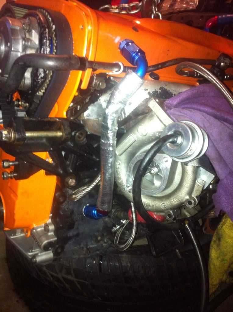

Ok I finally got around to getting mine sorted. Rear turbo oil drain (unused due to single turbo) plumbed into rear rocker cover fitting using dash 10 lines with a bit of gold tape to protect from manifold radiant heat and a dash 8 line plumbing from the dipstick to the catch can (getting fitting welded onto the catch can on Saturday).
Fingers crossed it works well :yes:

I got a little worried as there are reports the rear turbo oil drain vents a bit of oil as well (hence the fitting facing the baffles in the rocker cover rather than going in at 90deg and pushing into the crossover pipe or straight into the catch can).
I think the rear drain only pushes out oil when the turbo is still there. I had that problem with the nismo oil air separator. The blow by pushed the oil coming out of the turbo back out the oil air separator. Shoildnt be a problem with only 1 turbo
