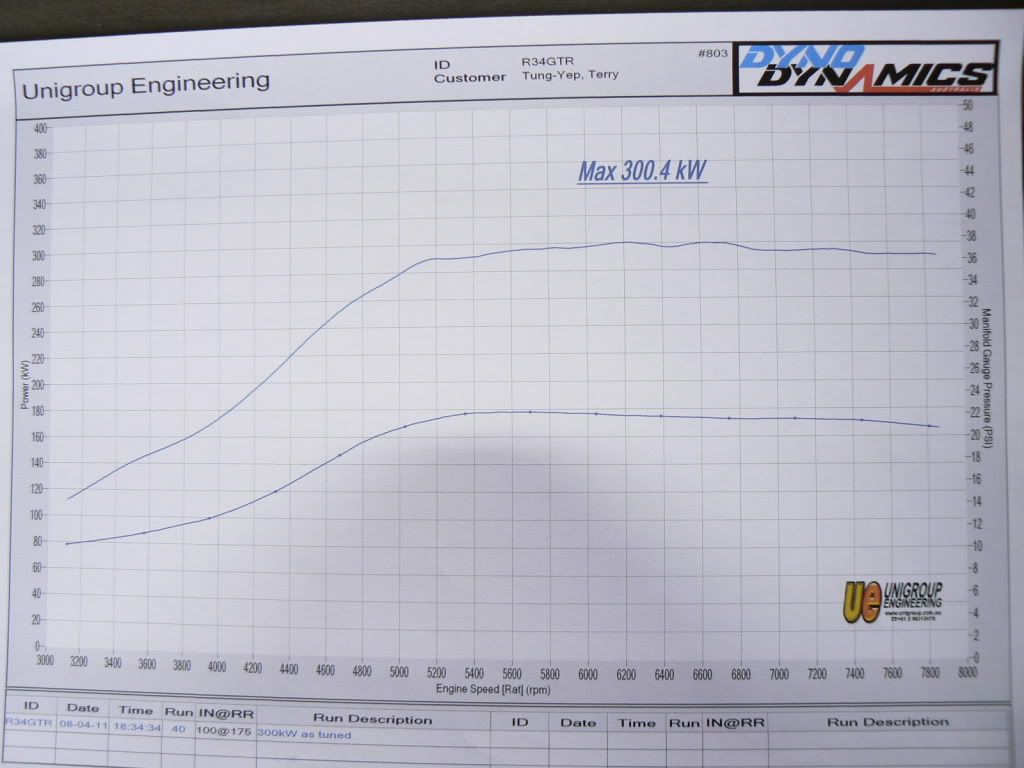

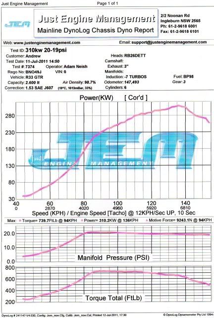

So something that I've recently been questioning is why many results of the 7's in "RB26 turbo upgrade, all dyno results" thread are the way they are.
I'm lead to believe that these are the most responsive turbos of the bunch when comparing against the -9, -5 and -10. Quite certain that most people who
have these turbos are reaching full boost quite a bit earlier than 4,000rpm; if anything, probably closer to the 3,500rpm mark?
Which makes me wonder, why are the below dyno sheets showing full boost at such high rpm? Some are as late as the 5,000rpm mark, wtf?
I understand that dyno graphs and real world may differ, is that what's responsible for my misinterpretation?
Would be great if the owners of the cars below could have a say in this as they would most likely know whether or not the dyno graph is a reflection of the real
world boost curve. Anybody with a similar setup is also most welcome to provide some feedback.
300wKw at 20psi on 98RON
R34 GT-R V-Spec II

1995 R33 GTR
Performance list:
garrett 2860 -7 running 20psi drops to 19psi
tomei dump pipes
trust front pipe
ballistic cat
nismo catback
1000cc injectors
splitfire coilpacks
bosch 044 fuel pump
haltech platinum pro (mafless tune)
bp ultimate 98
115 Greddy front mount intercooler and piping kit
Greddy air intake kit
280awkw at 19psi
Now 310awkw

I agree on all accounts, however the specific graphs I've chosen mainly consist of quite well known workshops which have (I assume - probably shouldn't) relatively honestly setup dyno's. Correction factor will take into account ambient temp and altitude? These setups seemed to have relatively decent exhausts.

Exactly. I was driving a mates GTR with -7s not 7 days ago.
I can tell you now by 3300rpm it was well and truly game on where my -5s were ~4000-4200rpm. -9s are about 3400-3500rpm.
Yet when you dyno the cars, the graphs come on & look very similar (nowhere near 800rpm), due to ramp rates and other factors.

When I say "on", you aren't making "full boost" - given such a term is silly. Is "full boost" 5psi or 50?
By 3300rpm the torque is coming on and boost is really driving so at a stab maybe 10psi which is 10psi more than a set of -5s would at the same RPM.
Every setup varies but i think 3000rpm for them to be really moving is a bit of an impossibility.
