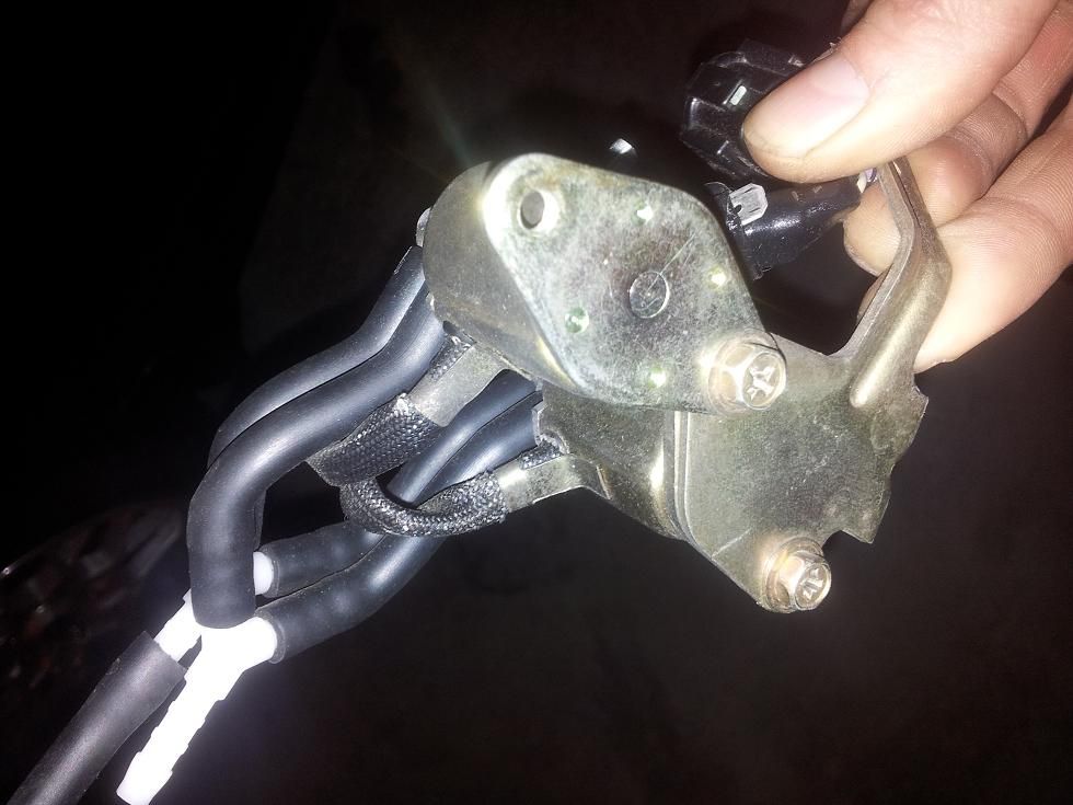

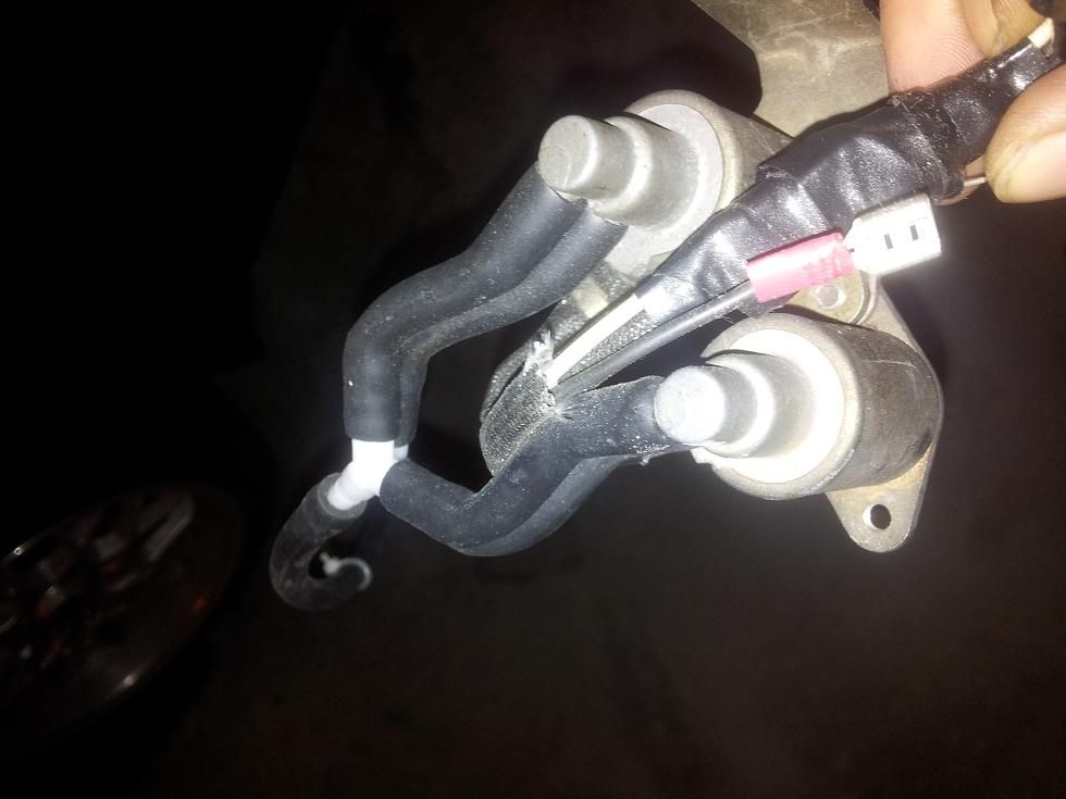

I think you might be confusing the actuator and the Solenoid.
The actuator is doing something and is required to open the wastegate. The solenoid is what you earthed.
Removing the Solenoid will undo this mod and give less Maximum boost.

R33 turbo has 5psi waste gate spring. The solenoid bleeds it to 7 or whatever the max pressure is set from factory. Boost controller will essentially bypass/replace the solenoid.
