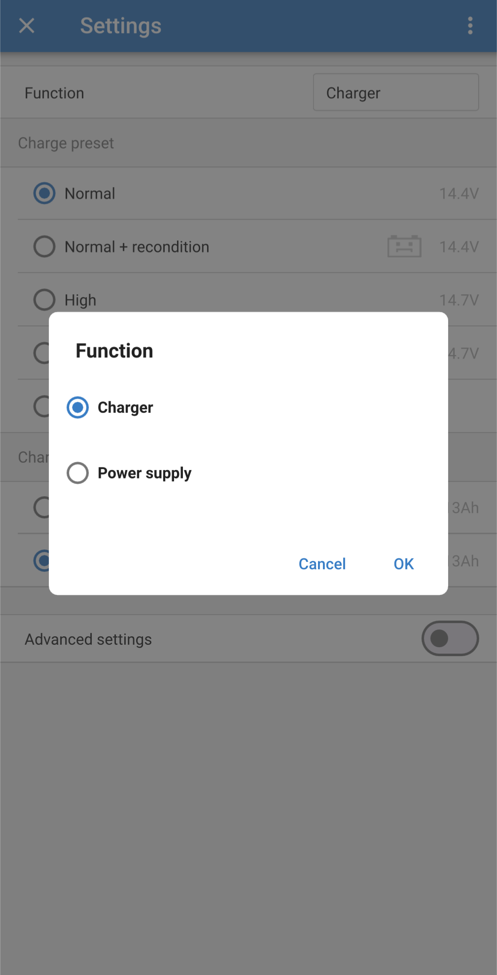

Liking the new charger, battery all good (I think).
Also like how you can put it in power supply mode too. Will troubleshoot with that sometime soon.
