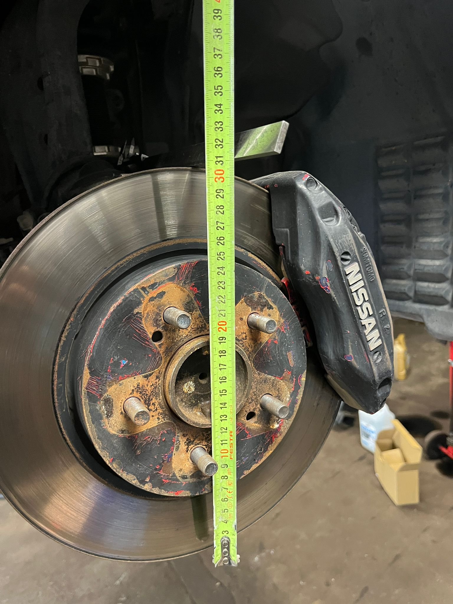

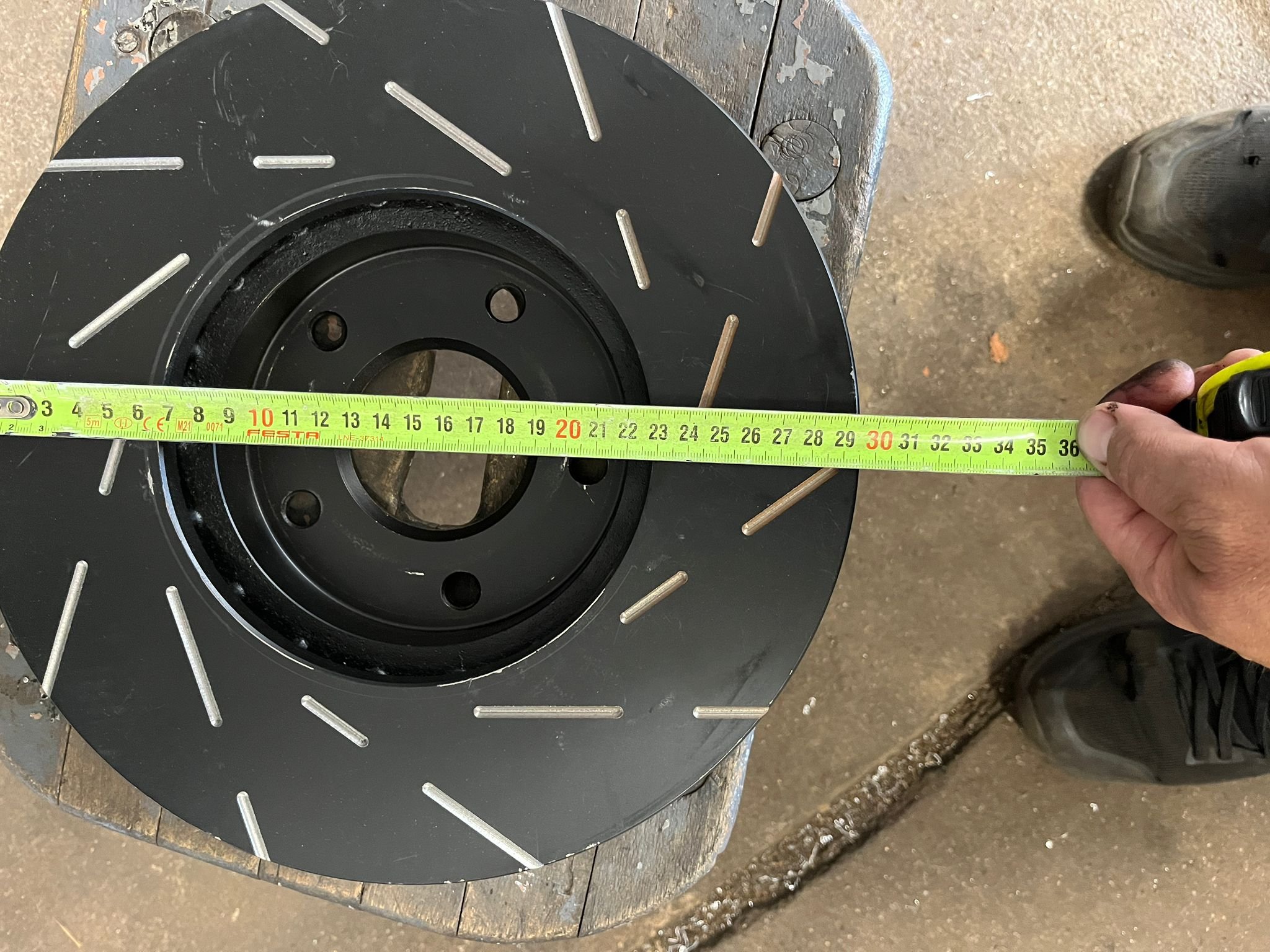

Posted (edited)
Hi...a bit a "development" on the brakes.
I spoke to the guys where i get brakes from...and they are saying that 296mm EBC are for R34 GT-T.
I then went to their site:
https://www.ebcbrakes.com/vehicle/uk-row/NISSAN/Skyline (R34)/
and search for my car(R34 GT 1998 - it has GTT brakes) and it show me this USR1229 number and they are rly 296mm rotors...
So now iam rly confused...
The rotors i have now on the car are 310mm asi shown...
So where is the problem? Does the whole EBC got it wrong or my calipers are just...idk know what?

Welcome to Skyline ownership. Yes, it is entirely possible parts websites get things wrong. There's a whole world of inaccuracies out there when it comes to R34 stuff (and probably 33 and 32). Lots of things that are 'just bolt on, entirely interchangable' aren't. Even between S1 and S2 R34's.
Yes they have a GTT item supposedly being 296mm. This is incorrect.
I would call whoever you got them from and return them and let them know the GTT actually uses 310mm rotors. Depending on where you got them from your experience and success will obviously vary.
  • Thanks 1
