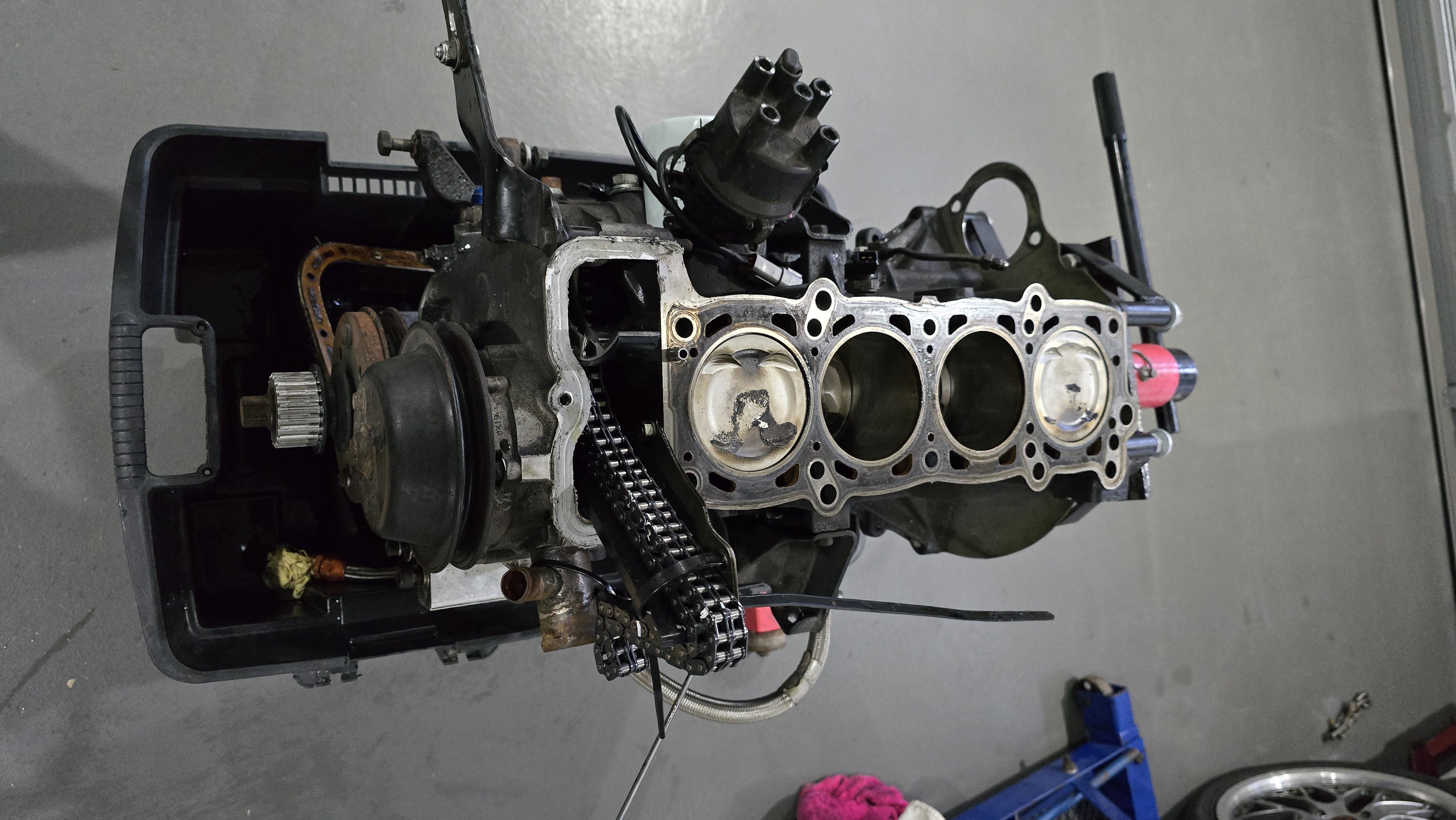

What should I do next to hold the head on
When you pulled it off, there is no signs of blown head gasket? Is it possible you have some other issues going on? Possible cracked blocked? Or do you think it's straight up lifting the head? Did you check what the head was torqued to before pulling it down (To see if possibly they're stretching, or starting to break threads out etc)?
