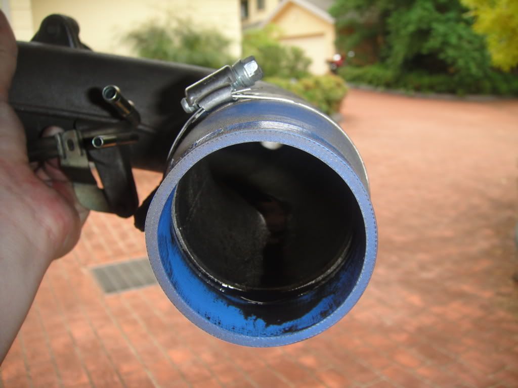

Sorry to revive an old post, but during my searching I found this thread, and I think I have the same problem.
I bought some new coilpacks, and after I removed some intercooler piping I found a decent amount of wet engine oil. It's the pipe leading directly into the inlet manifold. See the attached pictures.
I've hit a bit of panic mode, but I'm not too experienced. What do you guys reckon?

if the cam covers vent to the intake there will always be some oil in the intake, clean it up and drive around for a week then check it again. if the turbo is blown there will be lots of oil in there again. (all cooler pipes and intercooler core)
Just checked all my intercooler pipes - they are all on pretty tight!!
Could be your rings as well mate. Have you noticed anything different in the cars driveability? loss of power, stuttering, hesitation, funny idle etc?
Any smoke come out when the cars on & warm/hot out of the oil cap?
mine is having the same issue, i installed a catch can and it helps somewhat but the only way to completely get rid of it it is to rebuild or new motor and get a good baffled catch can installed.
mine is a bit more excessive then yours tho.
