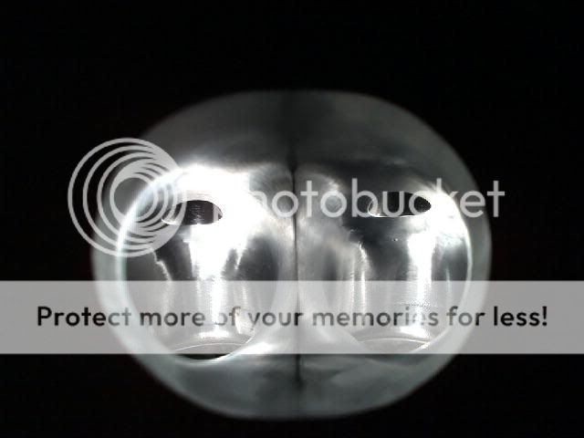

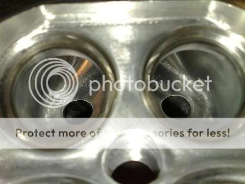

Here are some of the finished porting pics.
haha i really like this next pic. Is it just me or does it look like a skull is staring back at you!?

Head porting is like a black art for me.
When does a light port becomes too much, hurt mid range response and is only good for top end?
that's the problem. you wont know till you bolt it on and try it. the only real way to learn it trial an error. you will almost certainly port a lot of heads that end up worse than they were standard before you start getting them right. which is why it's important to go somewhere that has done lots of RB26 heads as every engine is different.
Yeah, really happy with it. Andre did a really good job. He's been doing it for years now, so i totally trust his work. He has his own flowbench too. The head is also CC'd as well. He charges so very reasonable considering the time spent on it. The head took some time to do as it is not Andre's main line of work anymore. He just does it in his spare time. When i showed JHH they were very happy with it, and said that if they were to charge for something like this it would cost between 4 and 4.5k! I couldnt believe it! I didnt know it could cost sooooo much! I'd never spend that sort of money on a headjob. :P I was stoked! I guess with headwork its like asking "how long is a piece of string?"
