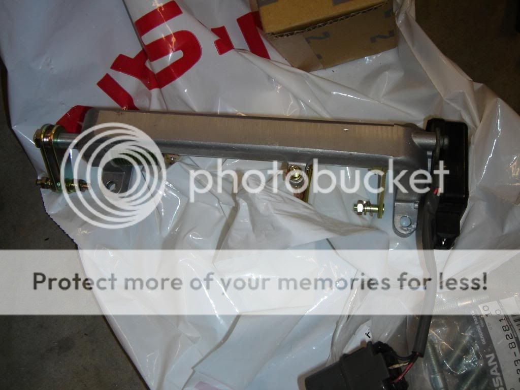

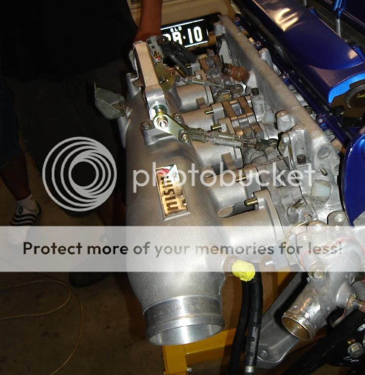

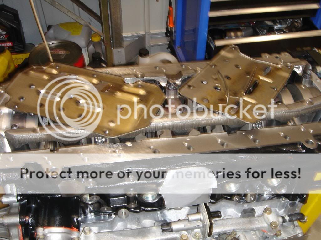

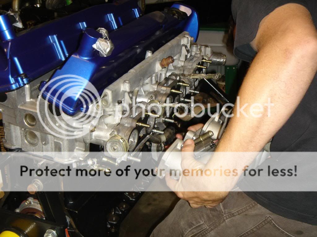

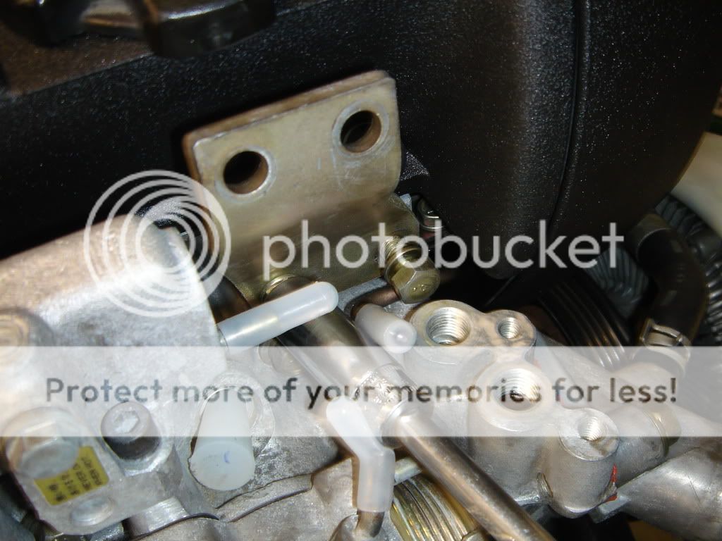

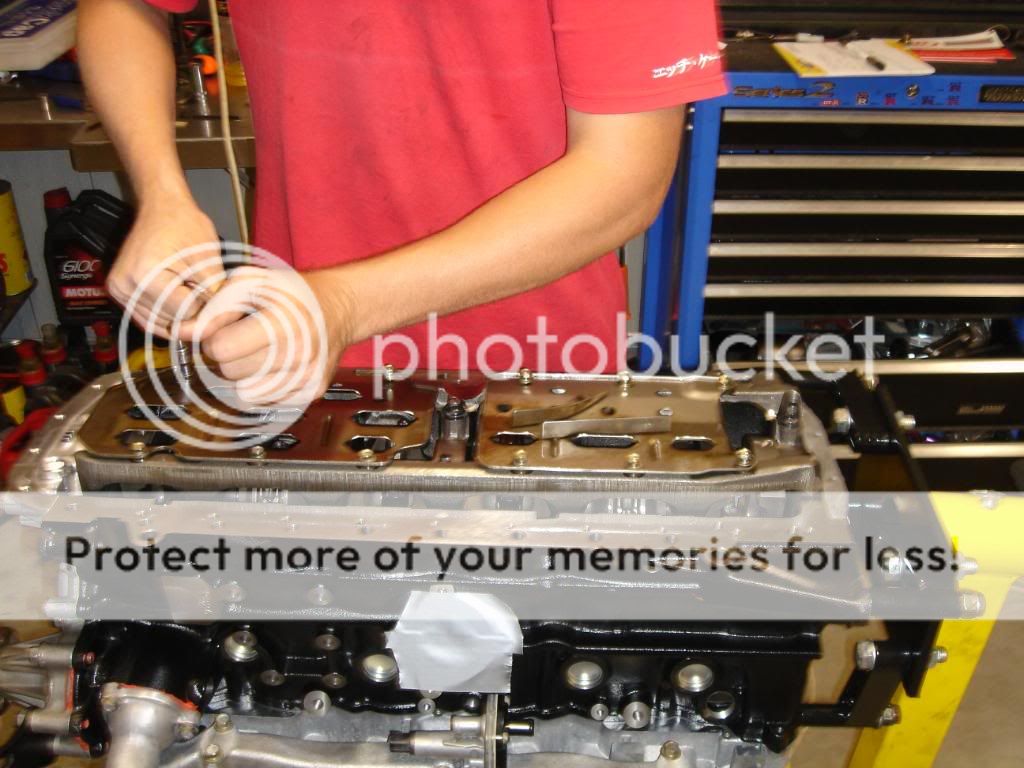

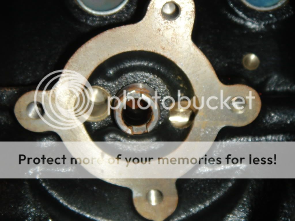

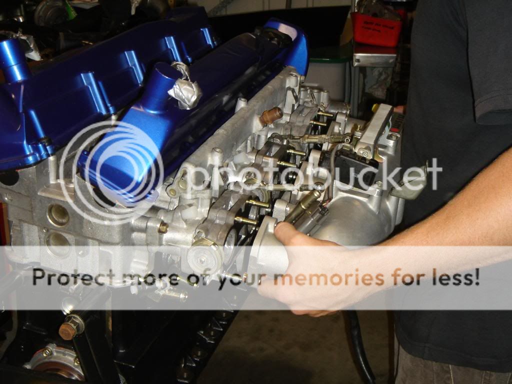

Ok, status update. Got up to the stage where we can put on the Nismo plenum. But when we were putting it on, we noticed that some of the locator dowels were missing. Unfortunately these are part of the Throttle body assemblies and therefore cannot be ordered separately! Anyway, whilst dazza was thinking about what to do, we continued with the baffles on the bottom of the girdle.

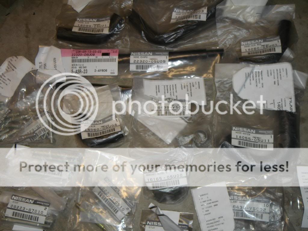

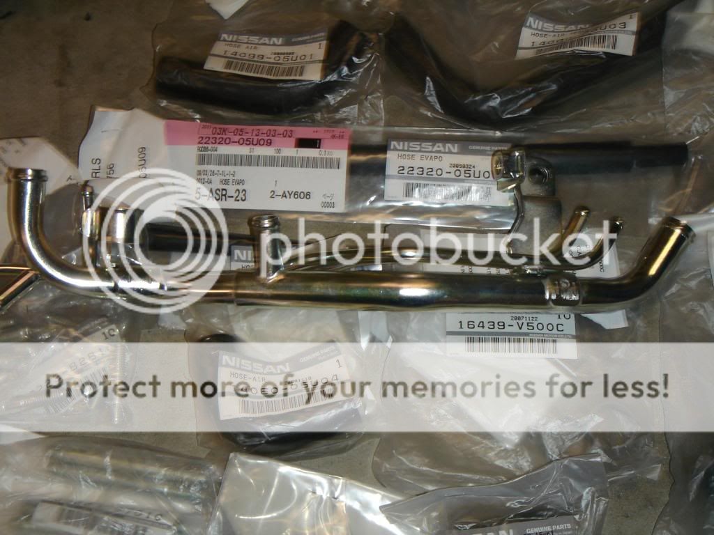

All the hoses and brackets etc needed to bolted up to the plenum. I used mostly new parts for this as most of the hoses and clamps etc were starting to deteriorate (very hard etc and clamps were rusty)

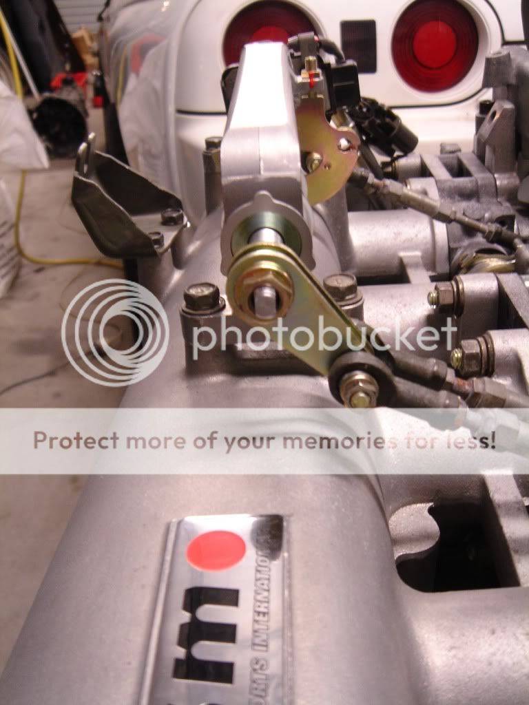

The new throttle body bracket and throttle position sensor fitted
New water tube and hoses.

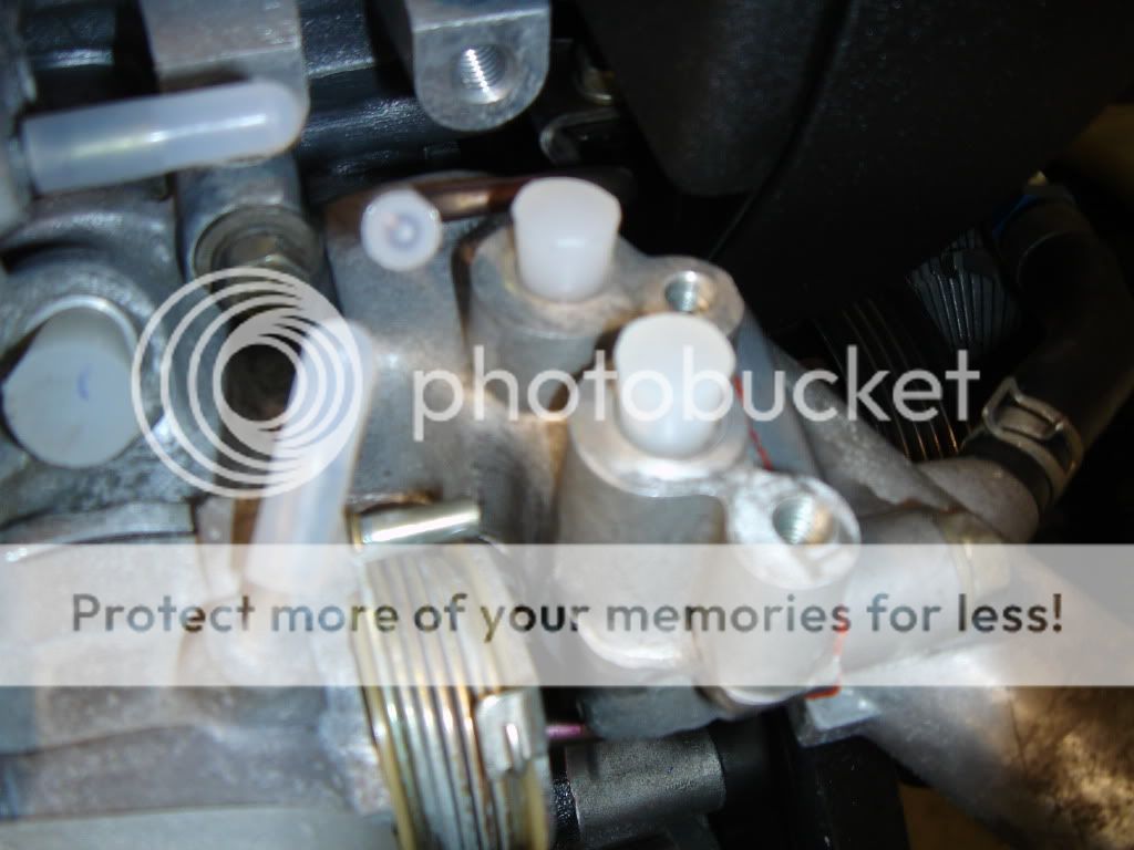

Dazza went to all the hardware and nut and bolt shops and couldnt find a locator dowel to match. His brilliance once again shines when he uses the sleeve off a dynabolt (cut down to size of course) and viola! PERFECT fit! Project bomberman back on track!

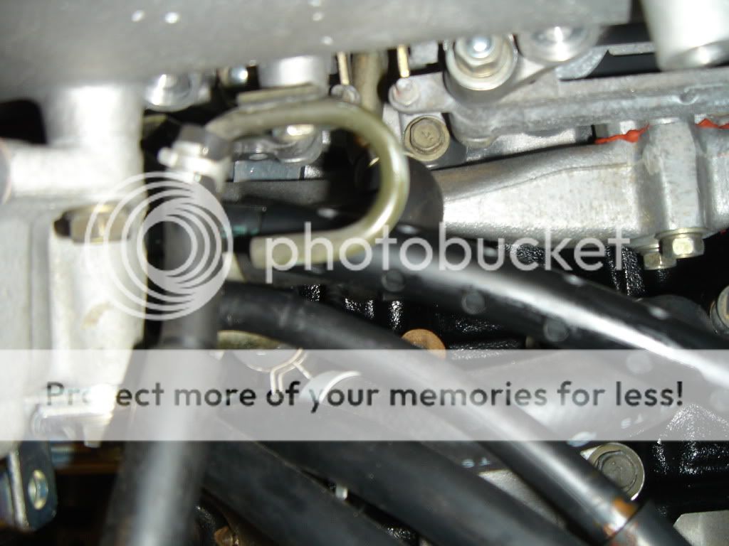

Attaching the hoses to the pipes and tubes.
On with the plenum!
Attach the throttle body arms
Bare blocks dont have this little fitting either.

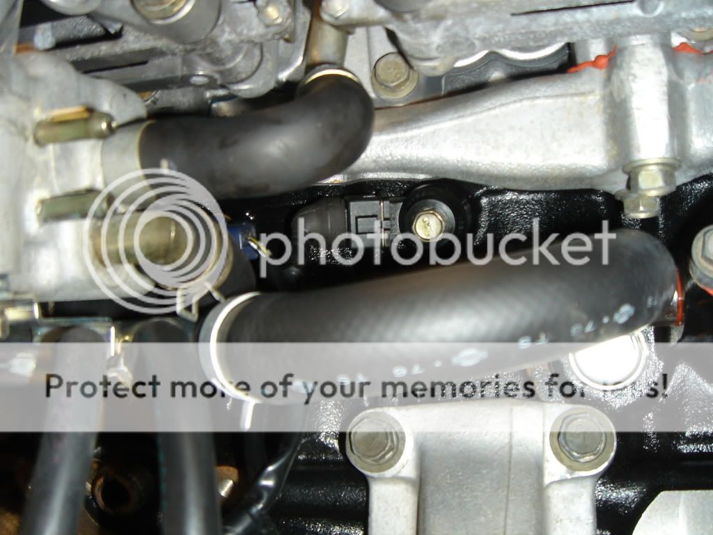

New hoses and clamps for the underside of plenum

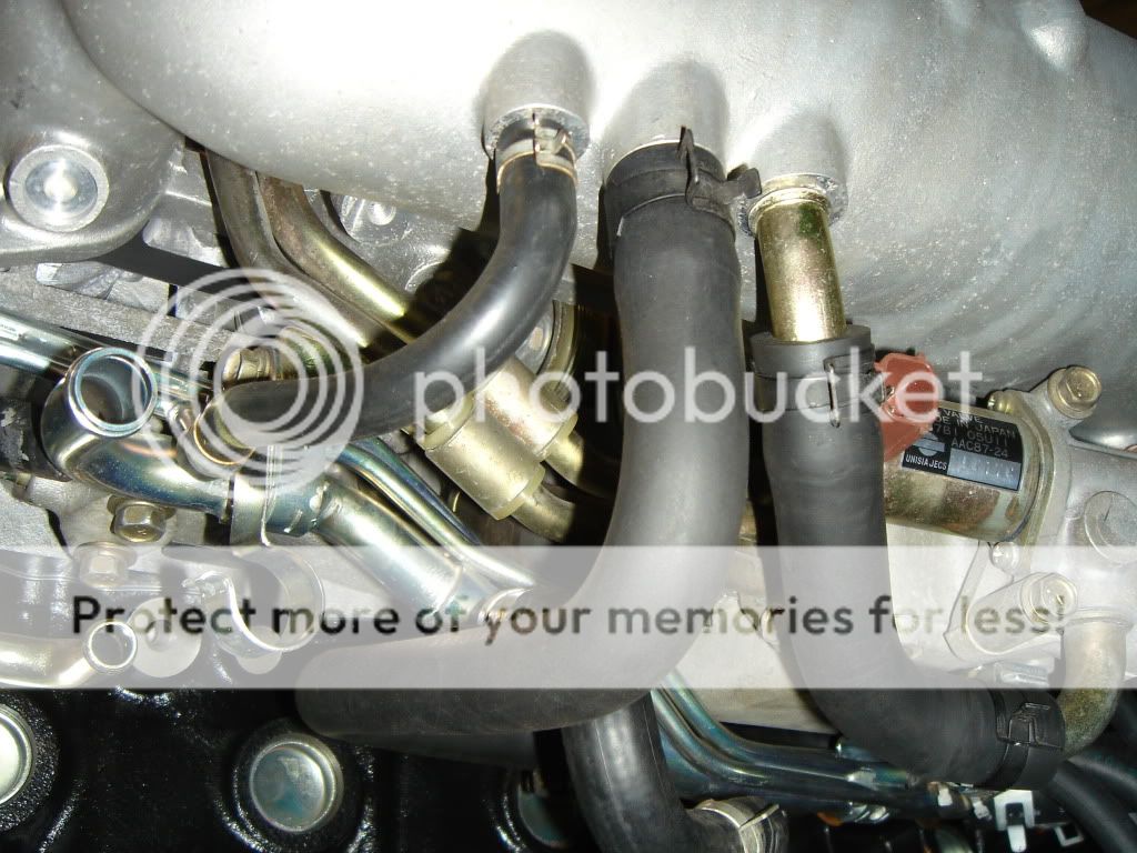

AAC valve fitted and new hoses and clamps where possible. Some of the Clamps and hoses were reused because some of them were not in production anymore!

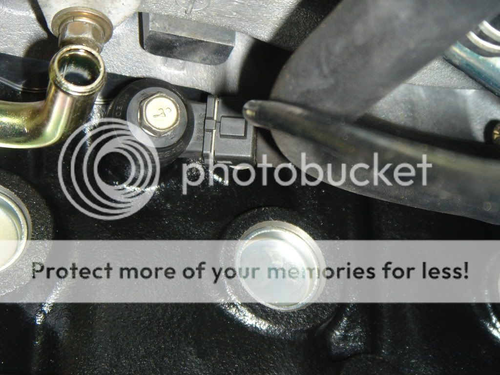

knock sensors fitted as well.

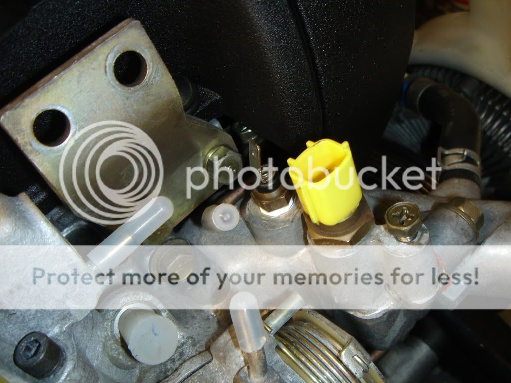

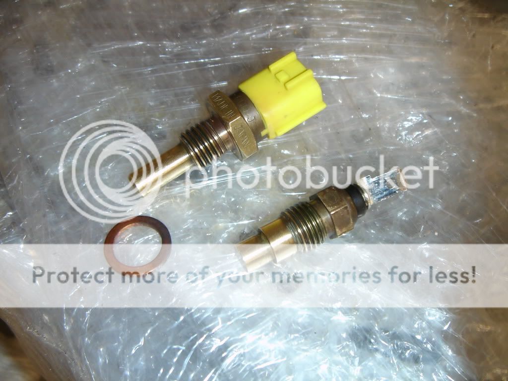

Water and air temp sensors were fitted. The gasket kit provides a new copper gasket for the air temp
all holes were covered with silicone plugs and sleeves throughout the build.

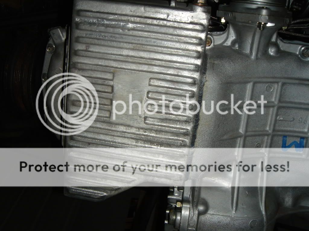

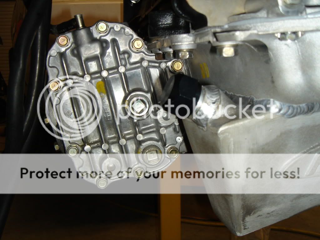

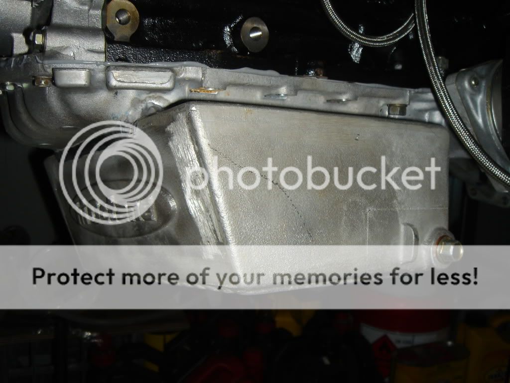

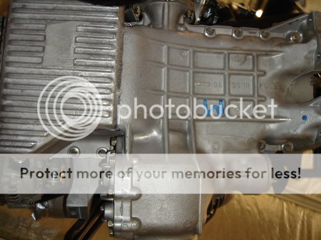

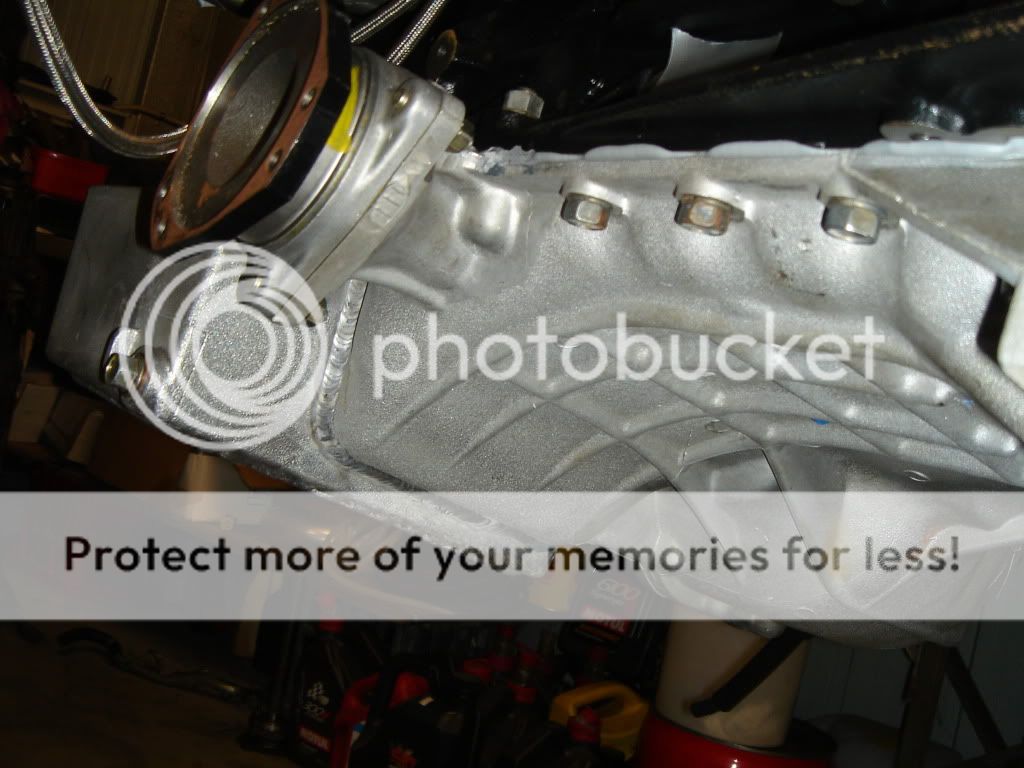

At this stage of the build, I was overseas, so there weren't many pictures taken whilst dazza did the work. The extended pickup was fitted and the sump went on, with Hi Octane sump extension.
We will get new nuts and bolts to secure this part of the sump as the standard ones were not suitable.
I also had a -12 fitting welded on to the side of the extension for an oil return.

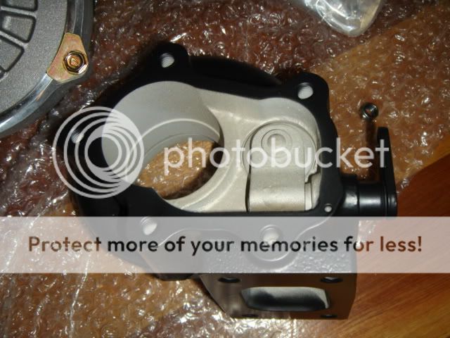

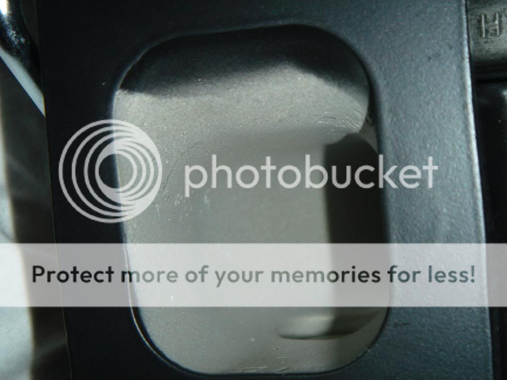

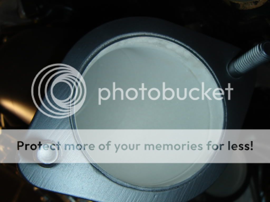

Turbo housings, HKS exhaust manifolds, and Tomei dumps are back from being ceramic coated. They were done by Competition coatings. The Black coating is quite expensive (and comes off if you sneeze at it!) but is supposed meant to retain heat better. Up to 30% reduction in underbonnet temps! Sceptical though...... but we'll see........
All of these parts were ceramic coated inside and out. Yes i asked the question if it can flake off....... "no possible damage" was the answer.....
