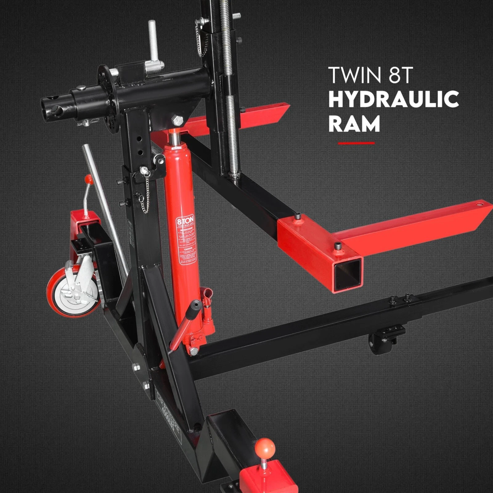

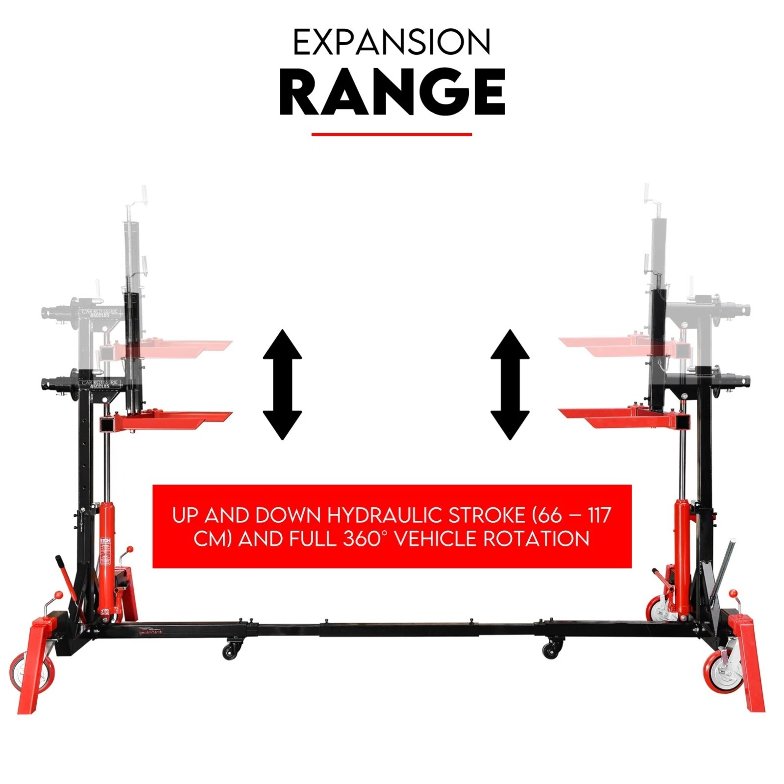

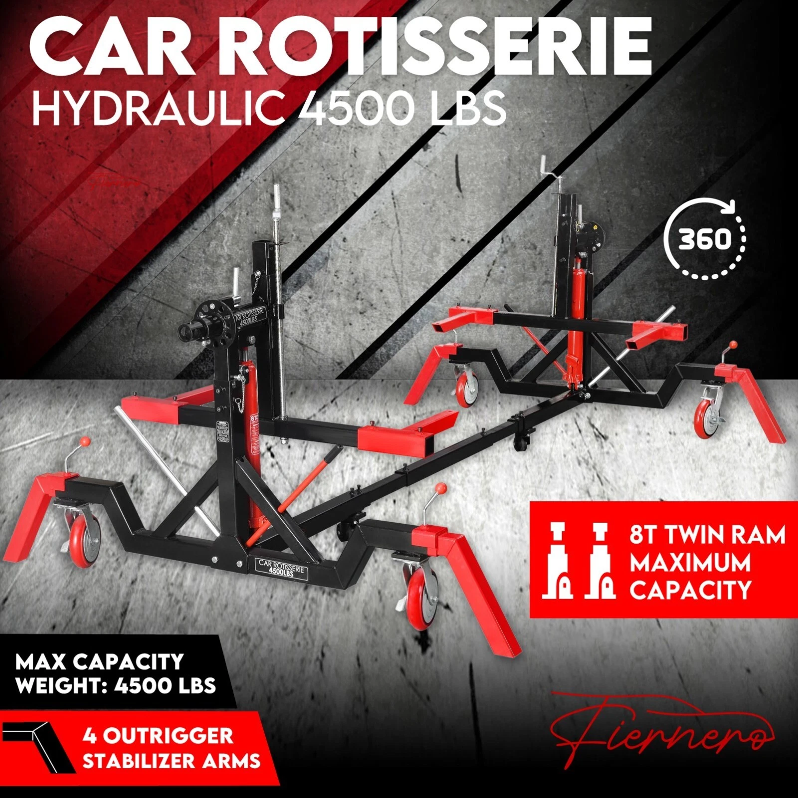

I'm pretty much healed up post surgery so I spent another almost full day out in the shed re-arranging everything to make room for all of the shit that I've taken off the car.  I need to get everything off the floor and away from the car for when I start making a massive mess stripping off the remaining body deadener and then for the the painting process.  Almost got the shed to a point now where I feel I can actually start working on the car again (clean shed clean mind or something!).  Almost 11 years of accumulated car parts, building supplies, tools, junk, etc have taken a long time to get in some sort of order again!  Most stuff is now boxed up and in the back shed if it's not car related.  Most people would still be horrified walking into my shed but it's significantly better than it was before!
For those that saw my separate post the other day, yeah I ordered one....
This version-
Picture 1 of 12
Picture 5 of 12
Picture 9 of 12
I convinced myself to stop being a clown, wake up to yourself and realise it will take you 5 weeks to make one by which stage you're over working on the car again...  Maybe I am getting on top of my "mental ailments" and making smarter choices....
$1450 delivered which will take my miserable half-dutch arse a few days to get over having spent that much!  If I don't have a use for it straight away after my car is off it I might even see if there is a "rental market" for them.  See if anyone wants to hire it for a period of time.  $25 a week or something like that.  I'll worry about that when my car is actually ready to come off it though as that might be a while away!!
There's now no excuses now for not ending up with an underside you could eat off!
Away for kids sport the next few weekends so hopefully can get the rotisserie assembled ready to go for the car to go straight on it the next available weekend.

Probably a smart choice to buy one vs build, purely for the motivation part as you said! Imagine the metal dust everywhere from grinding all the steel to build one. Ha ha ha!
