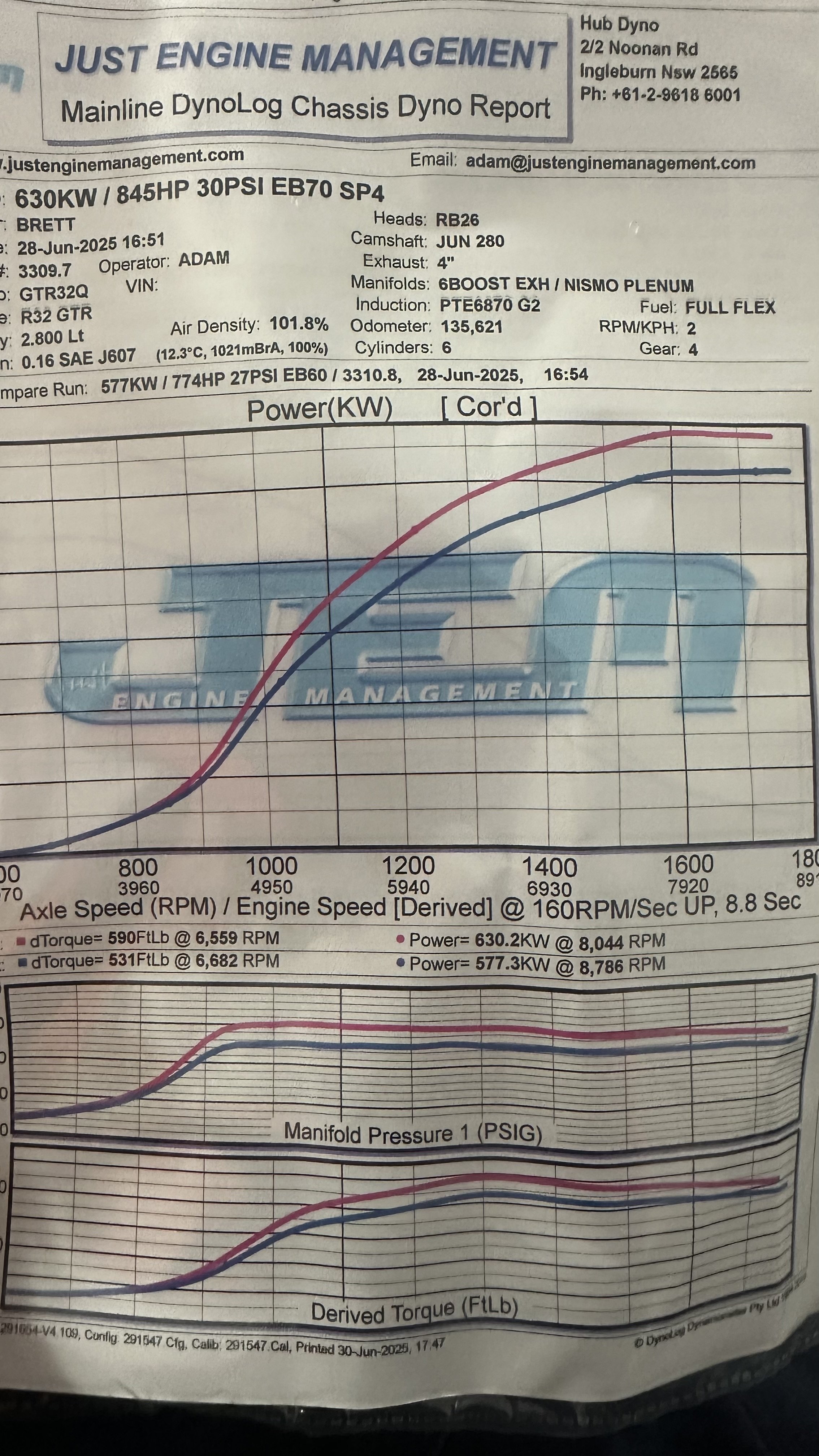

Pretty stout result. How much boost? Anything left in it?
It’s at 30psi, there’s still plenty left in it and Adam said it was making the power easily!! We ran out of injector though
