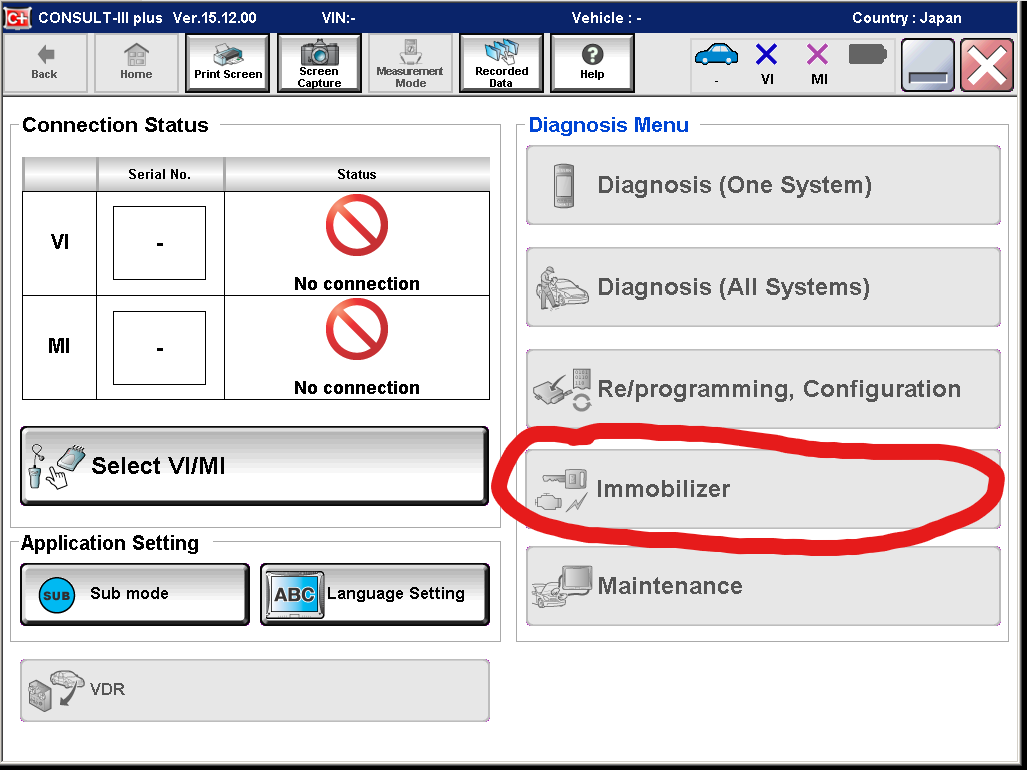

OK. I did a bit more homework and I think I have the missing piece in the puzzle.
So, the locksmith/dealer in question needs to have:
  • Consult III+ scan tool (or compatible)
  • Security module (what I was previously terming as the immobiliser peripheral)
  • In the event that the secondary PIN code needs to be calculated - access to Nissan's Techinfo site for their PIN code calculator OR a piece of software released by a clever mob in the UK for about $30
Process:
  1. Plug in scan tool, load the Consult III+ software and enter the Immobilizer menu
  2. Follow the directions given in the software, whereby it will either extract the PIN code from the BCM or you take a note of it from the label on the BCM (will be four digits under the barcode)image.png.11d24f9d1467260e8ef979caf4aed977.png
  3. Secondary PIN code:
    1. If you have the metal tag which has the four digit PIN code punched into it, that will be the secondary PIN code and you enter that when requested by the Consult III+ software
    2. If you do not have this metal tag, then you will need to use either the (ahem) acquired software calculator or have someone with access to Nissan's dealer support website to perform that calculation for you. The resulting calculated secondary PIN code is then entered into your Consult III+ software.
  4. Continue following the directions to program your keyfob and away you go.
Still no mention of "frequencies" anywhere. :)
