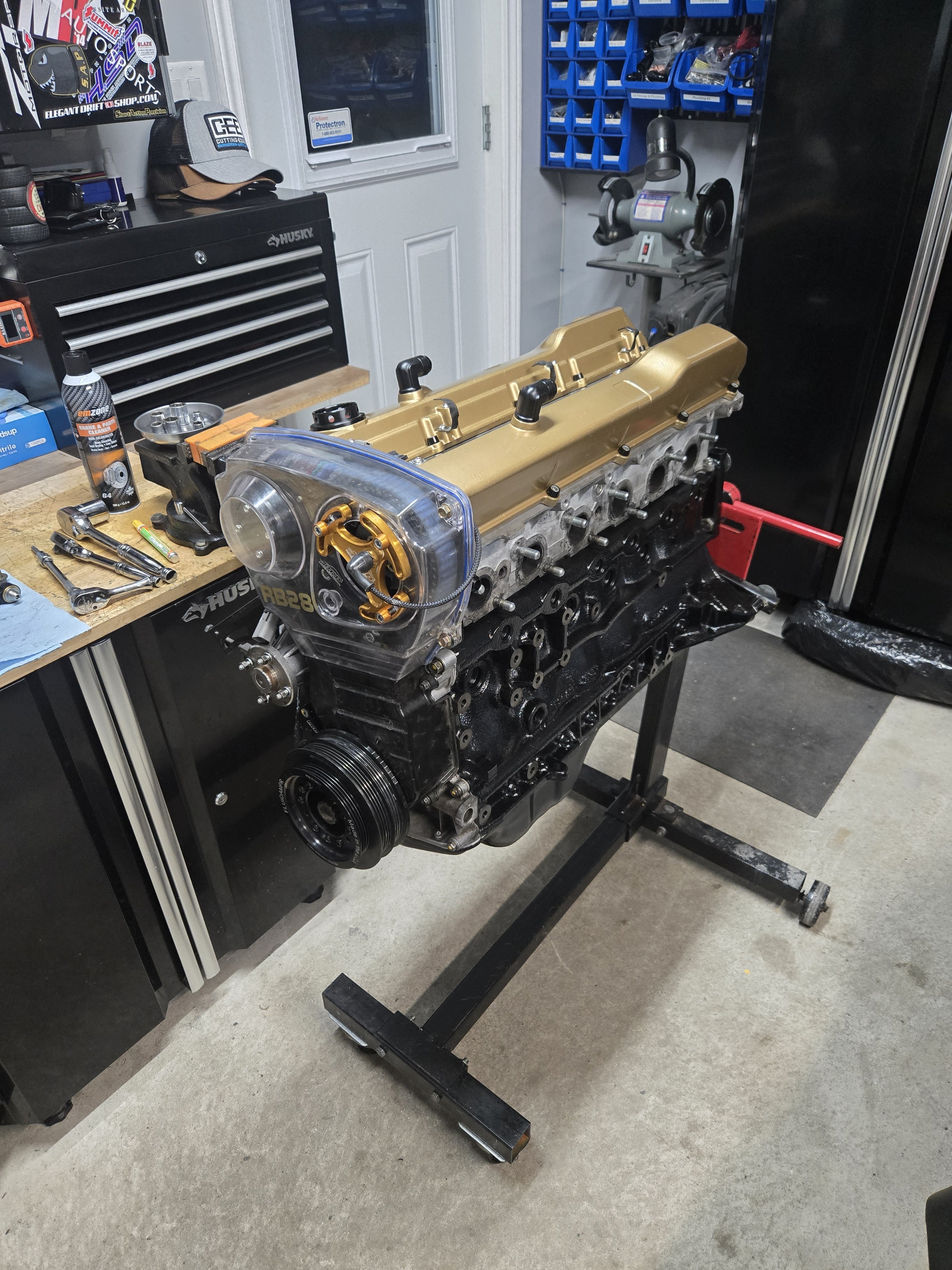

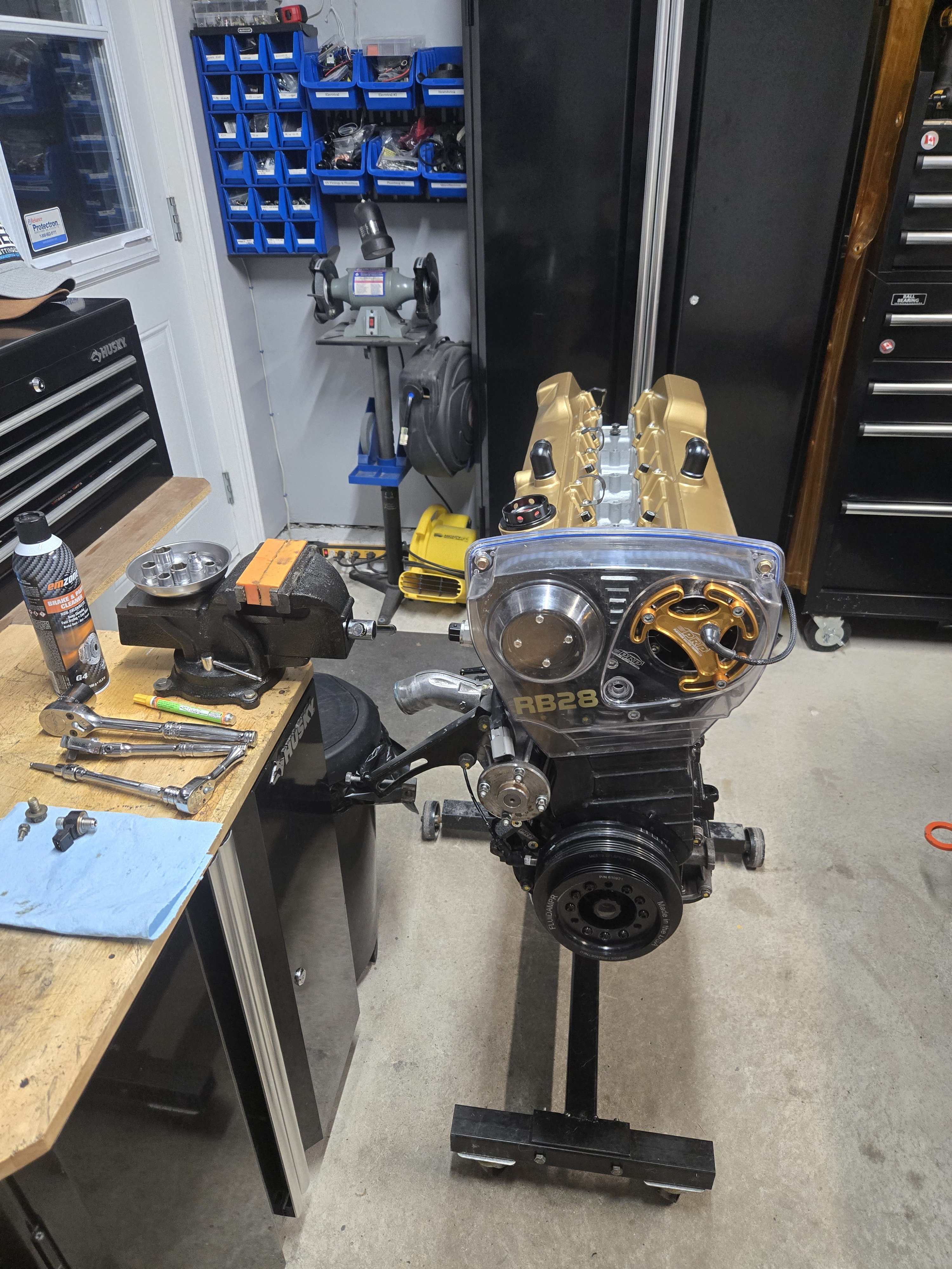

I picked up my block and head last week and have been slowly assembling it since then. Pictures I took earlier this week. The rest of the auxiliaries are on now. I just have my intake manifold runners to tap for my WMI direct port setup before putting it back on. I should hopefully have the motor back in by this weekend.
image.thumb.jpeg.28a224873d43078e15d2a27294b16eeb.jpegimage.thumb.jpeg.9a3852a6727084458d515f24683da9d4.jpeg

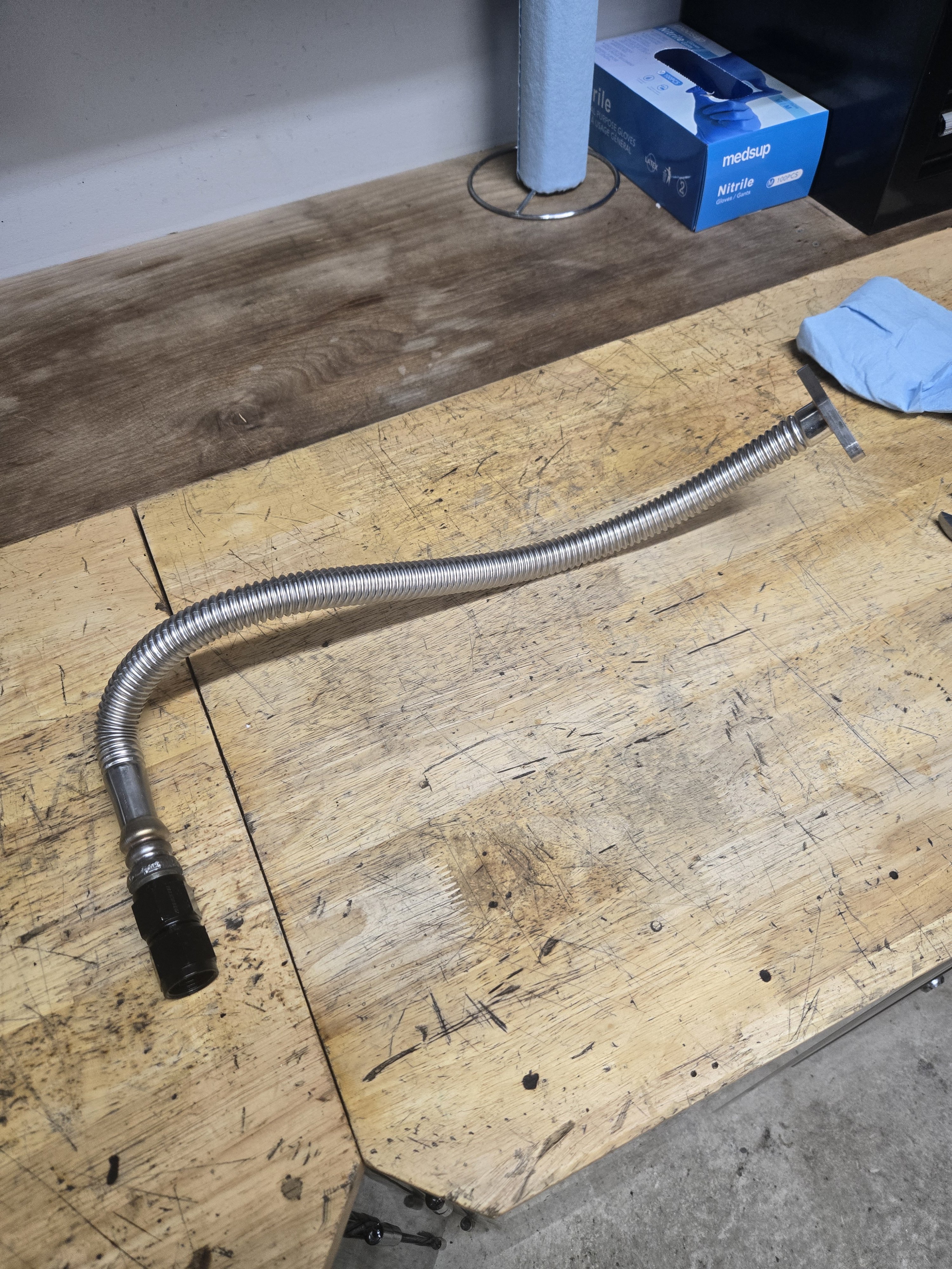

Wrapped up putting the motor back in today. I have a stainless flex turbo drain pipe like you see on cummins and that funny enough PRP started selling. I generally prefer these but sadly they come with a finite amount of times they can be bent before they snap. Took well over a week for a replacement to arrive.
20250525_203312.thumb.jpg.0f59ebc226123e8d29940797b8fc3e5d.jpg20250523_203753.thumb.jpg.97fe2c0b682eed74dde48455628a22de.jpg

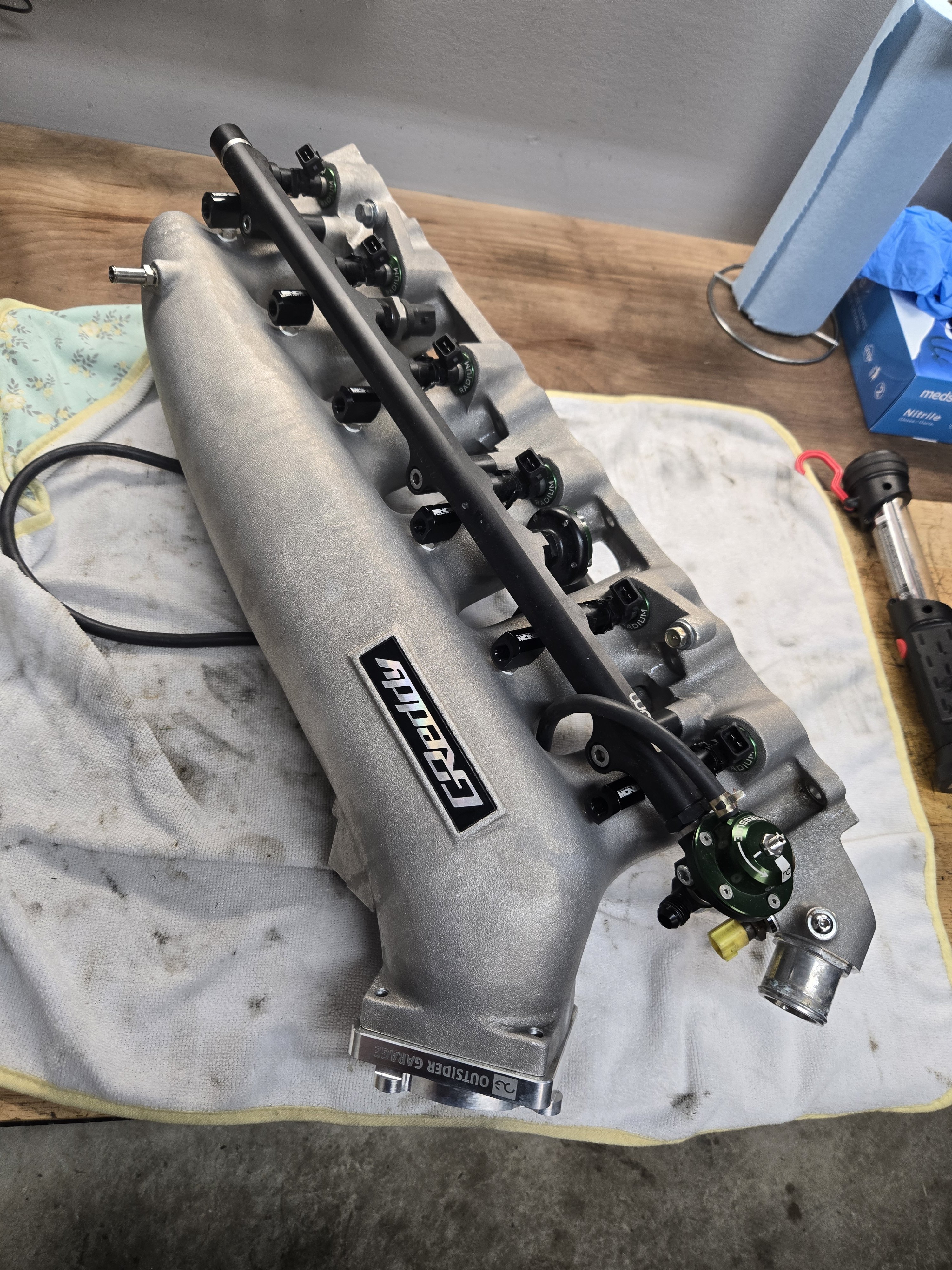

I was able to prime the pump but I will more then likely wait until next friday to take it on its madden voyage. I also installed the nozzles for my direct port WMI setup but plugged the nozzle holders for now. I'll tube it with Swagelok SS tubing and fittings next chance I get. No rush, i'll be breaking it for a week or two anyways.

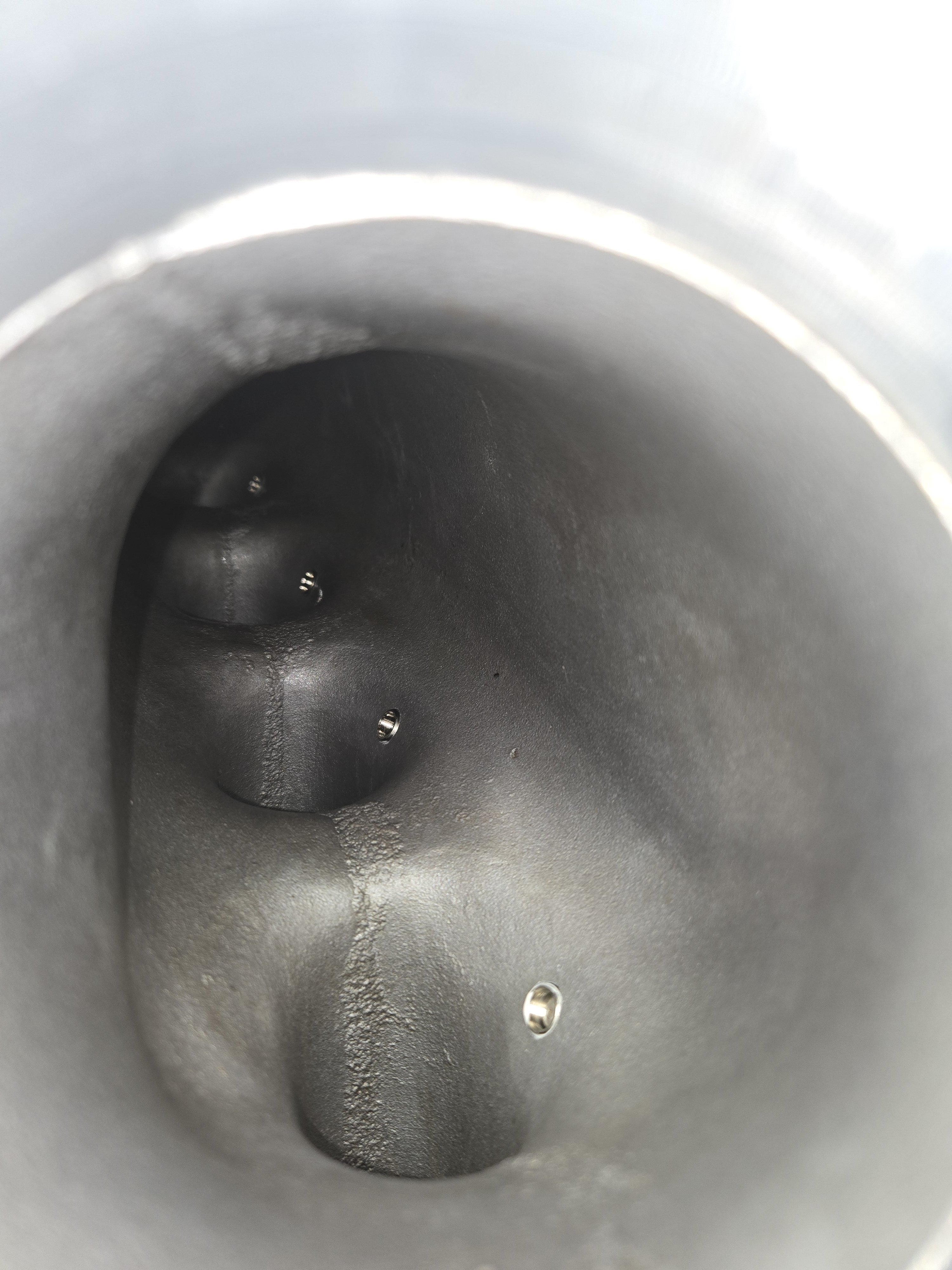

Wild WMI setup, first I've seen where it's on each cylinder runner, usually I see a single jet pre throttle.
Haha thanks! Yea I'm moving over from 2x 1000cc jets pre throttle over to 6x 190cc direct port jets and 1x 500cc pre throttle jet.
Direct port comes with all the advantages you would expect, except that pre throttle does cool down IAT'S more. That's why my direct port nozzle placement is closest to the plenum as possible in the runners to allow the air more time to cool before being sucked in. I'm also putting that one 500cc pre throttle jet to help with more cooling. It's a hybrid system. There's a lot more advantages to moving over to a PWM solenoid with a constant pressure system vs my old PWM pump setup, but I'll get more into that once I'm done converting everything over. The ricer in me is excited to see SS tubing all over my manifold though!
