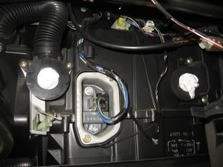

I've taken the glove box off, can someone tell me what the 2 holes are here left and right of screen that previous owner has stuffed with tissue paper please?
Thanks

try stuffing paper into the plug thingy, that's what i did.. air is cold, but is there a more permanent fix?
pull out the actuator which the rod is clipped onto. (its behind the headunit and climate control on the back wall. Once you got it out. Crack it open, resolder the joints to the plug. Problem solved.
If you dont have the experience to resolder it, just rip it out and PM me
