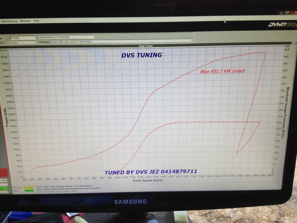

Stock RB26 including stock cams
Precision 6262 .8 twin scroll
6boost twin scroll with twin tial 38mm gates
Custom dump and plumb back pipes
LINK ecu
ID2000 cc injectors in stock rail
Walbro 400lph
Running semi slicks on the dyno too
Gate pressure
E70
