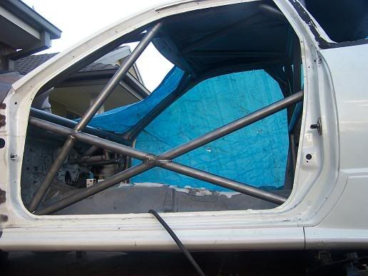

Yep, I was blown away with the attention to detail. The entire cage is beautifully snug against all the pillars and roof.
Peter Muir from Bondy did it for me... Got the introduction and hookup from Steve Thatcher, so I think that helped with the perfectionist result of the job :P
Those front legs had 6 bends each to get them to sit that close... Amazing anal-ness that would rival my own ;)
Alan Smith tells me you guys are good mates :) Tell him to get off his arse and buy Ric Shaw's FD3S...
Peter did my cage pipework too...it is a great fit...Guido did the welding and used a corner box just like yours.
i cant see that a cage that has been ANDRA approved will have any issue being CAMS approved, but maybe not the other way around. From what the guys have told me CAMS are not as stringent with there inspections, but in saying that i am sure there is minimum guidelines.
well now ive started the conversation of cages, can a cage be CAMS and ANDRA approved, and if not how come?
CAMS are not that strict, in many cases you can self certify as long as it meets the guidelines. If you wanted both, I'd certify CAMS first but don't apply the sticker. Get your ANDRA certification then apply the CAMS sticker.
Had this cage built 2 years ago a ProFab motorsport fabrication. was initially built for a drag car. we added a second side intrusion bar on the drivers side when we decided to use the car for circuit. Box method was used for the main hoop with large floor plates at the front and rear.
Are those hoop crosses joining the main hoop less than 100mm from the base plate??
Looks like it would be mighty close.
The car's sold now so can't confirm, but Dave @ Competition Fabrications did it, builds Supercars, heaps of fab for HRT, and top level rally stuff. The guy knows his stuff, Giant also had his done here.
Peter Muir from Bondy did it for me... Got the introduction and hookup from Steve Thatcher, so I think that helped with the perfectionist result of the job :)
Those front legs had 6 bends each to get them to sit that close... Amazing anal-ness that would rival my own :laugh:
Alan Smith tells me you guys are good mates :D Tell him to get off his arse and buy Ric Shaw's FD3S...
Yeah Pete's cages are always very tight. The one im doing in my new car is very tight around the main hoop to body but I have relaxed it a little on the front legs so I can get the pading right the way around.
The time spent getting the angles and bends in the right position is well worth the effort. Yours is really nice!
I didnt even Know Ric's FD was for sale. He should buy it though. Alan needs a decent car.
You will need atleast a single cross bar in the main hoop, Or atleast im nearly 100% sure.
