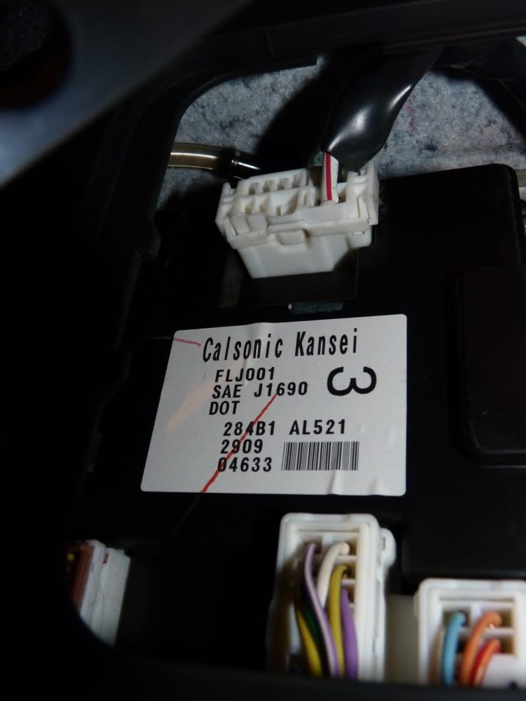

the details are
FLJ001
SAEJ1690
DOT
284B1AQ000
2802
AQ000
hope you can help
thanks tim

Hi Tim,
The part number you have provided is a bit strange as it seems to contain the serial number as well. Are you sure its not 284B1CD410?
I've ran the last number as your serial. Check your PM for the immo code it came up with.
Cheers,
Tom

Hi Tom,
If you can see a serial number here, could you please PM me a pin. Thanks very much in advance for your help.
Bob
Hey Bob,
I've PMed you your pin. Let us know how you go with programming a new key.
Tom

Hi Daniel,
I can't see the serial # on your BCM. Usually it's at the bottom of the sticker. Yours doesn't have it.
Is it of a 4 door v35?
Cheers,
Tom
