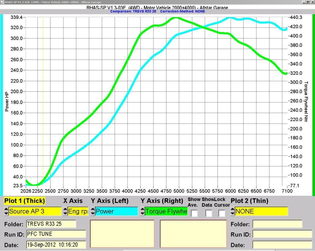

It looks either wastegate is unsealed or VCT is not activated.
Ask Sean to change the VCT settings through the ECU and see it response to power curve. 2ndly the actuator has to be removed for turbo installation and in many cases the pre-load was let by the operating mechanic (many believed they shouldn't be tensioned) or not been corrected adjusted after installation.
Drop the cat, have a play with the EBC, that dip and claiming back up shape looks strange. To get around the 280rwkws mark it needs to hold around 20psi up top.
Further more, pretty much all results came out of the test car are on aftermarket manifolds. I will see Trent next week to trail a larger turbine housing for the SS2, which should compensate a little working with stock exhaust manifold.
I installed turbo to engine, then engine into car. Actuator hasn't been adjusted. But i will check it Saturday morning And test Vct just to be sure.
Might be able to log boost against Rpm then drop Cat and compare and see if it gains much response
Edited by t_revz
Thats honestly a pretty good graph man.. I can imagine you would want boost in as early as possible, and to hit the mark for power, but that is all in by 4k already.
It definitely has the marks of a fast car, and I do believe the turbo is performing based on the shape of the curve. For a turbo thats capable of more power, to me it looks like its not running enough boost, or theres a flow restriction of some sort (other than the turbo). As its only a minor hold back on boost and your missing 10-20% power.
Theres definitely more in it once you work out whats holding it back.

Interesting that they didn't use any correction method, I've never had a run on Allstar's dyno without SAE being used.
Make much difference?
I see mine says 2000+4000 while simonr32's says 2000+3000. Googled last night but didn't find an answer. I know nothing about correction methods so have some studying to do
Yeah I'm not too concerned. But would like to get the most out of it after spendibg so much time and money on it. Regardless I want to change exhaust from behind the dump, check all obvious things then wind more into it. I'm confident with more boost the power curve should be close to everyone else.

I dont want to set the bar too high, it is a HF and is running a microguess. The microguess is the biggest holdup, to keep the tune safe I say discount about 20 from what it can do as a maximum.
I wouldn't have a clue myself, but from memory Simon said it adds 7% to the total power. As does their dyno apparently. So together my power figure is apparently 14% out. I think that's what it worked out to, the question was whether my 393rwhp figure on Allstar's dyno was accurate compared to my 318rwhp on Autoworx Dyno Dynamics a day later.
haha well there you go!
S15 450s will get you up to 230kw man, easily.
Still a lot of effort for and extra 20 odd kw lol, but I will keep my eye out for some cheapies as I'm always on nissansilvia.com
