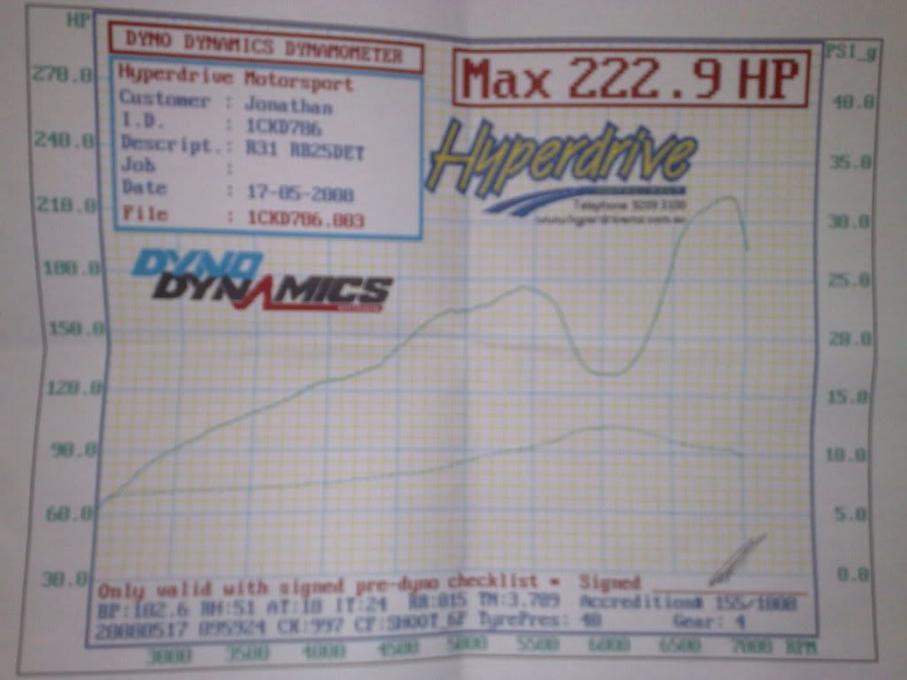

Before you all jump on the band wagon and get upset about the numbers, for me the peak is irrelevant. So lets pretend its normal and just look at the lines.
As RB25DET's on our dynapack hub dynos give more or less similar readings.
One more thing to point out, it was run in 3rd gear because it was hitting speed cut. Both the lower, and upper were run in third, and the torque works out to be around 353nm :blink:
So what im wanting to know, is what is the flat spot in the curve? And the drop in the curve on the lower line?
The upper line is after a light SAFC2 tune and about 5" advance across the whole rev range. So there was a definite improvement from around 4200rpm up, and it improved the dip.. if you can call it that.
Would this be the AFM maxing out? or could it be something else?

stock ecu gayness, just what it does with more than standard boost. some people say you have to be running 12+psi, but realistically its different in every application and it comes down to overall airflow. this is my dyno grap when i had a stock ecu, not how as it started pulling timing the boost rose which had a snowball effect and made the ecu pull even more timing

unfortunately the std ecu has a huge dip in the ignition value on higher load areas of the map (R34 is worse) and your safc can do nothing about it as it only manipulates the airflow meter signal to the ecu. You need a ecu that allows ignition control.
If you follow the blue fake trace i did in paint across the r33 std ecu ignition map you will see the timing goees 26 - 22 -16 - 14 -20 - 28 and the bold timing figure give you that dip. Once tuned you smooth out these timing dips and bingo nice smooth power delivery.
Bear in mind my trace is rough and is only an example it wont correlate exactly to your rpm scale as i dont know the exact ecu model in your car and the timing scales are slightly different between ecu releases but the underlying issue is as described above.

We used a wideband, the AFRs looked fine there - Status' comment about timing explains a lot.
Cheers Status, that was very interesting! Strangely enough, my Skyline never did the same thing - however I don't believe I reached the airflow levels GotRice? is.

Yeah if you can hold it one load point lower (where yours probably was) it will make more power and no dip :3some:
the trick is to increase the boost until the dip appears then back it off and tune the safc there.... it will generally make more power on less boost.

Its been well established that its nothing to do with AFRs - Status posted up what the timing does at the rpm GotRice? had issues, and the S-AFC does not allow adjustments to timing and his AFRs were stable and sensible anyway so getting all bound up on S-AFC settings is creating a red herring.
