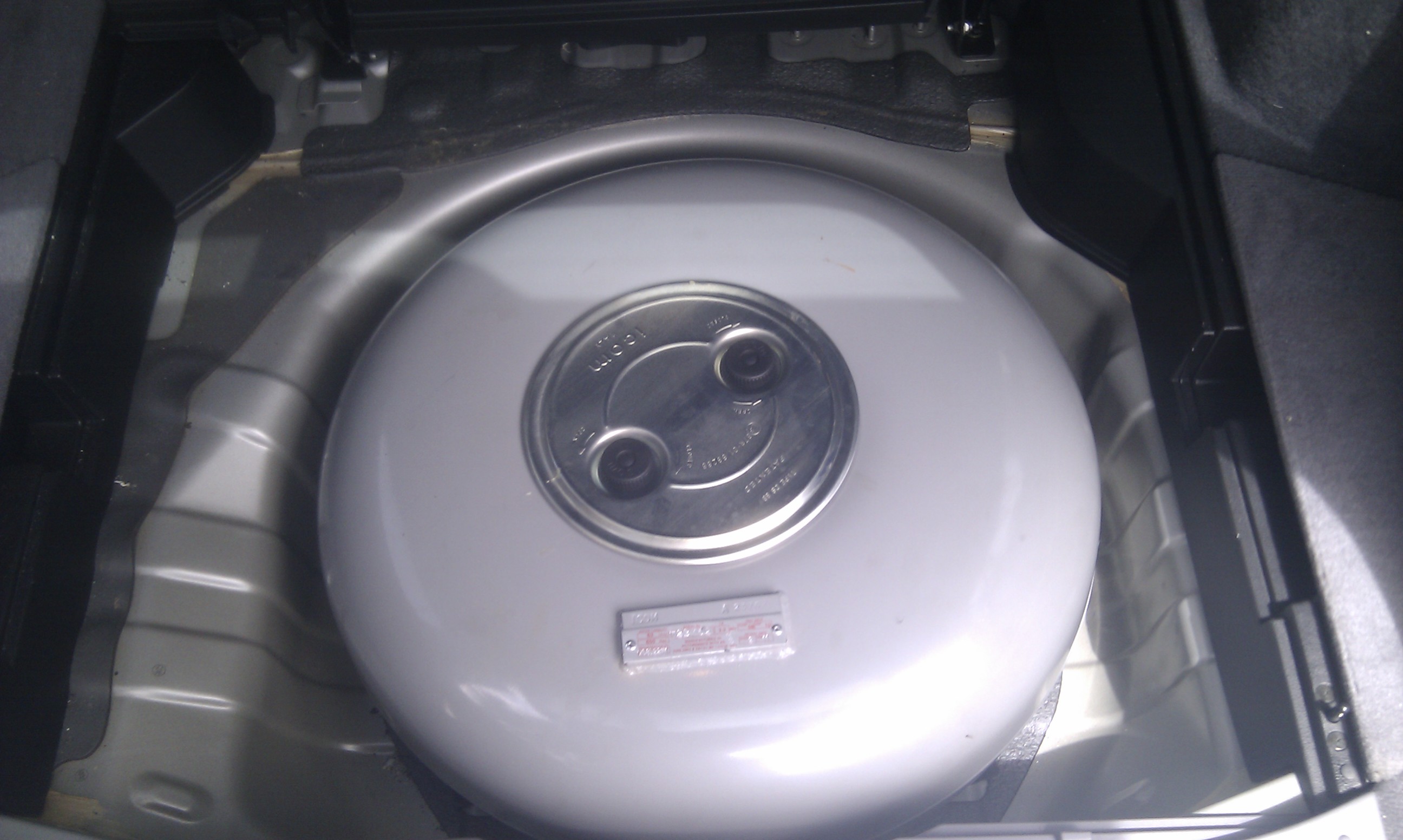

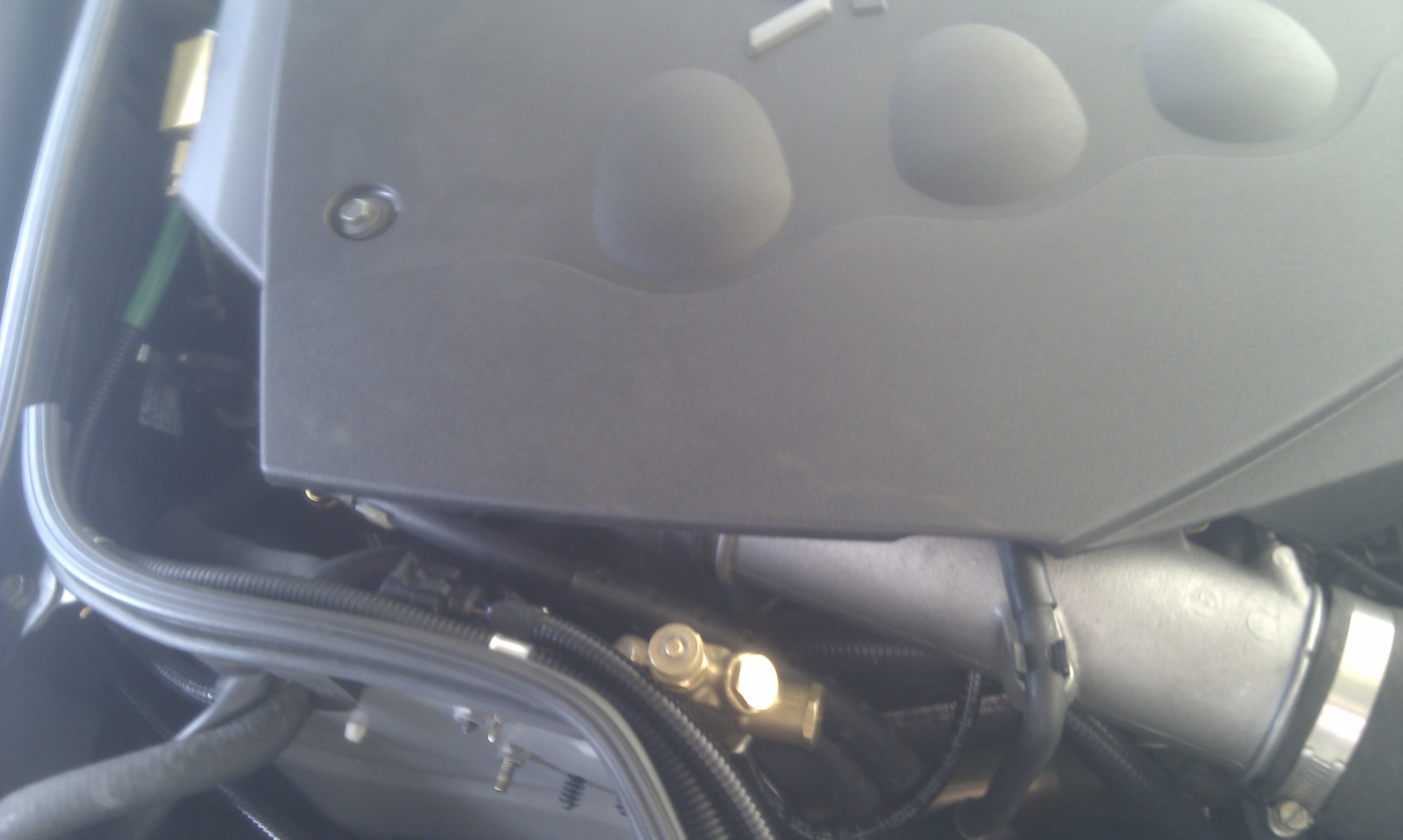

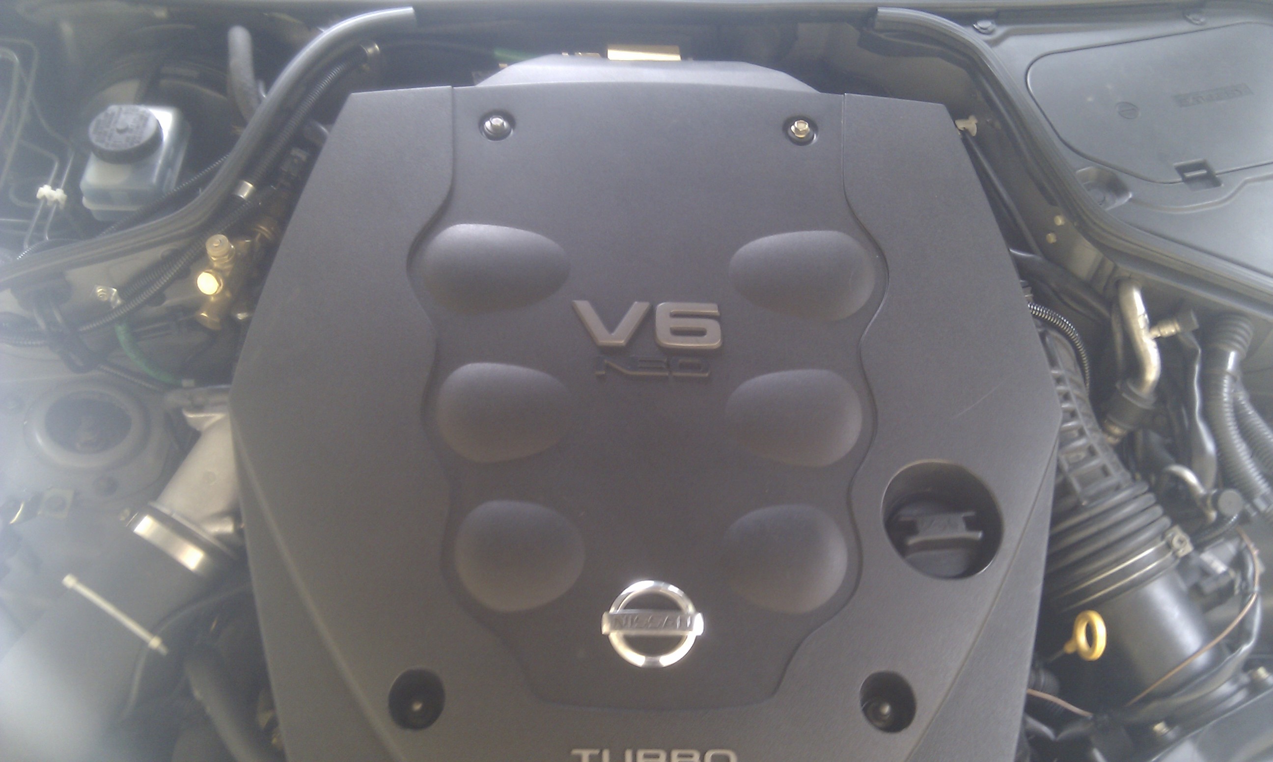

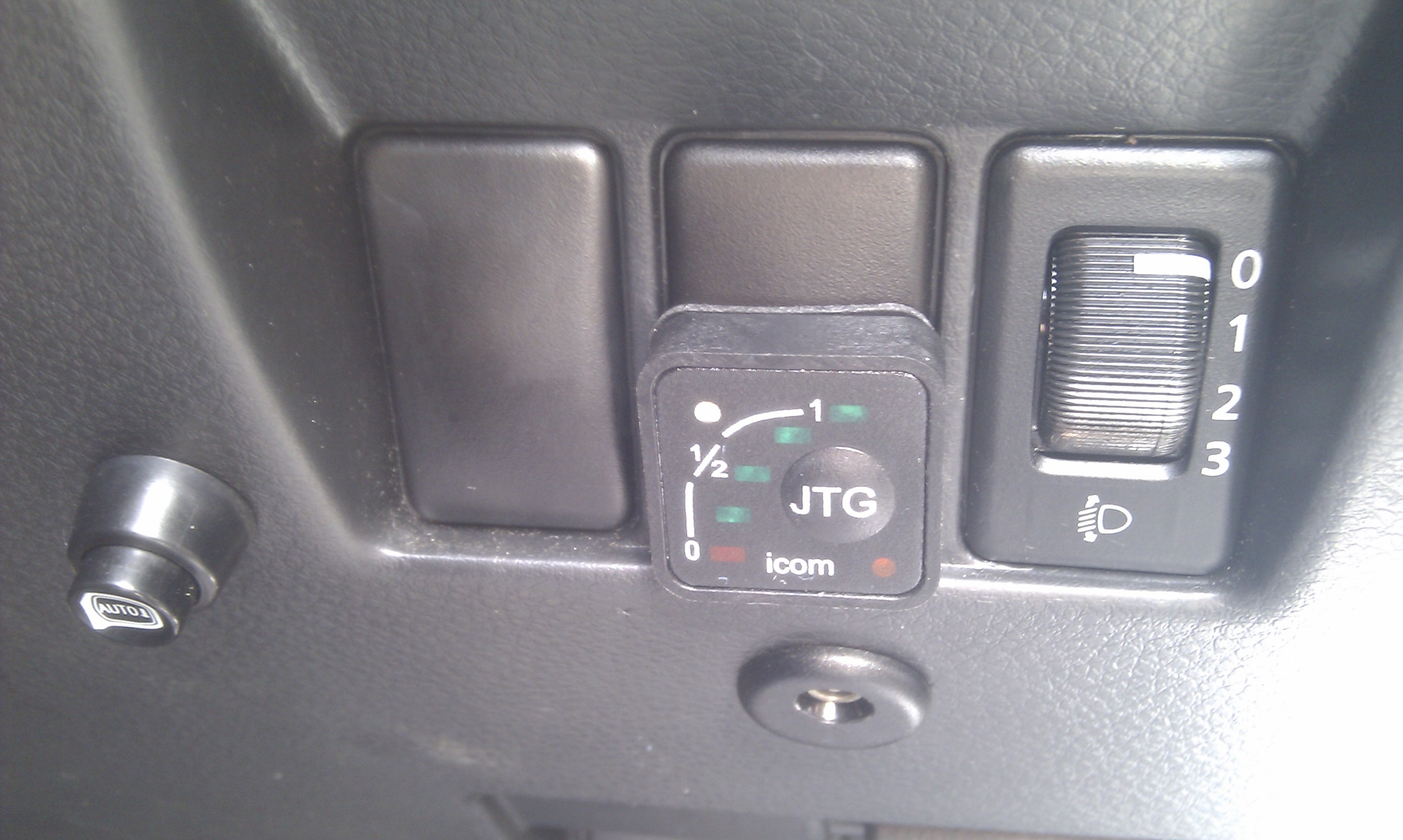

DONE!! M35 now on liquid injection! Tamme at Seaview Auto Gas conversions in seaford was great!
So now what everyone is curious about how do i like it..
well...
its f*kn awesome! i swear the car feels smoother on this and pulls harder than it used too! id say 10% feels about right from my asscheck dyno.. if the volvo made %14 more grunt then i guess it should be about right..
to be perfectly honest if no one told me i wouldnt have picked it was on gas at all.. it just feels exactly like petrol except that even though it 21c on the drive home it felt like i was driving it on crispy cold morning at 5am..
idle is perfect and so is everything else.. start the car cold on petrol then after about 30 seconds you hear a beep and your on gas.. cant even feel the changeover.. they did a sweet install and spent a little bit longer to ensure the plastic covers all went back on.. they even managed to get the gas filler just under the petrol one so all nice an tidy.
and the best part of it all?
$30 for 50Litres! (61c per litre)
vs
$74 for 50 litres of 98 octane (1.48 per litre).
also asked him about making the injectors flow more if you put on aftermarket ecu he said not a problem.. prob an hour or so to change the nozzles on the gas injectors.
couldnt be happier.
some pics below :)
