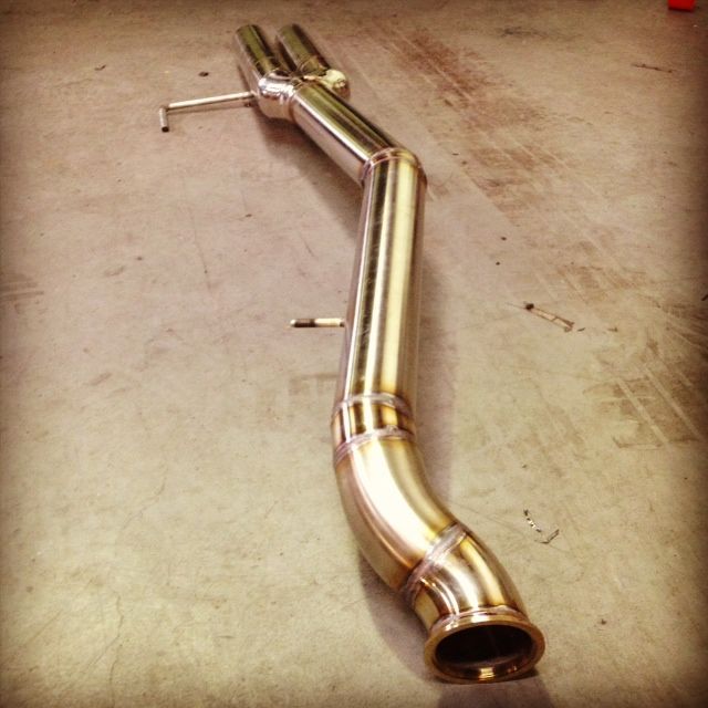

P.S the exhaust system pictured is one i just finished welding up for an S15, im going to be doing mine similar to it.

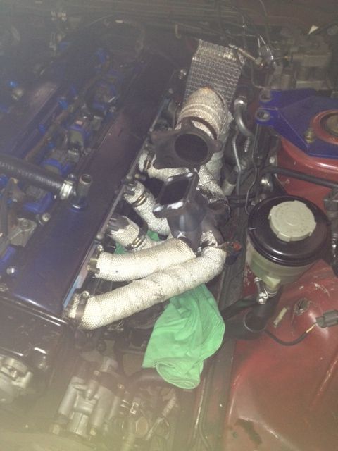

This is how the engine bay looks currently:

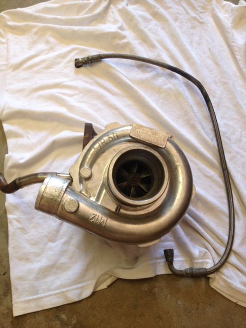

Goodbye old turbo!!

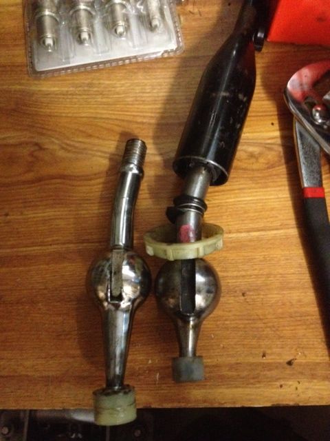

short shifter Vs stock shifter
exhaust system i welded up for workshop one in carrara on the gold coast, highly recommend their workmanship towards all car mechanical servicing and rebuilds etc.

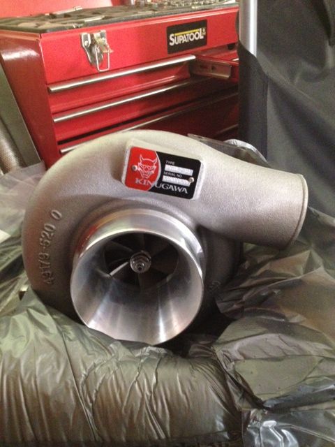

So my new turbo arrived yesterday! only took 3 days! was pretty stoked so i started going at it right away, ill let the pics do the talking.
everyone takes photos fresh out of the box......right?

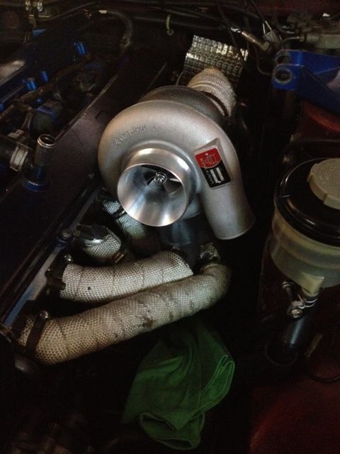

test fitted it onto the manifold, very tight fit but still fits none the less.

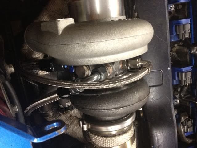

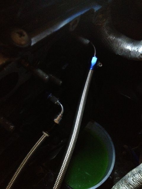

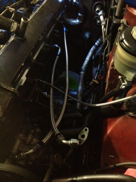

Made up some braided lines from aeroflow
another pic of the braided line set up.

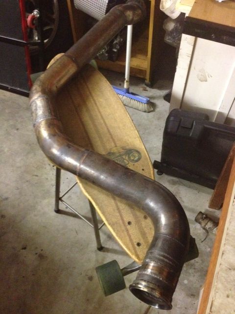

Also finished fabricating/welding the v band onto the dump pipe and test fitted everything. now i have to begin putting everything back together and get a dyno tune.

Hey mate curious as to why you took the shrt shifter out? Not strong enough to use on track/vulnerable or??

Thanks for the feedback mate, I took the short shifter out because it was getting a bit notchy. Standard shifters are awesome!

Ah yeah nice bro! I was thinking of putting a short shifter into mine seeing they're pretty cheap, but yeah the standard shifter isn't that bad and I see a lot of people end up reverting back anyway. And apparently they aren't the best for tracks anyway.

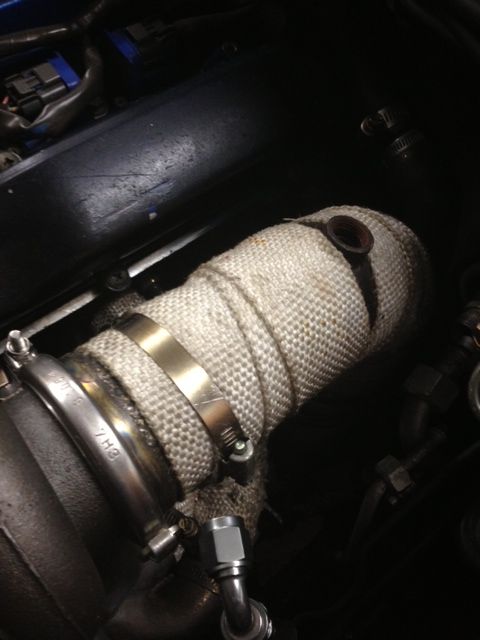

first off i modified the dump/front pipe to suit vband:
new heat wrap on the dump pipe.

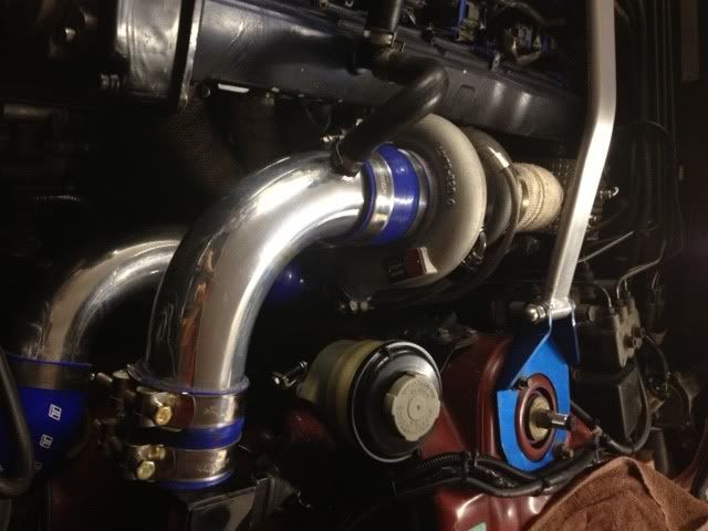

Got the turbo in there, started hooking up the braided lines:
just clears the rocker cover

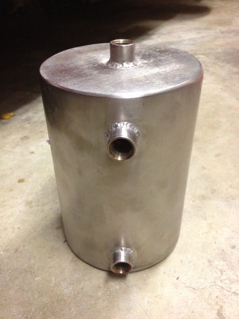

Im also selling this custom surge tank i made up:
Make an offer if your interested :)

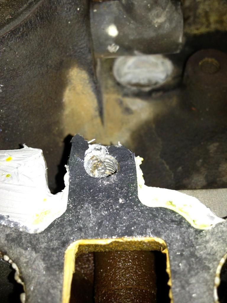

not a good update, but still an update none the less. I had one job left to do on the car which was to apply thread sealant to a inlet manifold bolt that was leaking a bit of coolant, so i took the bolt out.....cleaned it, cleaned out the female thread on the head of old sealant as best i could, applied new sealant to bolt and as i was tightening the bolt up with a 1/4" ratchet i hear a loud CRACK................thought it may have been the ratchet slipping a tooth or something as the bolt wasnt tight at all......tighened the bolt up, let the sealant set for a while and put coolant in the system.....this is where i found out what the crack was....it cracked the female thread on the head....major FML situation...so i have started taking everything off to get the head off....
While the head is off i will be getting it serviced along with a new cometic gasket set and ARP head studs. Atleast ill be able to run more boost knowing i have a steel head gasket in there....anyway here are some pics.
cracked thread:

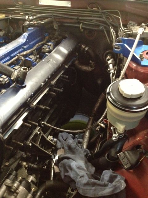

UPDATE:
This is now how the engine bay looks :(
