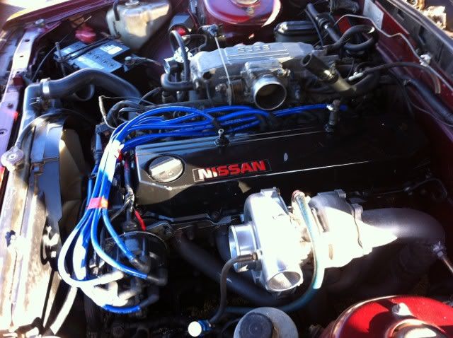

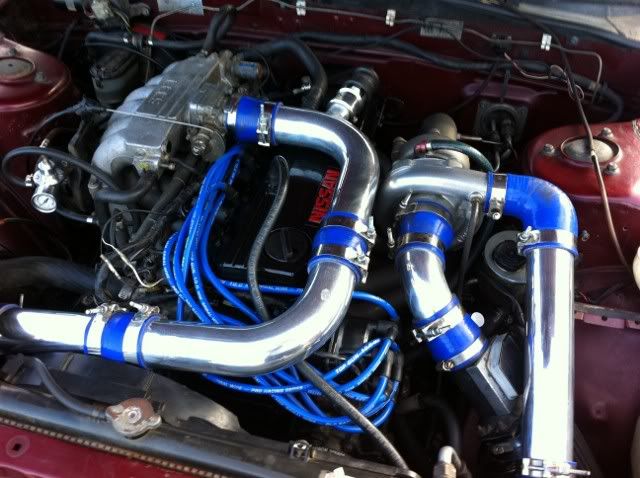

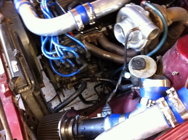

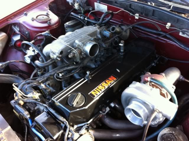

on another note i decided to clean out my pig of an engine bay today
here is before!
and some during
and the after lol

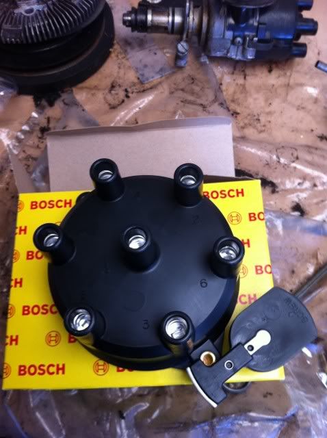

Unfortunatley I discovered that my distributor if f**ked and would explain y it misses every now and then, and sometimes runs like a pig lol
i clead out all the green rusty shit and my god it runs smoother just with that but still, the rotor button is rooted any suggestons?
put in a new distributor cap and rotor button today runs sooooooo much smoother, no noises anymore no missfiring great to downshift in
its a great car to drive now!

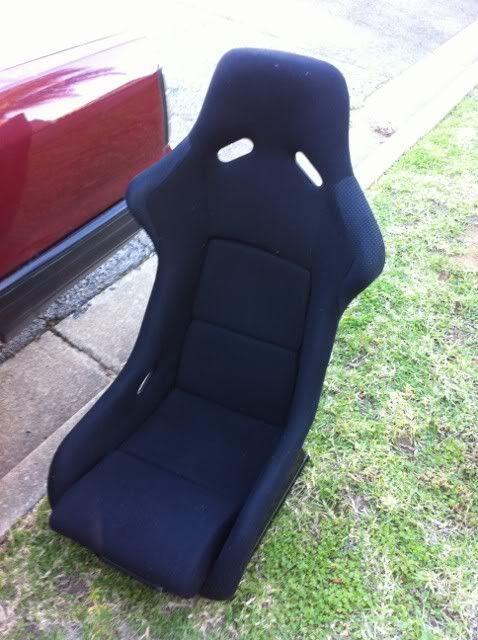

got myself a bucket seat today, suprisingly was easy to get in,
ripped the rails off my standard seat welded the bucket seat onto the rails and chucked her in!
Seat sits niceley and welded SOLID to the rails all the way along
will put some pics up of it in the car tomoro
