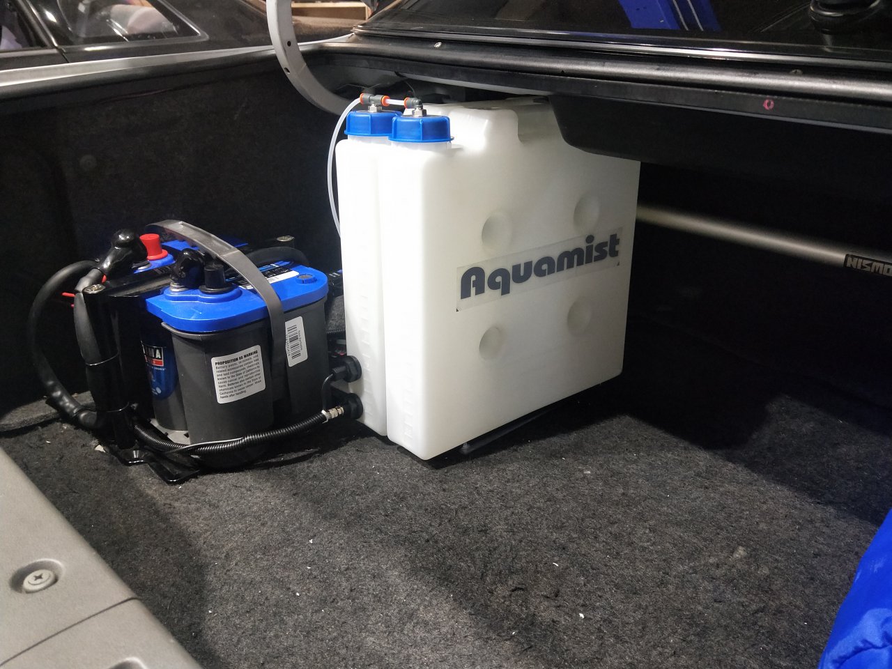

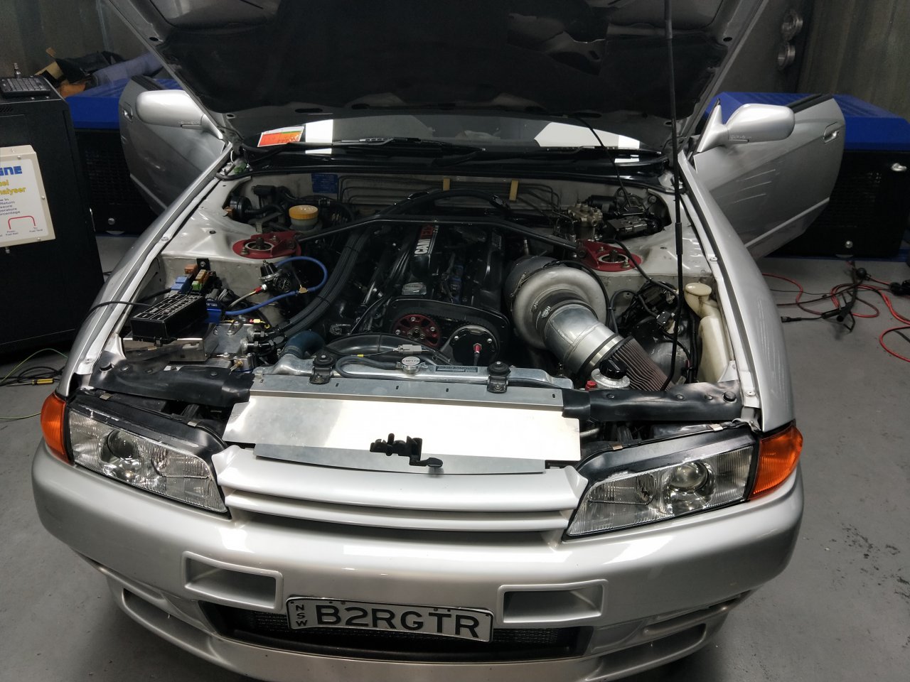

G’day guys,
Had an enquiry earlier in the week from a member who has been following this post so thought I’d share some updates.

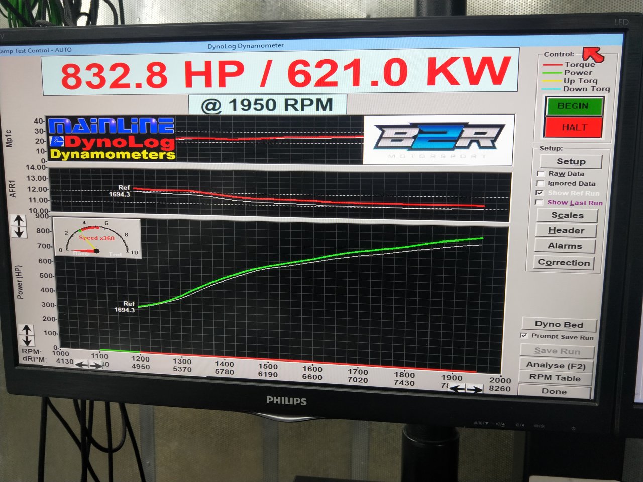

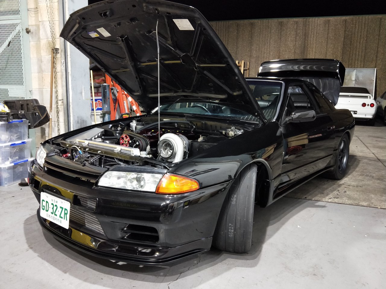

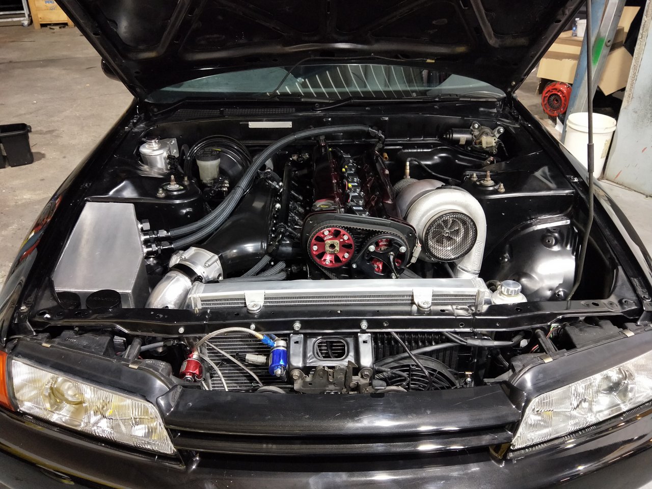

In one of my earlier posts, I mentioned that WMI and E85 would be a killer combo. I recently got the opportunity to test this theory after installing water injection in 2 R32GTRs. The first car ran a stock bottom end RB 26 with a big Precision turbo. On 27 psi, it made 800hp. With 500cc of post intercooler WMI it made an 830hp, will power remaining consistent on back to back pulls.  At the Cootamundra GTR drag battle, with ambient temps of 30 degrees, the car ran very fast and consistent times, the quickest being a 9.97. The maximum intake air temp logged at the end of a run was 33 degrees.  Under the same conditions without the WMI, intake air temps reached in excess of 90 degrees.

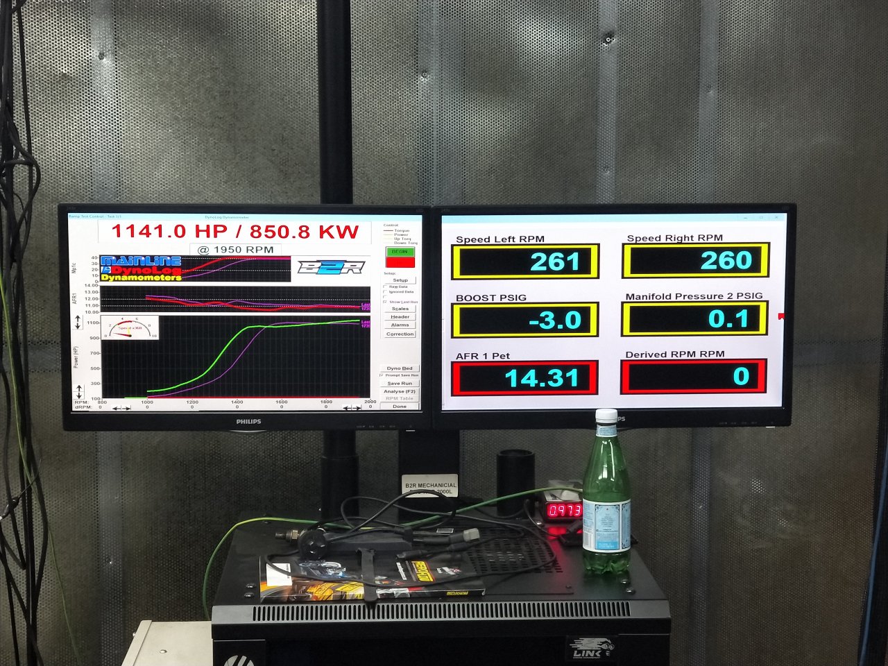

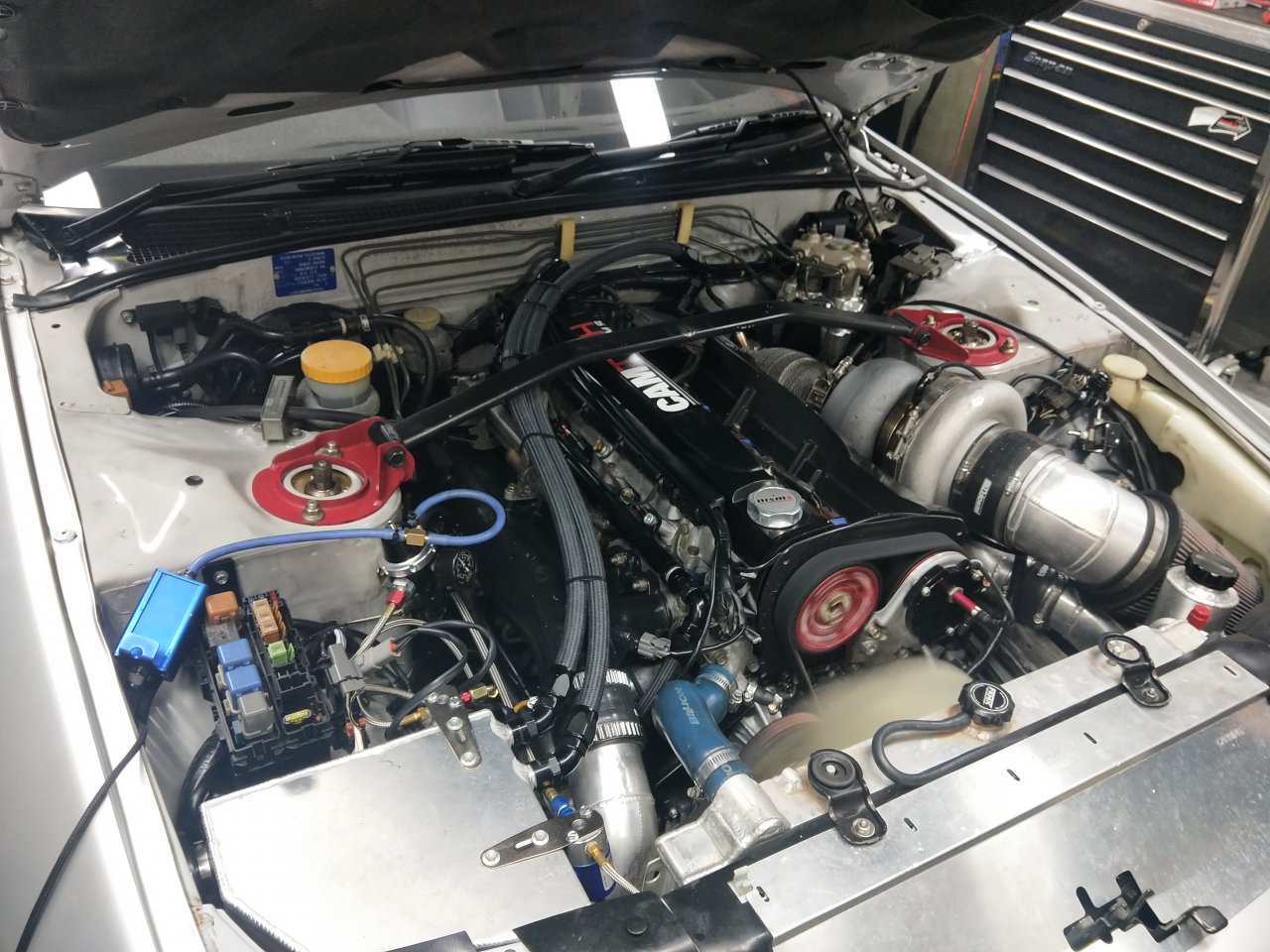

The second car runs a RB 3.2L stroke bottom end with a 26 head, an 8582 precision turbo and a turbo 400 auto conversion. On 40 psi boost, it made 1078hp. With the WMI activated, 7% fuel trim and 2 more degrees of ignition timing, power increased to 1141hp. This car is yet to be track tested.  I’ll post the results once they are in.
