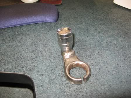

I've got an NTK sensor coming in the mail so thought I'd do a trial run removing the old one. Searched thru my shed and comfirmed I didn't have a long 22mm tube socket to butcher. I chopped the ring end off a spanner with the notion to ground a slot for the wire, got worried the thing might flare if it was really tight so beefed up the around the ring with a build up of 309 stainless rod (cut the slot after this), next welded a socket to the short handle left on the spanner - more good ol' 309 rod.
Meanwhile the sensor area had a soak in WD40, fitted up the spanner - this thing is good because it gets you back away from the firewall & abs pipes, medium length extension & a 1/2" drive rachet. The thing hardly put up a fight - like a tightish spark plug really.
I'm assuming the old one is factory & surprised it's a Bosch, partNo A24-A21139 72131
Here's the tool:
Here's the tool:
Good job! How much to make me one?
Ha, I'm down to one 22mm spanner now and not so sure I want to start a tool shop here, thanks for asking though. There in lies my failed businessman approach to life & working for the man.
