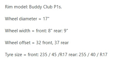

ok so if i wanted to go 18's i would go for 8's  in front 30+ or 32+ off set at front and the back 9 would be ok? what offset should i aim for.. then can i do some  hunting for wheel rim choices..
If i get this - will this fit all around:
Size: 18 x 8.5 +37 - n what tyres size tyre should i get for front n back?
Edited by Black_CSR
8.5 +37 = should fit rear, but I think it'll hit on front.
What you want is low 30s/high 20's front, mid 30's rear. That 17" screenshot you posted looks good, I'd run it on my R32 (but that's long dead now).
For tyre sizes, my rule of thumb is: 8': 235, 9": 255. But that's just my opinion.
Nismo sizes: 18x8.5+35/18x9.5+38 is a good starting point.
