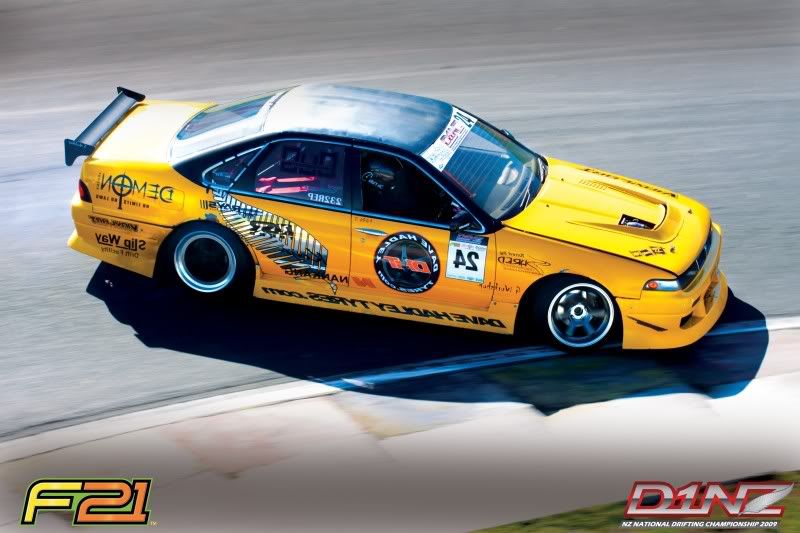

Pretty good results guys, this is one of our drift cars built on a limited budget, survived two seasons in D1NZ plus specialty events, before it dropped compression on number one cylinder, we replaced the entire engine with another StageA RB25DE with around 70,00kms (nicely run in)and back to banging the limiter. $300 for the engine, cheap as chips and easy to replace, I would not go to another rebuilt engine unless it's a VK56.
It's all in the tuning.

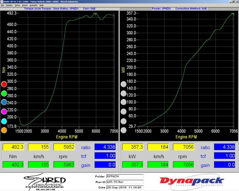

Model - R33 GTS25T
Engine - RB25DE
Modifications / Parts Used - WGC34 RB25DE Engine, unopened 140,00kms. DSR 3540 Turbo, 800cc injectors, FFPlenum, with standard turbo throttle body, SS Top mount exhaust, 3" Turbo back straight exhaust with cannon muffler on the rear 5" tip, 44mm wastegate, 1 bar of boost
Engine Management Used - Plug in G4 Link, Tuned by Shred Motorsport
Fuel Used - Alcotane E85
Boost Used - 1 bar
Dyno Tune Results
Power- 479HP/357kw @ 7056RPM
Torque - 492Nm @ 6000RPM
Misc- use engine from auto car any RB25DE will do
Costs - Parts: $4k Labour: $by self Tuning: $sponsored, Dyna Pac Hub Dyno
Dyno Graph

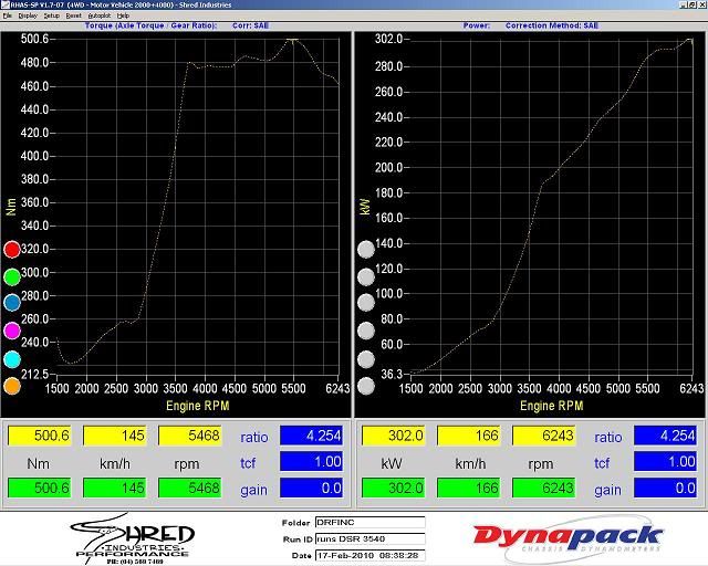

I ran this engine in my Cefiro Drift car for two seasons plus specialty events, the only problem was my final drive gearing was a bit too high for some tracks, I was using 4.3:1 locked diff.
Model - A31
Engine - RB30 with RB25DE head
Modifications / Parts Used - R31 RB30E Engine 240,000kms, RB25DE head . DSR 3540 Turbo, 650cc injectors, FFPlenum, with standard turbo throttle body, SS Top mount exhaust, 3" Turbo back straight exhaust with cannon muffler on the rear 5" tip, 34mm wastegate, 1 bar of boost, relocate cambelt tensioner, RB25DE oil pump,
Engine Management Used - Plug in GTS Link, Tuned by Shred Motorsport
Fuel Used - BP Ultimate 98
Boost Used - 1 bar
Dyno Tune Results
Power- 404HP/302kw @ 6243RPM
Torque - 500Nm @ 5468RPM
Misc- use engine from auto car any RB30E will do
Prevous setup was with T3T4 and standard injectors and 265rwkw can't find the dyno pic?
