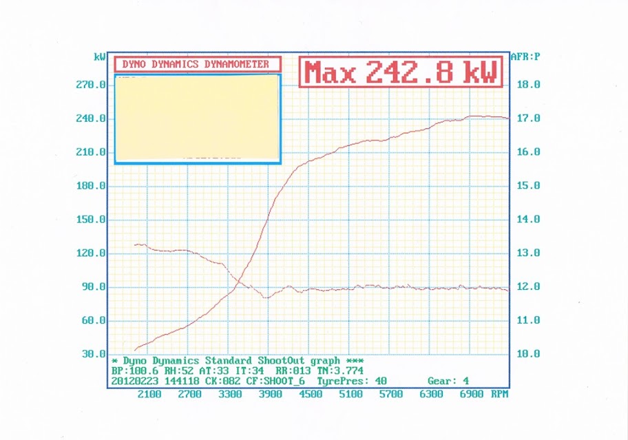

-Even with the new power, my chassis setup can easily handle it, you can still wring the car out pretty hard even with 240+rwkw and it feels like more power would be better ;)

So.... dropped it back to the tuner today to get it re tuned with the lower pressure actuator, and he found that the actuator that the ss1pu came with had already failed. It was getting randomly jammed open/shut hence the car was sometimes running too much boost when it shouldnt. This would explain the random pinging.
He also found that the wastegate flap seems to be fouling or is jammed since it can only open about 5mm and said this is not normal. He has removed the dump pipe to investigate.

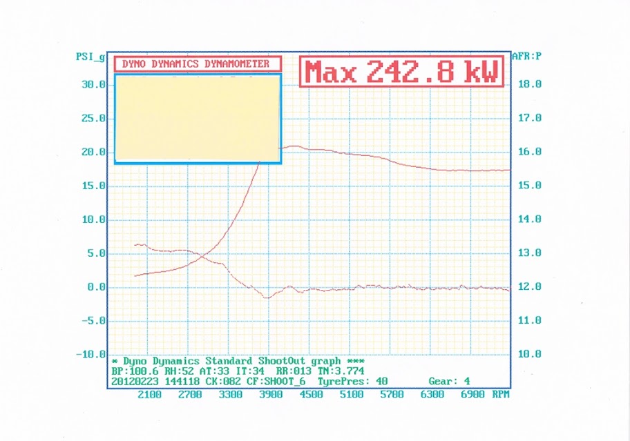

Boost ramps up from around 10psi to 21psi extremely aggressively, this is what makes it want to ping.

-I believe around 10rwkw is being lost compared to the average tuned car due to the tyres. Im running Federal 595 RSRs, they are very soft and sticky when hot. A mate of mine tested his car with then, tuner said its down on power blah blah and then he changed to normal tyres, went back, made normal power, around 10rwkw more.
-The reference graph showing 280rwkw is deceptive, without going into detail I dont believe this is and accurate reflection of how much power the turbo will make for most customers, I did not expect the car to make 280. Even Stao himself is now saying it will make around 260 and I believe this is closer to the mark for this turbo and the majority of cars/dynos.
-There is something else holding back the power on my car but I dont know what it is yet. I believe this is so because on the hypergear reference dyno graph, the turbo/power tapers off at 17psi@5500rpm. If you check my power graph you can see mine only tapers off at around 17psi@6800rpm, the turbo does not max out in the same way, it has more to give.

I took a video where a friend takes off normally and shifts slow into second, revving it out in each gear. Having a closer look at it, I realised that even with the slow takeoff and shifts we hit 100 in 5.x seconds! Ill need to hook up the pbox and do some testing ;)
I have been in plenty of cars with similar power levels and to be honest although the graph shows 242rwkw, it feels like more than that on the road.

Did u notice the boost gauge overboosting or underboosting?
Powerfc. Yes, the gauge did show the boost going way over 20psi however I figured the gauge was showing wrong since its only a 20psi gauge so it was maxxed out (when it was tuned it was hitting 21psi from the actuator only and now it will hit 24 with no other changes)
However... I must say that during the only big 300km testing drive I did I pretty much never looked at the gauge, had my eyes glued on the road. Sometimes it felt like the car was down on power but I cant say if that was in my head or not.
Since the car started missing gradually more and more after the tune I think the extra boost would be contributing. On my long drive, it did stop missing for periods and then would start again which makes me think it was running inconsistent boost.

Check the wasetgate it is operation by:
1. Use compressor, Shoot air into the actuator while still on the turbocharger assembly, check the movement from the wastegate gate.
2. If wastegate james, remove the actautor, shoot air into the actuator and see if the rod moves back and forward.
3. if the actuator operates check and make sure its not fouling on any parts of the bracket or parts.
If the actuator does not operate under pressure then it would be a faulty actuator which will go through warranty. Which I have not seen one failing so far.
And check to make sure the exhaust studs is not too long or it can possibly foul on the wastegate and catches it on the thread that makes it jam.
