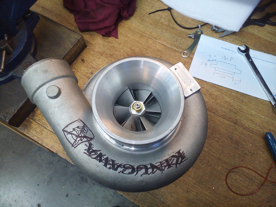

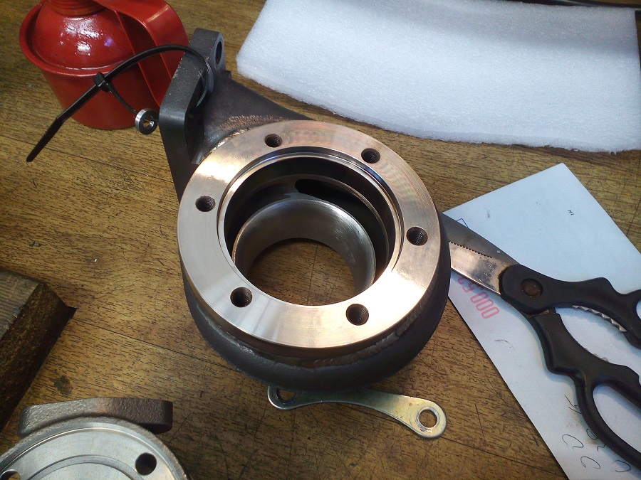

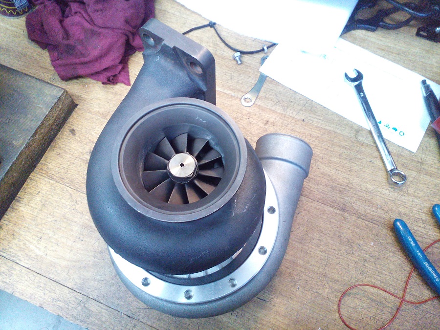

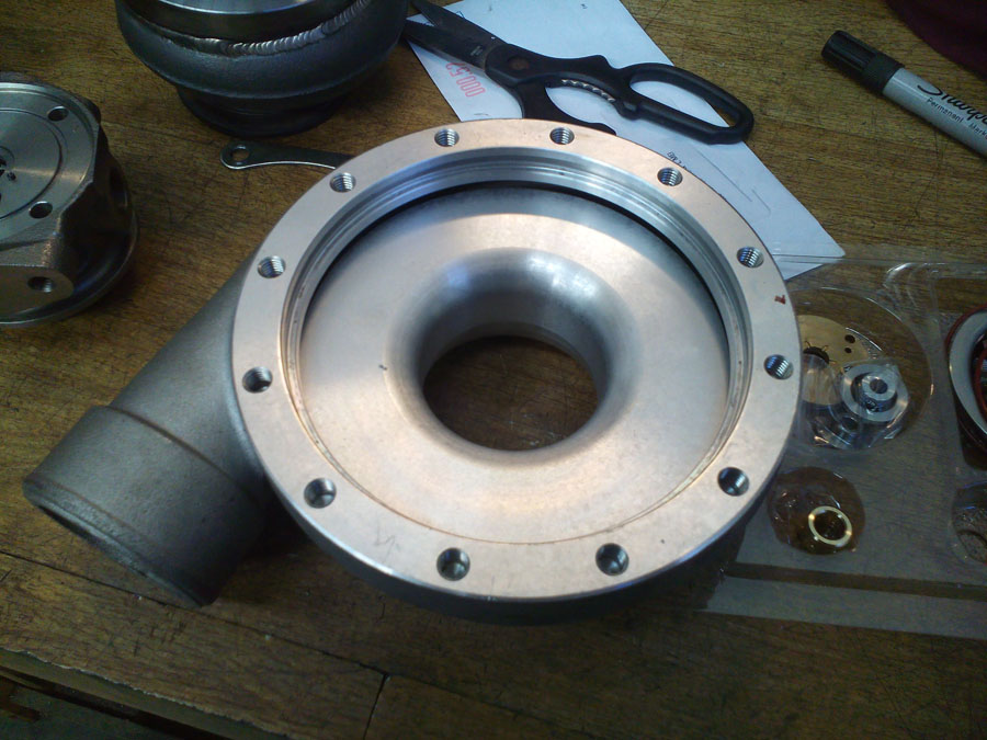

This is result from the Peter's dead T67 earlier, It is now rebuilt and high flowed running our ATR43G4 CHRA assembly, pulled 404awkws E85, fuel pump leaned out. Its now tested and ready for pickup. This assembly is good enough to pull around 430awkws with a new pump. I don't think I will be chasing for more power at this stage, But will be working to get better response.
