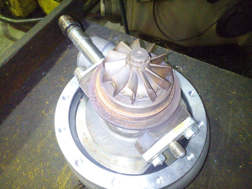

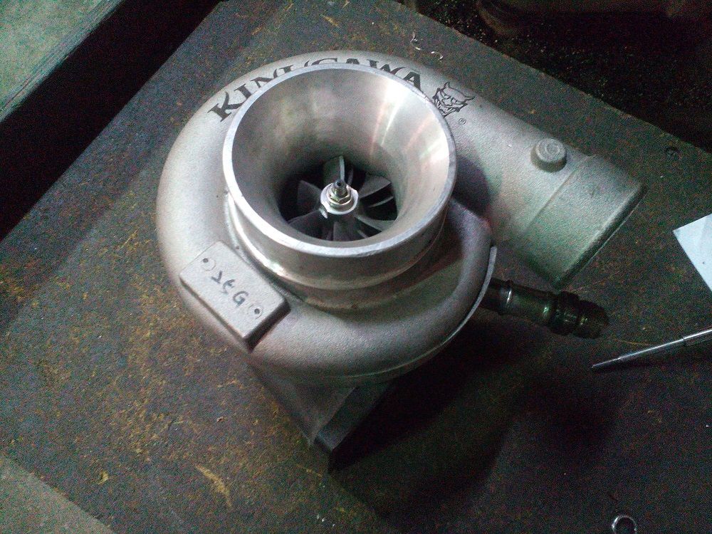

Stao, I've got a blown kando T67 out of my track car. Looks like the wheels have eaten through its housings. Is it worth fixing? and what are my options. Thanks.
You have lost two Kandos now yeah ?, given you have lost two and others have had them running for years without issue I would say there is an oil supply or drain issue in your setup somewhere at some point and that needs to be found and rectified if you want to continue using the Kando turbos or change to one that doent mind oiling issues
Its the combination of the 25G compressor and L2 turbine don't work on Rb25dets due to the level of its its back pressure. On the same time it depends on how much boost you run through them and how hard car's been driven. I have repaired a few, the simplest options would be dropping in an SL20.5 CHRA with comp housing into your existing turbine housing, it will be making the same amount of power with much better responds as your T67. It will cost you $850 to carry it out.
Alternatively we can make some thing that suits the 25G compressor wheel by using our 75mm SS-4 turbine wheel. It will be capable of making around 430rwkws E85, It will be laggier. This option cost $850 to carry out also.
I'm using the hose kit that came with the turbo, my exhaust is all oil soaked, its got plenty of oil flow. My daily run a Atr43ss1pu at 20psi over two years no problem of what so ever. Stao I'm sending you my T67 for the 430rwkws rebuild. cheers.
