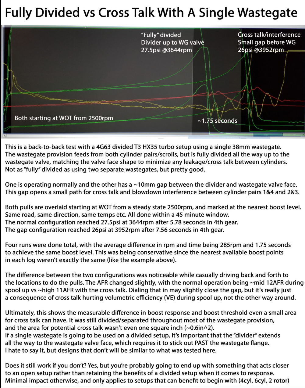

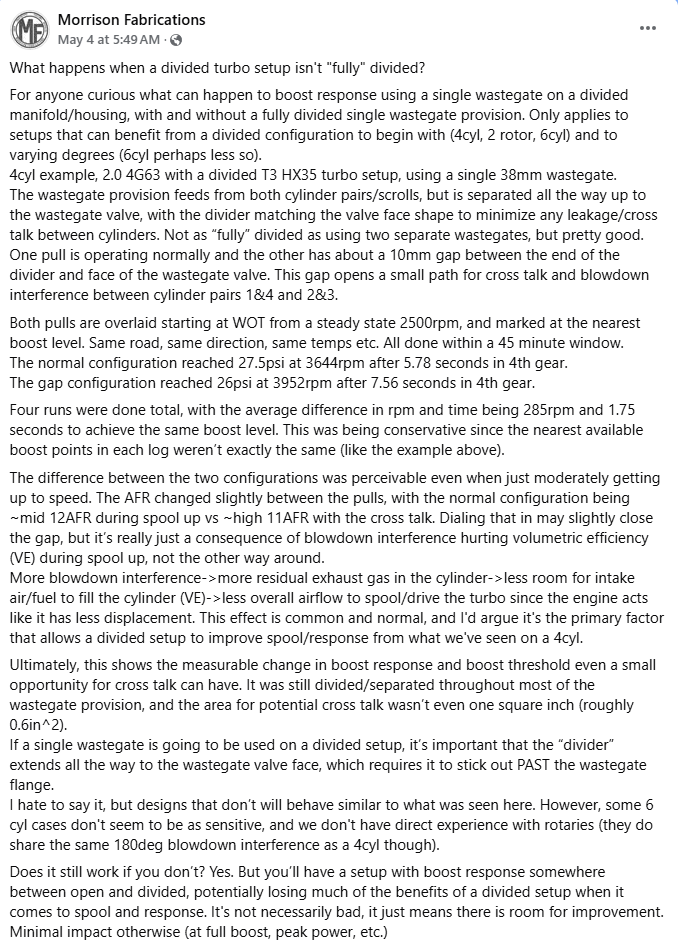

better do the twin scroll properly, here's a good read
https://www.facebook.com/share/p/1XrYzd1jk7/
And screen shots for those that don't like Facebook:
