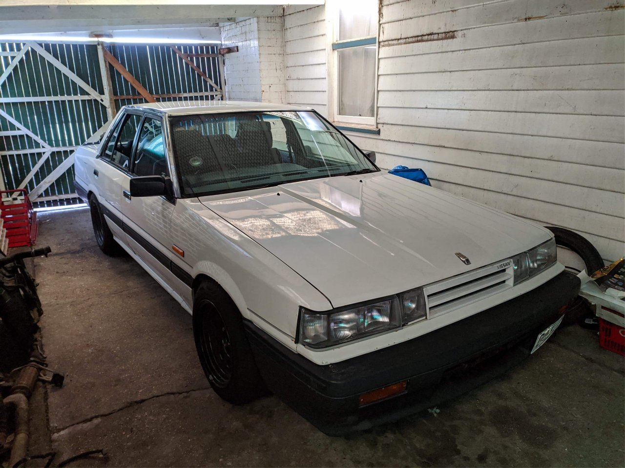

This is my R31 Skyline Ti that's turboed making around 300whp. It has been in Tassie for a while and has had a lot of owners and history. I sold it as I lived in Victoria at the time so I couldn't drive it and wasn't motivated to fly back on weekends fixing fix the sloppy RB20 box with no reverse along with various other small things. It came up for sale for close to what I sold it for with nearly everything fixed up. My plans with it is to replace the 3582 with a 3076, plumb up the screamer, make it more streetable and less of a defect magnet (take out the extended LCA's, plumb up the screamer pipe, get a radio and heater in it).
A little backstory, I work in Townsville but am from Launceston, the goal is to move it up here and have it as my fun car.

the car had the following upon purchase.
rb20det box
pintara LSD
s13 front end
s13 turbo brakes
s13 coilovers
cut and shut knuckles
extended LCA's
15x8 +0 D shapes
Bosch 044 pump
750cc injectors
decomp gasket
head studs
thick alloy rad
GT3582 .82 externally gated
Haltech E6X
front mount

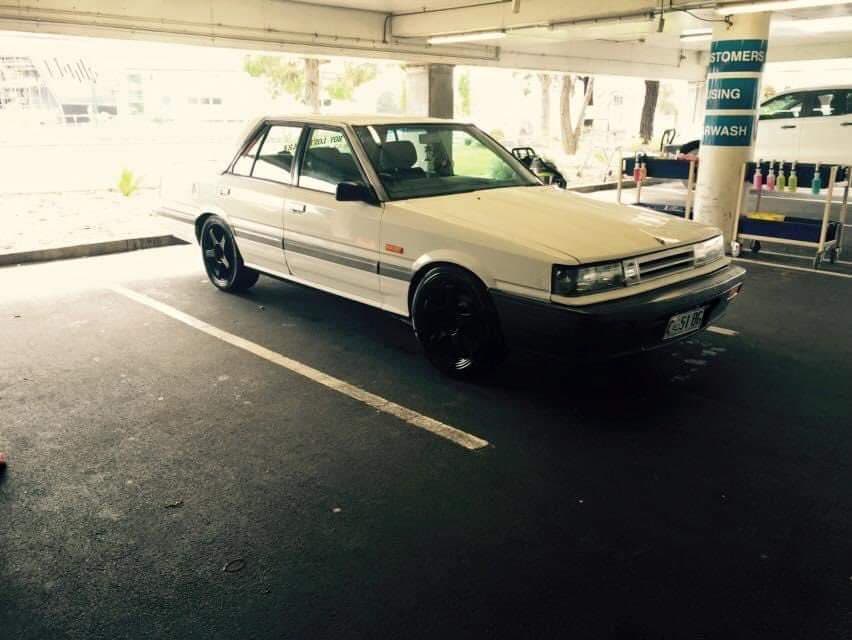

Here is a pic of the car the previous owner sent me - 5 years ago to the day!

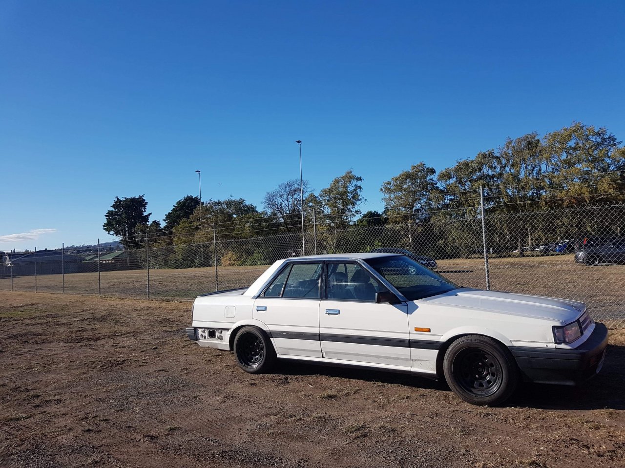

Here are some pics. Apologies I don't post super often. I try to keep the fourms alive!!
received_1092849904548162.thumb.jpeg.96ecf04aa36266655eb23c87d825b809.jpegreceived_777892046141360.thumb.jpeg.a37add724b7c99da66f37580aacd5999.jpeg1620037439080.thumb.jpg.85c3fc9af8ff18bce3559b6850223f5a.jpg1620037196034.thumb.jpg.e3b3add80fb64cc07a54f97639886cf8.jpg
