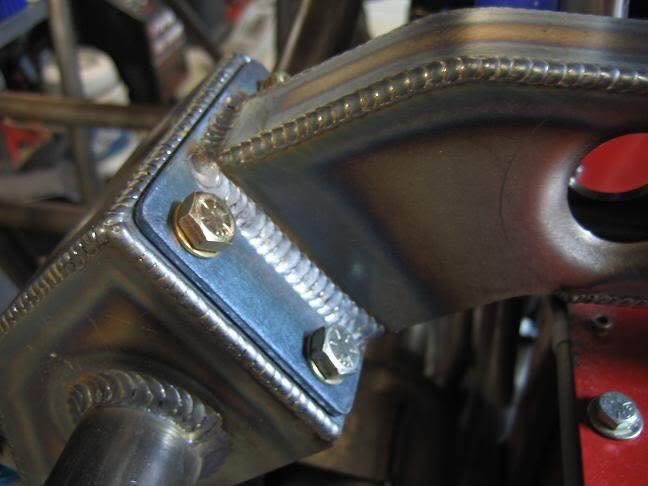

I was expecting all these beautiful welds, tidy fab work and paid for it to be ready to go to a tuner when I got it back.
I got a car back that was an absolute mess, I actually couldn’t believe it was my car anymore. I don’t think you could even call what he did welds, they’re disgusting.
So I stripped everything he touched off it and with every bolt I loosened it just got worse and worse.

Please excuse the bird shit horrible welds, I’ve got my show pony car and am so beyond dealing with this car I don’t even really care at this point.

I’ll attach pics of the shit he put on my car and the engine bay now as it sits

Jesus..... You're going to have heaps of boost control issues with that exhaust manifold.
Could you elaborate on that? Why?
Asking because it's not obvious to me and I always try to learn from posts here.
@soviet_merlin note how this is a twin scroll manifold and the "fabricator" has tried to make it a merge however I'm not sure he/she/it did very well at school and understand how gas/fluids flow.
And why re-invent the wheel? manifolds like these exist, and the merge is great, not to mention the pulses are split all the way to the wastegate's fire ring:

Don't use that manifold. Please don't use that manifold. Sunk cost fallacy is not worth the later pain.

my man (lead mechanic by trade) and I have done a heap of work as you can imagine just to make the hot side work with the dump pipe, stupid massive intake on turbo, trying to get the waste gate on was not fun.
Unfortunately effort gone to waste, you will have substantial issues with how the manifold and wastegate have been integrated.
You would be so much better off with a modified stock manifold like this:
https://hypergearturbos.com/product/rb25detexgatedmanifold/
OR literally just getting a off the shelf Sinco or 6Boost manifold as myself and others have mentioned.
