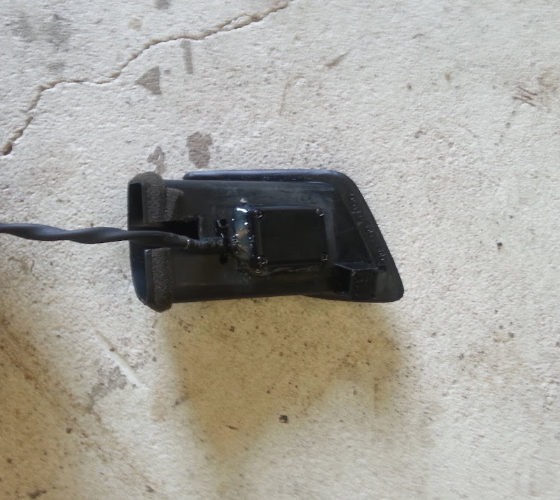

Shift light mounted. Hidden away in one of the A/C dash vents.
Super bright Cree LED so no issues with stealth install - it'll light up the windscreen at night its so bright.
