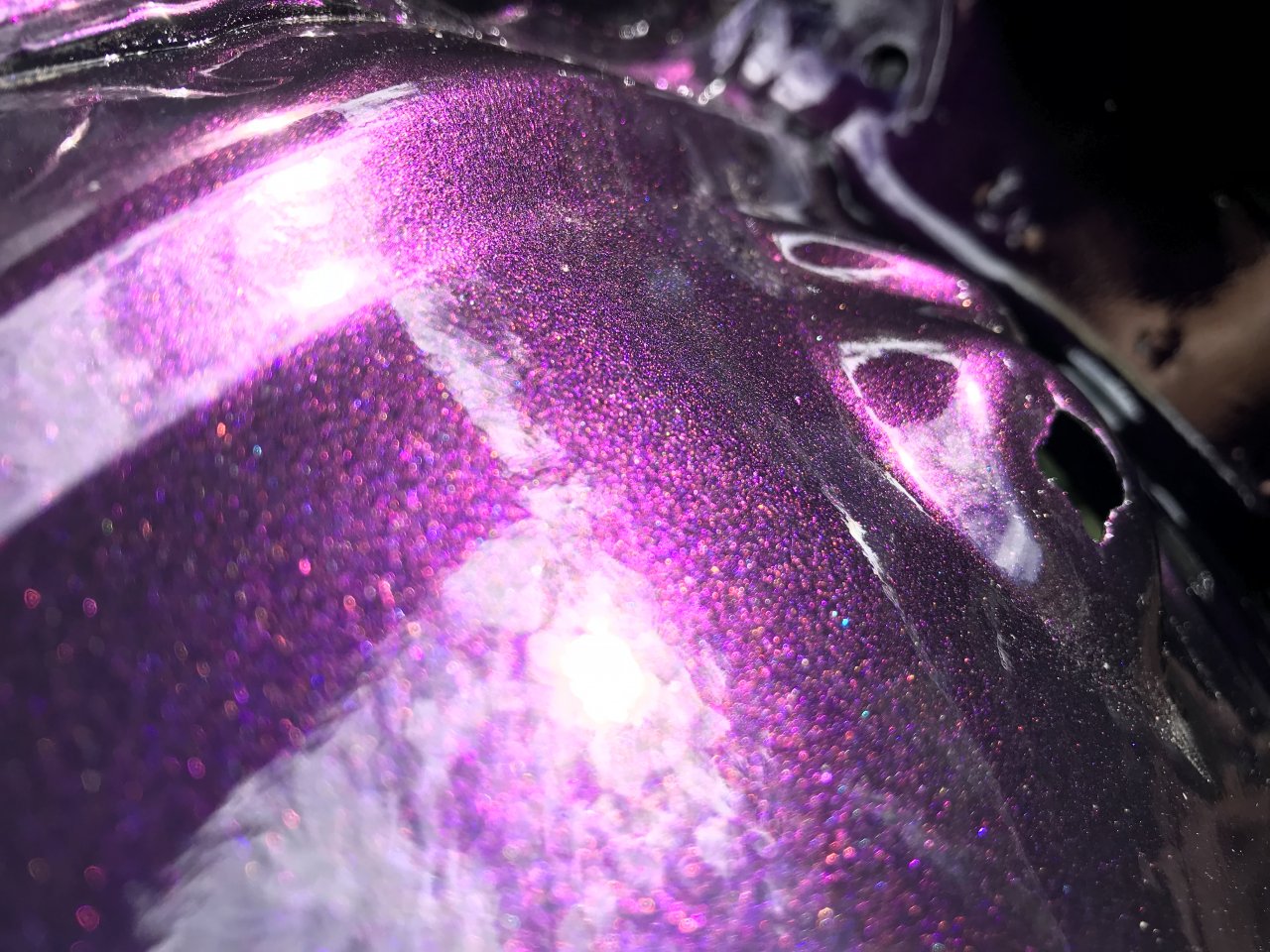

If/when I redo the whole car it would likely be the same colour I did the Engine Bay/Brakes/Cam covers in 2018. or something adjacent
On 1/26/2018 at 3:06 PM, CRSKmD said:
for my first time painting with pearl in a 3 layer job im pretty proud of what i managed to accomplish! the photos simply do not do the paint justice

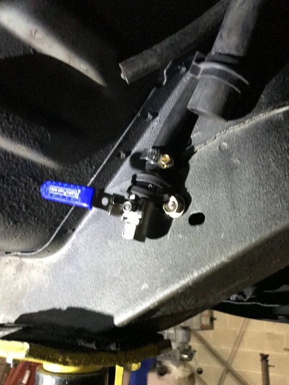

On 4/23/2018 at 12:52 PM, CRSKmD said:
also sneaky catch can drain
Yeah one of the first things I out in when I started having catch can filling up issues. Still prefer to empty 1-2 times a track day rather than every session
