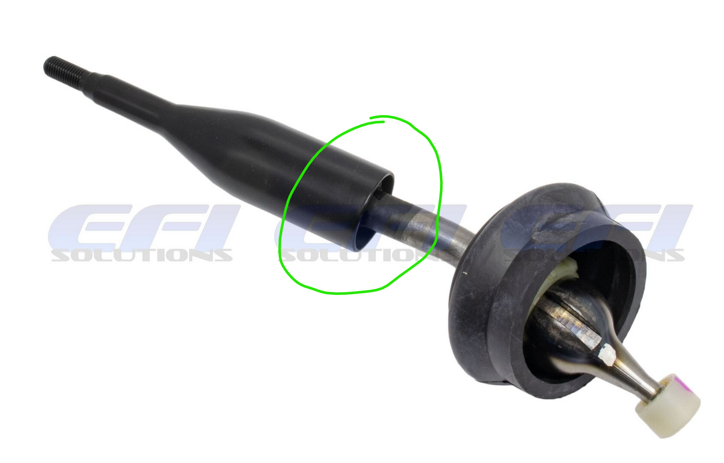

I recall saying it felt like there was flex in gear just after the selector fork snapped so i assume it as related to the part fatiguing. however with the spare box into the car with the same shifter before I noticed the amount of flex there is in the shifter its self.
I think it always had some given the nature of how its constructed with the rubber isolator in between but this feels excessive?
I do not want to install a short shifter and the only other stock throw shifter I have seen is the Nismo "Rigid shifter" for $290
So plan A is to fill it with sikaflex to stiffen it up and hope for the best
Plan B? Get someone to machine up a metal bush/collar/whatever it needs to be to replace the rubber?
I haven't had a close look at that part recently to have a proper feel for whether that's possible. But it might be easy.
the top black section is bonded to the silver section with some form of rubber. I assume to isolated NVH from the box
Plan A in progress.
  • Like 1
I forgot to come back to this. If the Sika is not stiff enough, and you can dig it back out (which should not be take for granted as being possible!), then I would try a 2 part polyurethane resin in a durometer a bit stiffer than whatever the Sika measures up at.
It would suck having to buy a pot full of it to use just a thumbleful, but whatever.
I used 227 which isn't super stiff probably should have used 252. but i had an open tube of 227 already.
also i'm sure it could be melted out with fire.
