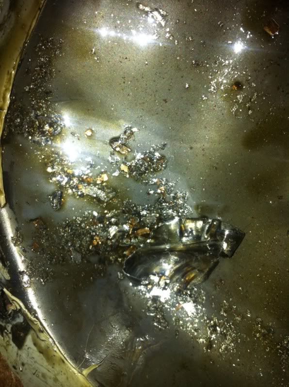

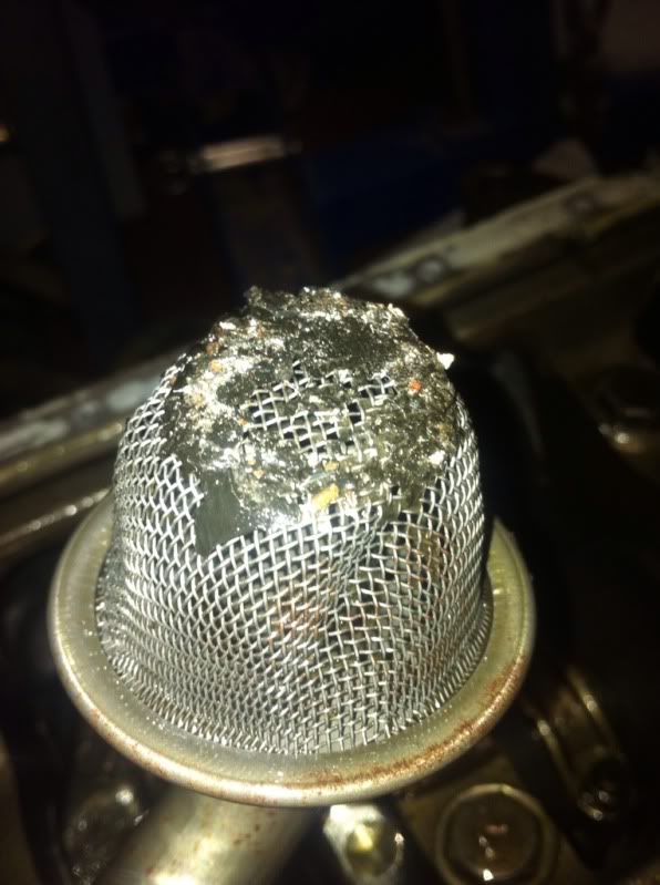

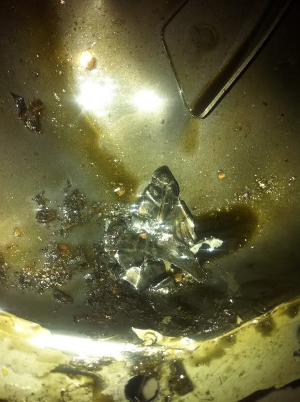

got my current blow up
a31 cefiro with rb25det.
complete rebuilt,arp everything, genuine gaskets etc, fmic,gt35r,std ecu and injectors.
currently have oil on top of 2 pistons,can see detonation on all the other pistons.
just turned the fuel pressure up, not to worried if it blows got a forged motor to go in.
RB25det rebuilt, used standard sump, n1 pump, no restrictors = problems.
All forged engine. Didnt go bang i removed it cause i was scared about the crank collar not being done. caught it in time. bearings were absolutely totalled.
Was running approx 280-290 rwkw for 8000kms. Alot of big numbers on hot days (45+ degrees)
Now i have 7.5 litre custom sump with baffles and gates, tomei pump, blueprinted crank, the whole lot and currently running in. I hope nothing goes wrong this time i really do.

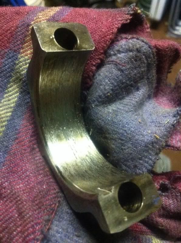

R32 GTR
failure-oil pump (that old chest nut!)
Number 6 bearing was f**ked from no oil
reason for failure-driver (me) being a dickhead to many limiter launches
Due to not having time took me a year to pull motor out replace pump and bearing and put a rear wheel drive switch in it and motor back in
Things learnt- how to remove a gtr engine,how to replace internal parts, and not to be as much of a dickhead!

I brought a R33 GTR about two months ago. I noticed the A/C belt shredding so I got a leaver and pried the crank pulley back and foward and noticed alot of crank end float.
I had the motor stripped to notice crank thrust bearings have been half worn on one side only as well as a couple of spun main bearings.

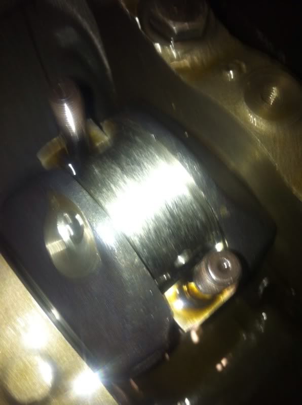

Engine/Car: R32 GTR 1993
Type of failure: Spun 3+4 bearing
Factors influencing the failure: oil pump had a crack going through the gear (hasnt been opened yet but i assume the gears will fall into afew pieces), uphill revving to 9000rpm in 2nd then 3rd gear pushed all oil away from pickup. started to hear a huge knocking in the motor. drove it home at low revs with no knocking sound.

General comments: glad that it happened so i can now see whats inside, basically a stock motor with a excellent condition head. will now be getting the works. tomei pump, forged rods forged pistons, new crank, 8-9L sump with oil drain from head to sump.

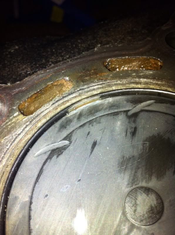

Engine/Car: R31/RB25DET
Type of failure:
Cracked piston oil glands in cylinder 2 and 4 (or maybe it was 5)
Not really sure as the car was fine when it was running the stock turbo at 11 psi.
Once I upgraded the turbo to a Hypergear G3 it lasted a month. 18psi was probably major factor as well as not really knowing the history of the engine.

It let go when I was at the drags, I wasn't going to hard on it cos I was still monitoring it and making sure everything was ok.
blow by was a massive issue once I fitted that turbo. Though it was still drivable it was burning oil because of low comp in #2.
