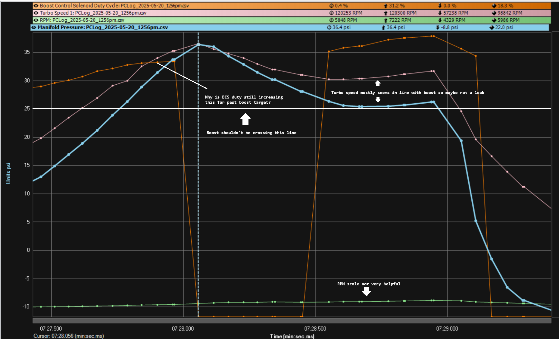

Some good discussion in here, for the most part I can't really add too much to it - thought I'd add some notes to the datalog screen shot that probably aren't news to anyone but a good prop... this is assuming 25psi-ish should be the boost ceiling given the first post refers to 23psi.
To state the obvious, this issue seems super weird.  Turbo speed seems pretty lethagic to build, like the turbo isn't getting as much drive as it needs - and it doesn't help that wgdc keeps rising AFTER boost target then completely shuts duty at a point, which in theory should have the straight gate dump heaps past the turbo and funnily enough causes the huge drop off.  It seems like pretty blunt boost control tuning but I'd not call that the primary issue, so much as possibly not helping the situation.
I'm curious, what does a pull look like with purely mechanical boost control?  Like purely wastegate?   There are things in this log and story that make it sound like there could be a significant restriction in the intercooler piping or something - but then it's also overshooting boost target which is NOT what you'd expect with a restriction.   I can see where people are coming from with the non-linear wastegate bypass (not that any valves are linear for this kind of thing), but it still doesn't make sense that it can't hold <20psi on a 12psi spring.
Have you, or can you try measuring pressure pre-intercooler?  Be pretty interesting to see what's happening there vs in the intake manifold - sorry if I've repeated old ground, I've kinda skimmed over but I could have missed something.

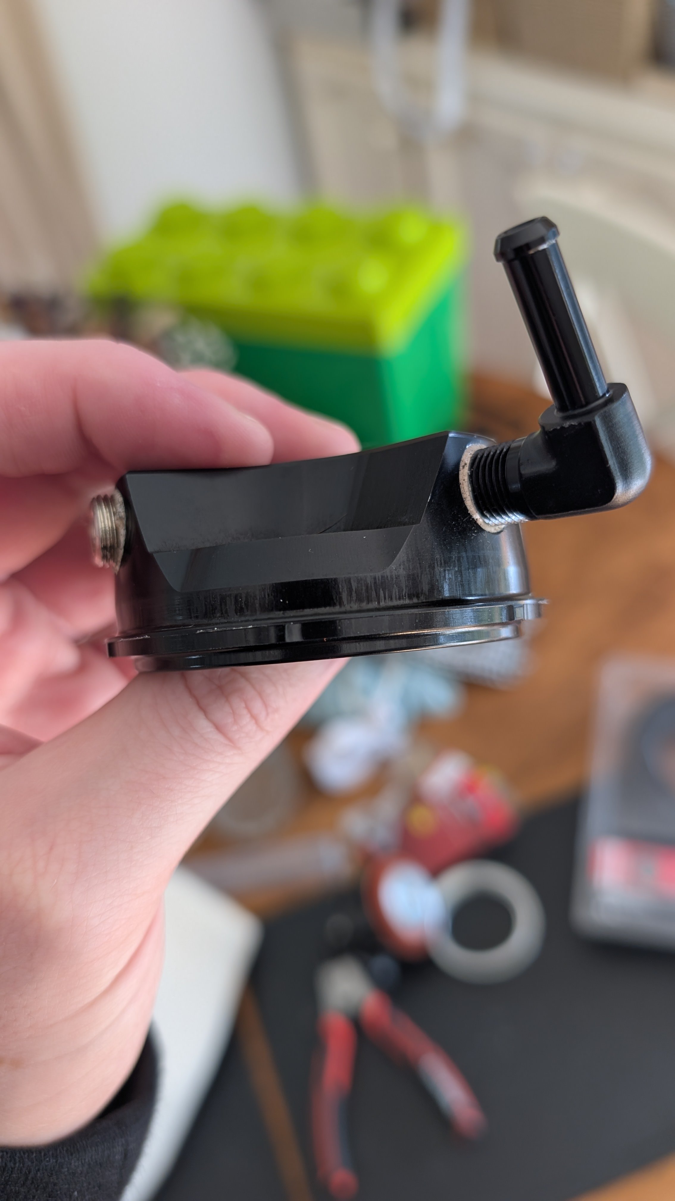

What do we think about these marks on the cap of the actuator? This is where the two parts push together where the diaphragm spring is. To me they look like air has been sleeping past?? Specifically talking about those black stains above the lower rim/lip. They can be rubbed away as if it's just an exhaust stain.

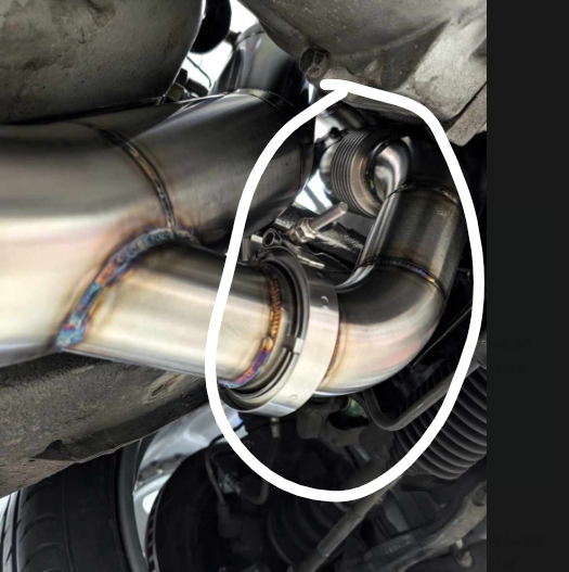

Looking at the photos, you could easily just drop this pipe and dump into atmosphere
Just 1 or 2 quick hits for data acquisition - if have a heat shield material and/or sheet metal, maybe just use wire/metal cable ties and attach it in a way to deflect heat from melting nearby wires.
So a big update for those invested in here which I think might be our smoking gun in all of this and it's not something you would pick because it shouldn't have been an issue..
I pulled the wastegate actuator/canister off the valve and went to move the actuator arm on the butterfly valve and discovered it was extremely tight, I had to put a lot of force as shown in the video to get it to open the valve. I then loosened the three bolts on top of the valve there and suddenly the valve moved freely as you would expect as you can see in the second video.
The turbosmart does not have a 'seat' for this bracket to sit nicely into and as such I assume that when you bolt it down, it can be off by a millimetre or two and cause a bind in the shaft. I spoke to Turbosmart this afternoon and they have acknowledged that they revised this design late December '24 and have asked me to send it in for diagnosis and likely replacement.
We rigged up an air compressor and tested the valve with the bolts tightened down versus loose. With them loose the actuator started to push the valve open anywhere from the 10 to 12psi (with a 12psi spring). This seems to be perfect and as you would expect.
We then tightened down the three bolts and tried again and the valve wouldn't start opening until at least 16psi.
I can only assume that due to heat cycling and different boost pressures, this is likely our fault and causes inconsistencies between runs and how the wastegate and mac valve are fighting to control boost.
