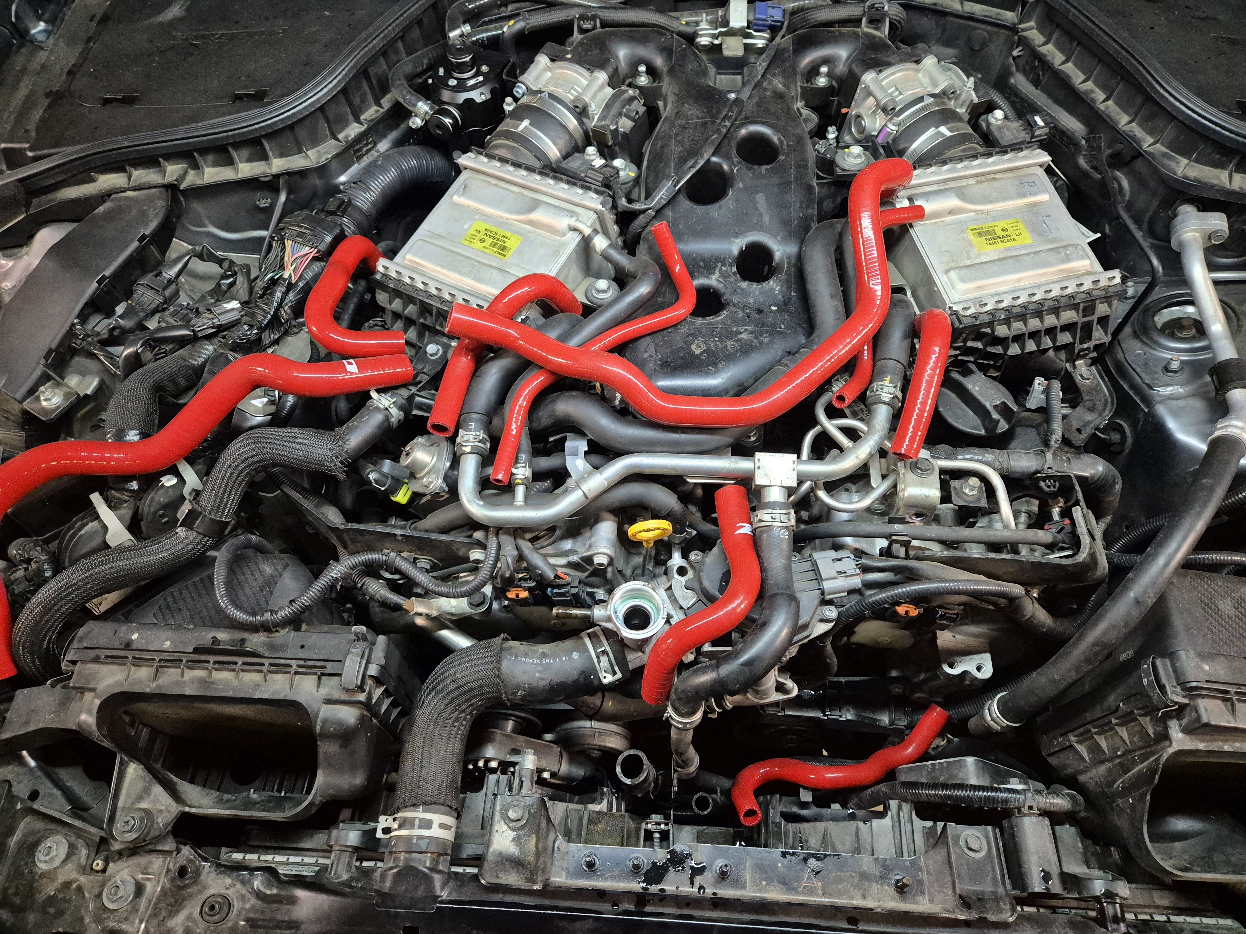

Turns out the intercooler and engine coolant hose kits are anything but complete....I probably should have counted better but it only really covers about half the coolant hoses in the car, it really just covers the visible stuff and pretends everything else doesn't exist (turbo water feed and returns and also heat exchanger lines through the 2 pumps and cooler)
.In any case, I'm happier to have half reliable hoses than none, but a bit of a disappointment.
Anyway...finger click (and 5 hours).....hoses in place, lots of spring clamps replaced with screw clamps, and engine coolant is on the pressure tester for the night.

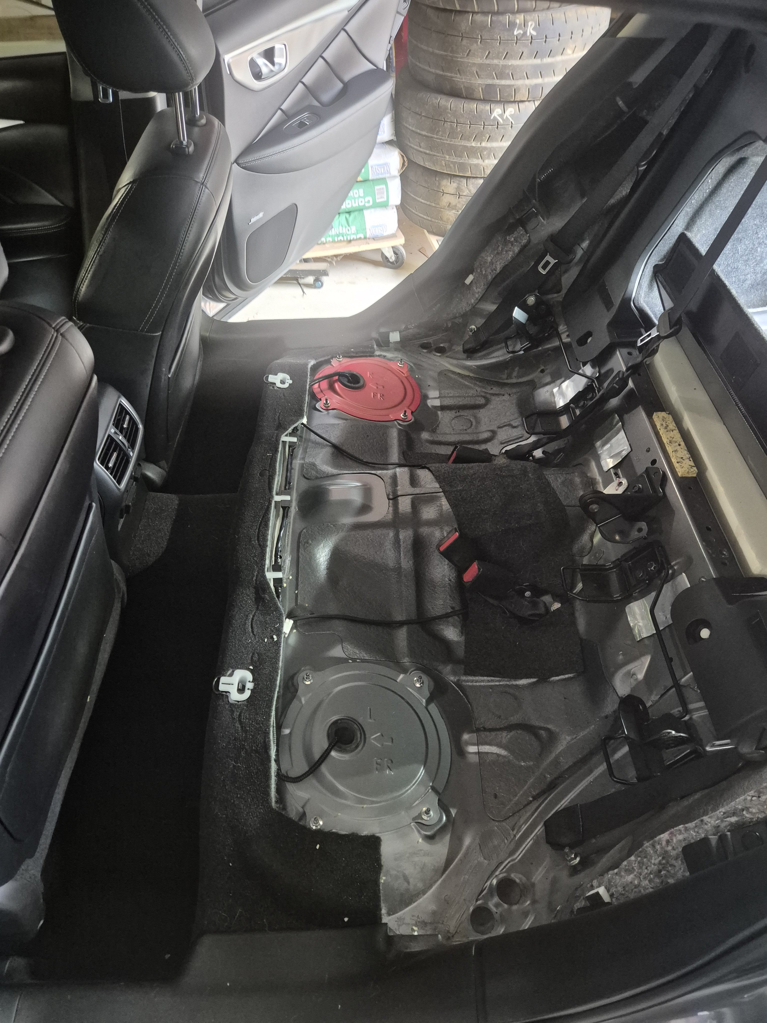

Couple of things to mention; since I am just driving the car and not taking a support vehicle, I took the rear seats out and just loaded the back up Team Trackday style.
Look at all that space!

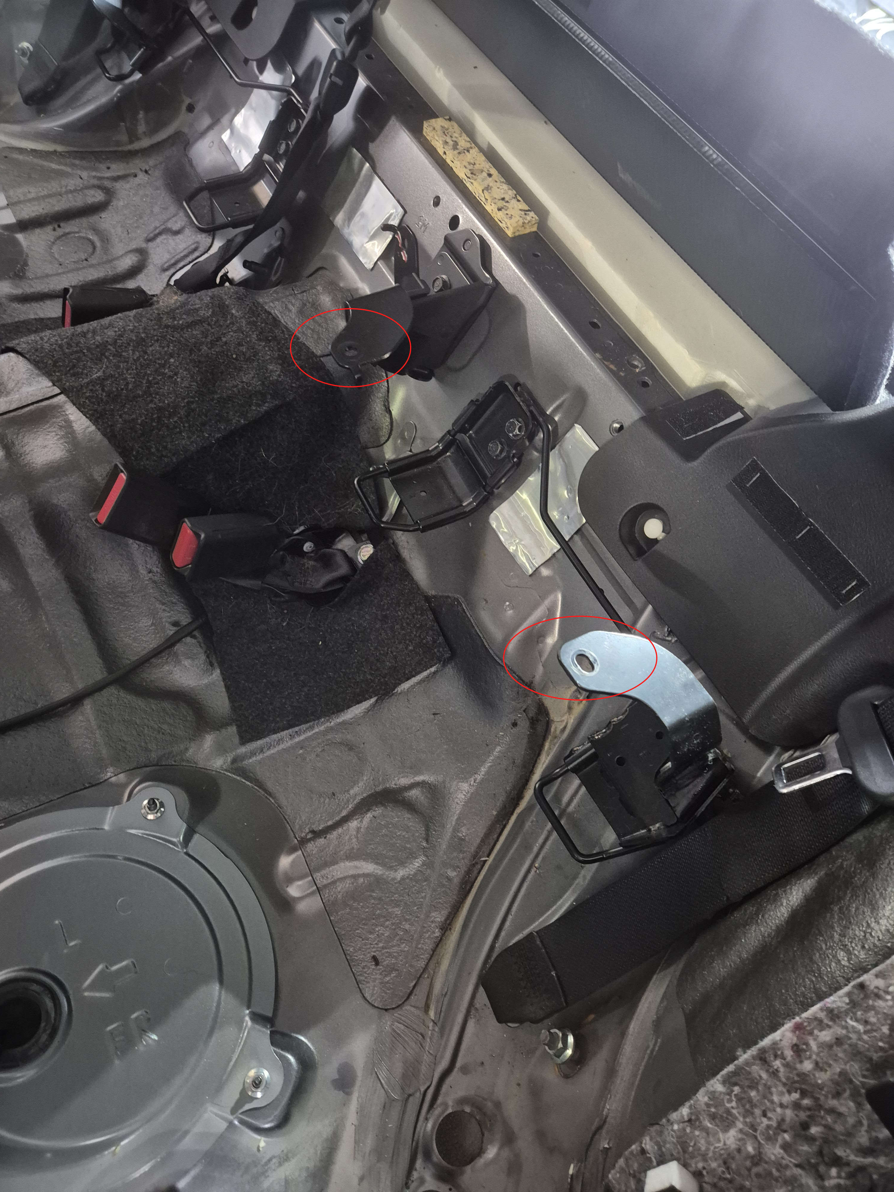

To cover off removing the rear seat....it is weird (note the hybrid is probably different because it wouldn't have folding rear seats)
Basically, you remove the lower seat base, very similar to a r series but it is a clip that pulls forward to release the base rather than it being bolted down. Easy
Then, you need to remove the side section of the rear seat on each side. There is a 14mm head nut at the bottom of the side piece, the it slides upwards off a hook at the top to release; you also need to unhook the seatbelt from the loop at the top.

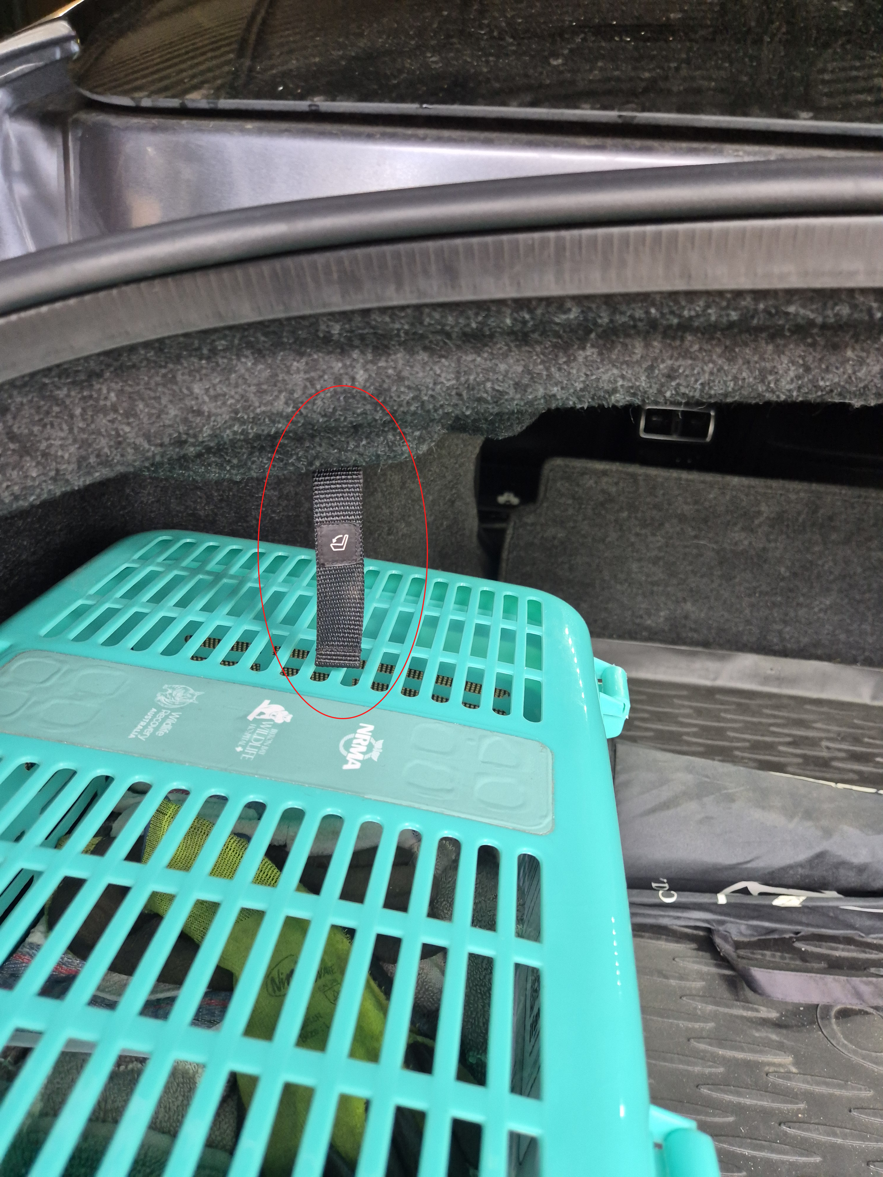

Then the centre piece is weird. You need to release/fold the seats forward with the tab in the boot on each side
From there, there are 2,x12mm headed bolts holding the rear of each seat to the folding bracket, under the trim between the rear seat and the boot (4x christmas tree clips there, they suck). The seat is out but you can see where the bolts attach to the bracket

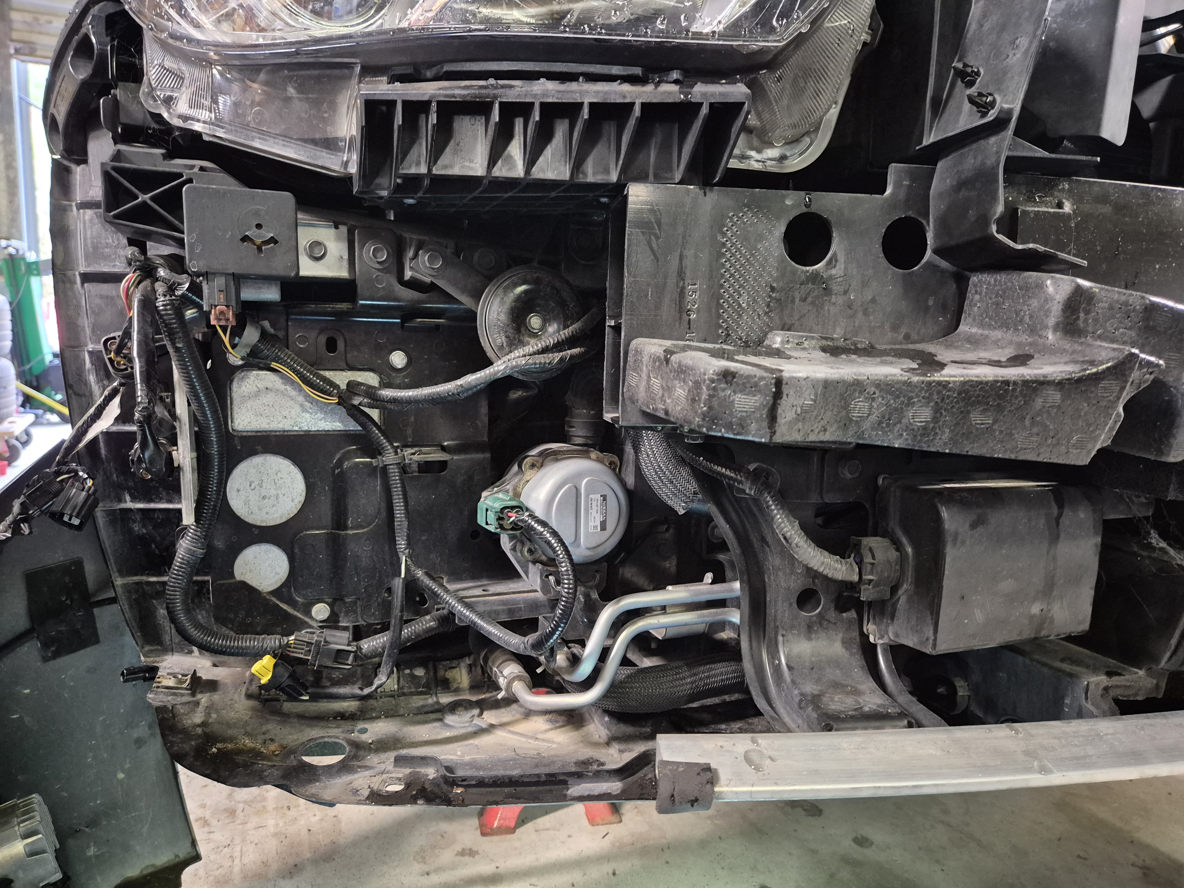

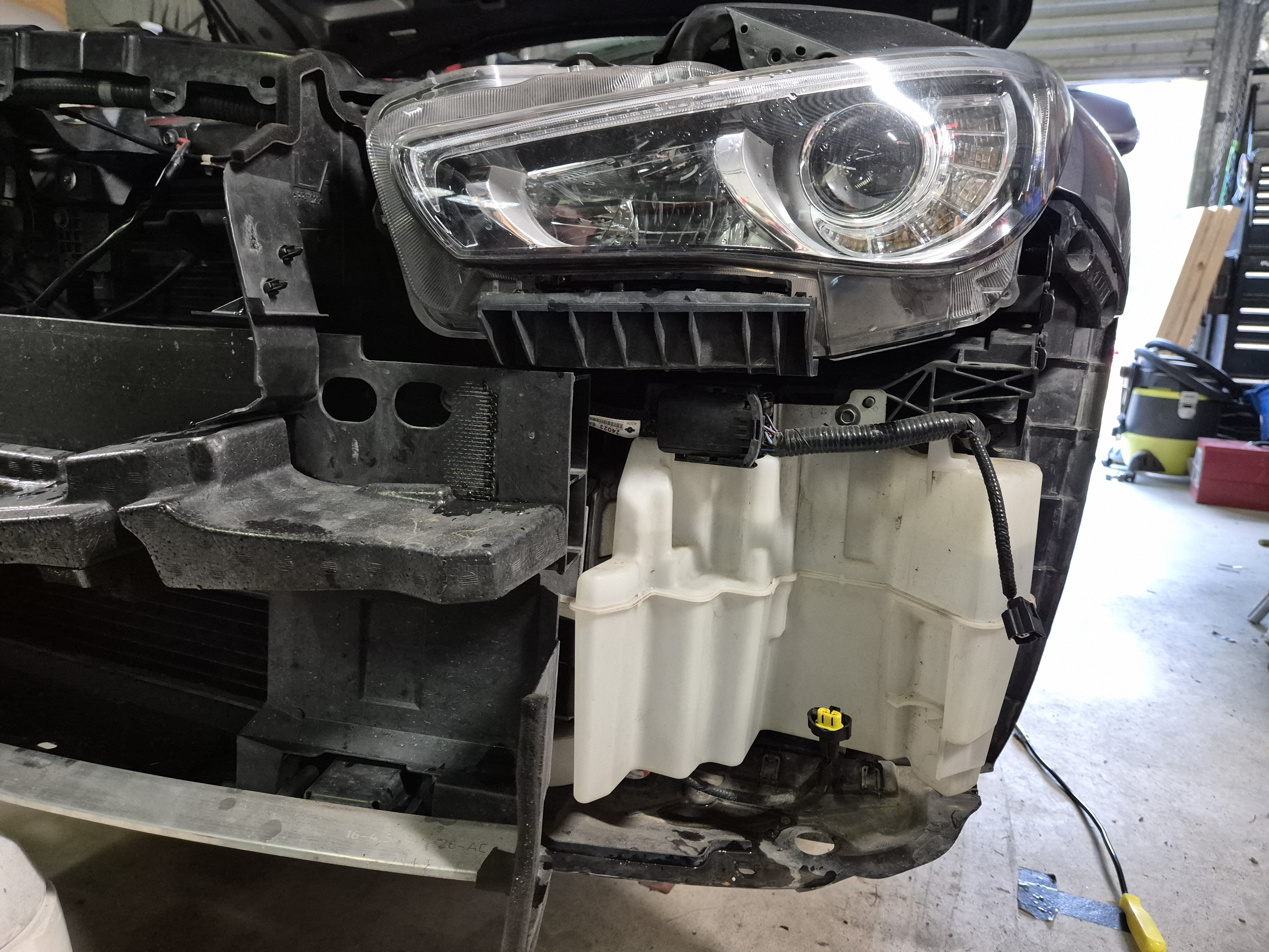

To follow up a question from earlier too since I had the front bar off again (fking!)
This is what is between the bumper and the drivers side wheel
And this is the navigator side, only one thing but its a biggy!
So basically....no putting coolers in the wheel arches without a lot of moving other stuff. Assuming I move to properly race prepping this car I'll take that job on and see how the computers respond to removing a whole bunch of ADAS modules

I checked the modules in front of the DS wheel where an oil cooler should go....
There is the radar unit - that can go for race use)
One of the 2 HX water pumps, the silver cylinder. That needs to be kept but might be able to be relocated
But the bad news, the big computer mounted vertically in front of the wheel (blocking any potential air exit) is the electric steering computer. That is required until/unless i do a hydraulic steering conversion, and in CAD based modern car design it is not like I can just pop a big unit like that somewhere else (plus the loom would be too short anywhere else too).
So, the passenger side is OK to clear out (just use a smaller washer reservoir, potentially elsewhere), but the DS no beuno
