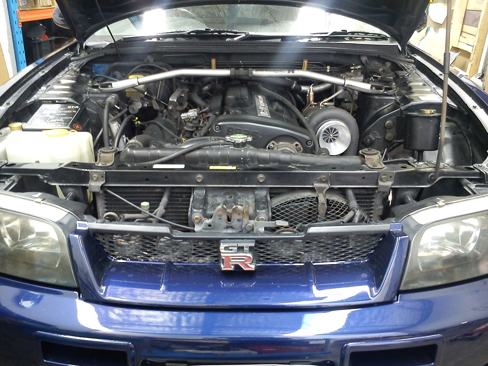

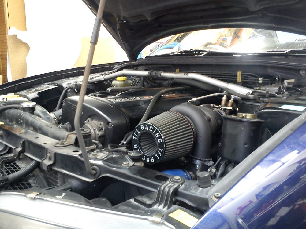

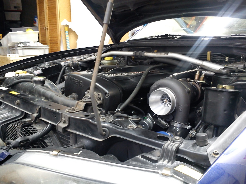

Spent some time this weekend evaluating the SS Alpha turbos on the GTR. First thing to notice is the Rb26dett engine do require an large exhaust side to run, It chocked the engine after 5000RPM using the combination of the SS2 turbine wheel in .82 housing.
it was replaced it with an large 76mm turbine that I've made for high flows, that worked pretty sweet. The engine bay was noticeably cooler also.
Looking abit more serious now :rolleyes: .
Because the effect of quart throttle, the car has an throw-out effect on throttle movement, this makes an laggy turbo feels not as obvious. The VNT system have made an noticeable torque increase down low, especially on partial throttle opening. This is a bigger turbo compare to the Sl20.5, but definitely feels more responsive to drive. Be interested to see what the dyno says in about a week, I'm currently waiting for some coil packs to turn up from Japan.
