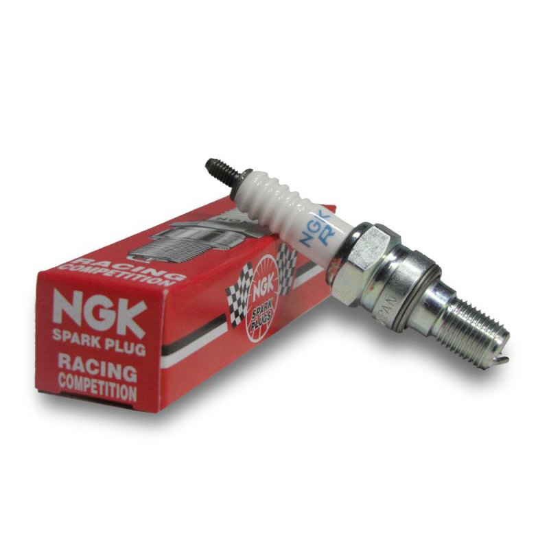

My other spark plugs, below:
I can run 18.5 psi on them, which is what I've run on the Dyno. I wanted to try and run 20 on the dyno but the car was not happy (breaking down, misfires)
I got around the problem in the past by adding more timing... but that ended up quite poorly...
So I thought I'd try the ever faithful BCPR7ES, with the aim of running over 20psi!.... but this resulted in no fun times over 12psi.

The car makes about 360 (?) KW or so at the moment, running 18psi with the plugs pictured above.

I had almost the same issue. I thought swapping to the trusty bcpr7es will fix but no. My car prefers the expensive iridium. .. (don't ask me why.i did a lot of back to back testing. look for 1 of my post) :/ but the plan in the future is to get splitfires and retry the copper plugs... im thinking tired coil packs. .btw I don't suffer misfire using iridium though just wondering why using coppers i misfire that's all. .
Given how the iridiums look, it seems they would be better at not being blown out, but I wouldn't think spark blowout is a thing with such a well known sparkplug and well known/'standard' power, and 18psi is not exactly extreme.
