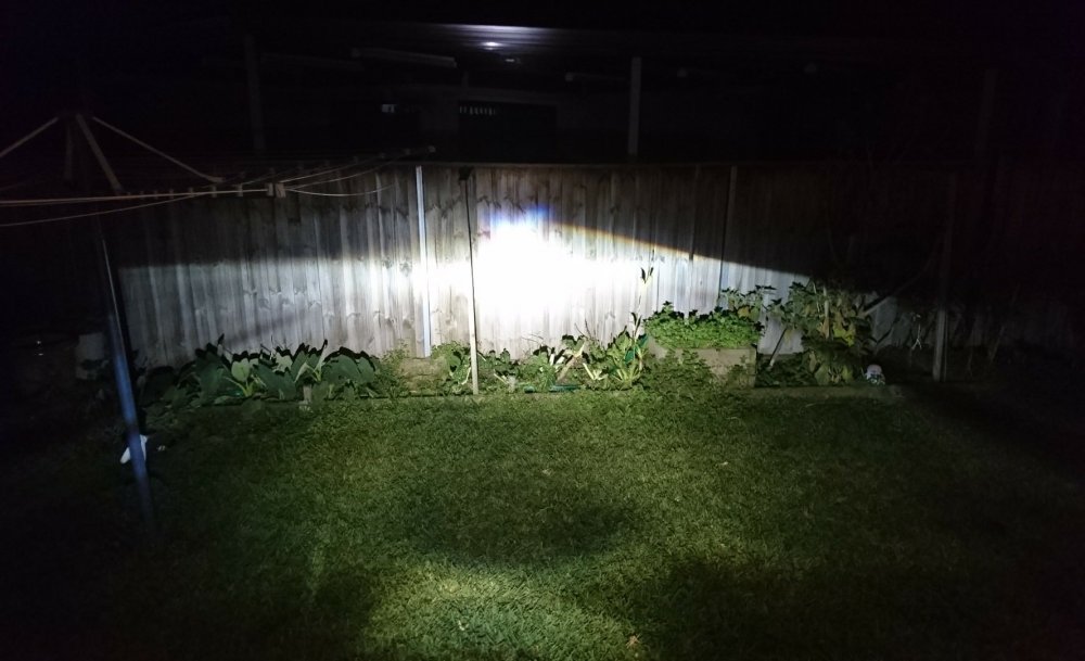

From your second picture, seems like your passenger (left) side needs to go down, and your driver side (right) needs to move to the left.
But you really need to find a level ground with a wall.

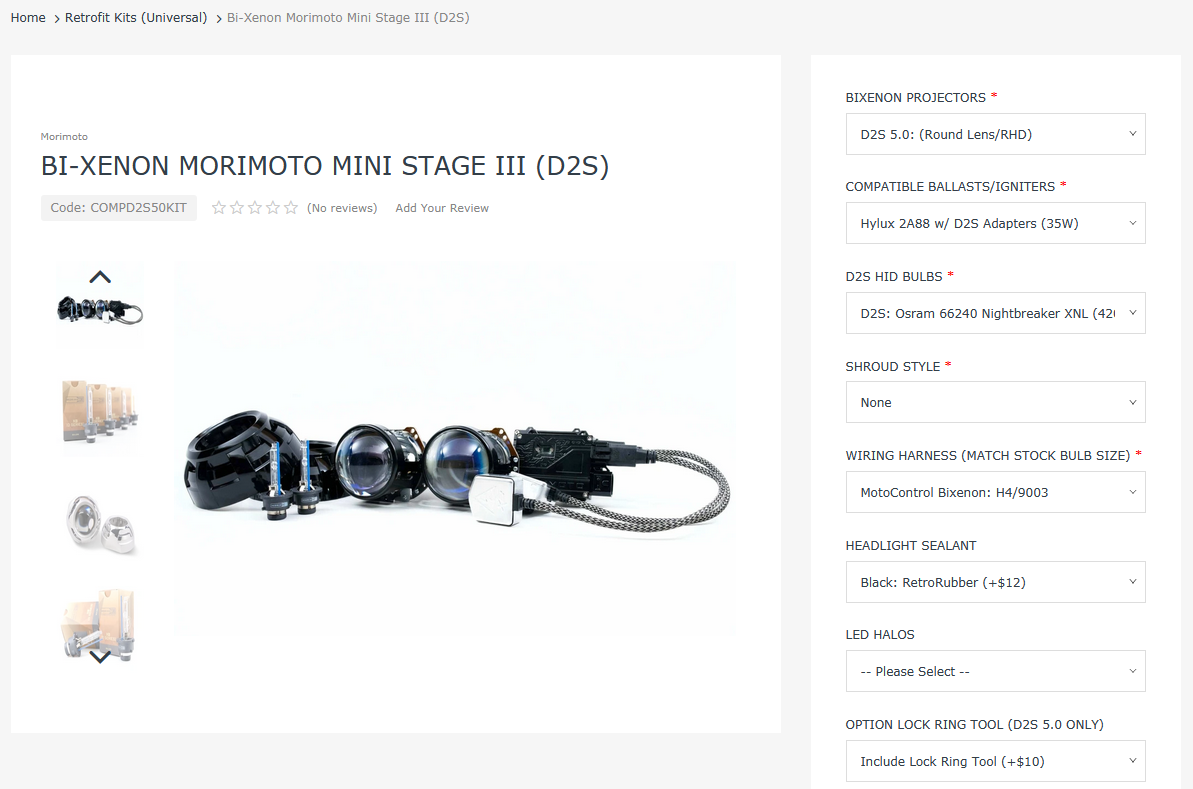

So, I have a set of projector headlights that I intend on retrofitting and then performing a transplant for the N1s.
I have read through a lot of posts about HID conversions and some date back a few years. Is the best option the latest Mini D2S and stick to 35w / 4200k? I.e. no point in going above 35w and I am not interested in bright white / blue headlights.
Looking at Lightwerkz, it seems like you can buy the brackets as mentioned above:
https://lightwerkz.net/collections/retrofit-brackets/products/nissan-r32-to-d2s-brackets
Then build your own kit:
https://lightwerkz.net/collections/universal-kits/products/bi-xenon-morimoto-mini-stage-iii-d2s-1

Not sure why Lightwerkz didn't list it anymore, but they used to let you select D2S or G5 projector to go with their R32 bracket.  G5 is cheaper and has identical dimensions to D2S, except the housing isn't painted black.  D2S has a more centralized hot spot and G5 is more spread out, you can check it out on their comparison videos.
https://www.youtube.com/c/LightwerkzGlobal/search?query=g5
Thanks @TXSquirrel I will check it out.
BTW, it does mention G5 at the bottom of the page:
2x Nissan R32 to D2S 4.0 / G5 Conversion Brackets
