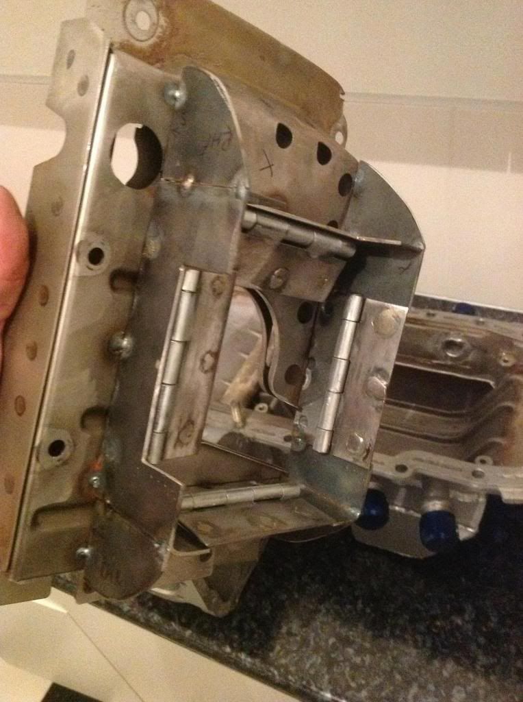

less thinking more doing shit that works
in the getto
Dash ten on pasengers side
Two dash 12 on the drivers side, angles and spaced so as not to hit shit and be able to tighten the f**ker up
note that they are above the windage/baffel
Baffled and shit
door hinges from bunnings
image_zps52ed1d07.jpg[/url
dash 20 atmo vent (strait to the ground so people behind me can EADC)
getto as f**k but works a treat
