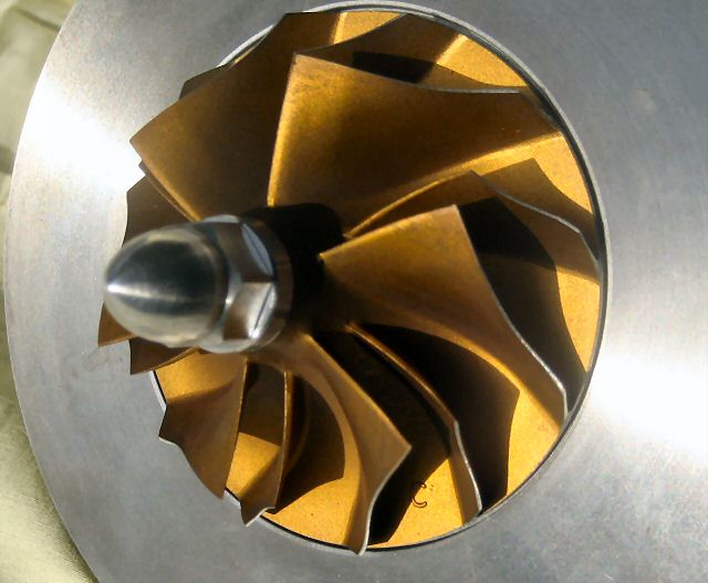

Roy: the billet wheel looks interseting,
how much did your one set you back? i wouldn't mind upgrading to a billet wheel if it is proven to give gains and worth the $$ spent.

So I am trying the FP Green 73HTA compressor on my TD06L2 turbine and 8cm housing. Who is going to give their TD06L2 to ATP in Melbourne for one of their billet wheel upgrades?
I am waiting for a reply to my email at the moment. Real keen to see which of all these turbos makes the numbers or whether all their claims are hype.

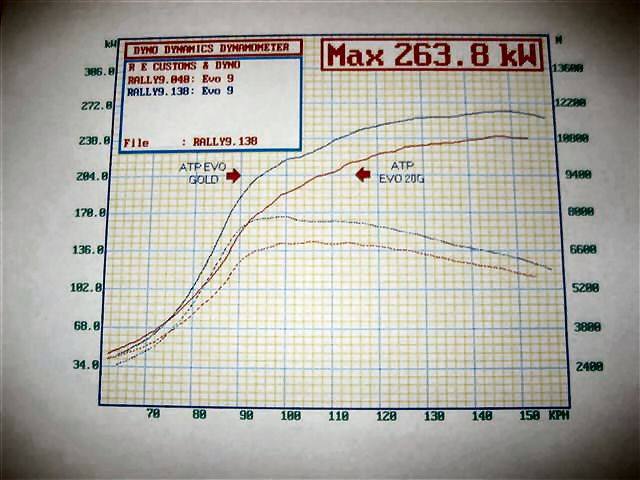

Here is the claimed difference between their billet 20G wheel replacement (anodised Gold) and the std 20G compressor.
The above is on an EVO so you could almost add 30-40rwkws for an indication of what it would make on a Skyline
The claim that they also make 30kws more then the FB Green compressor which is a little alarming since that is what I have :( The wheel looks as close to identical to the BBK billet compressors only gold vs blue.
